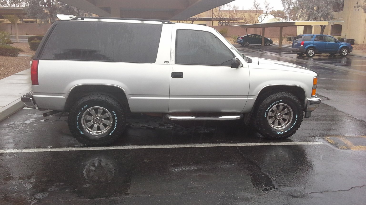

well I’ve decided not to lift the truck after all even tho the idead has grown on me after seeing some tahoes with a 4’” lift. my plans are to completely rebuild the suspension including shocks along with a energy suspension master kit. I am going to replace the rear leaf springs, I like the idea of adding the helper spring to the spring pack. This vehicle has been hammered hard in the past which is why I want to replace everything. Below is a picture of how the vehicle currently sits. The rims on there now is what came with the truck.
