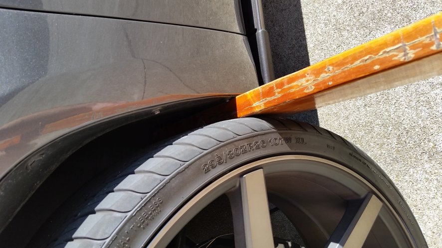

Here just have it about 5 inches longer than edge of fenderwell snd guide it while someone turns tire

Awesome thanks. Never damaged a fender that way? I was timid when I tried

No I run it 2 inches longer and it will pull it inside the fender and be cool
