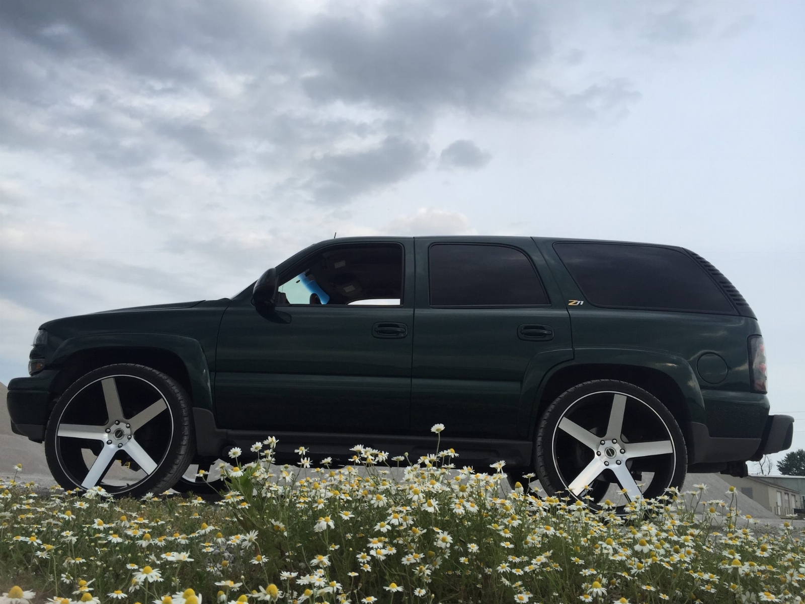

i have a 04 tahoe, 2" drop in back, and let the torsion bars down just a hair.
I like how the 20s i have fill the front, not so much the back,
local guy has some 26". very similar to Rocket Mans summer wheels.
How much rubbing would i get without modification?

26 x 10's? 26 x 9's? What's the offset of the rims, what size tires?
Just put them on and find out... too hard for us to guess.

Not sure width or offset, haven't gone to see yet. Thought diameter alone might indicate

nope. you could do a 295/30/26 and not rub at all or a 305/35/26 and rub like hell.
same with offset. a +31 would be ok where a +28 would rub bad.

My 02 z71 is lowered a few inches and I run 305/30/26 and have no rub. But if I were to do it again I would go with 295/30/26..
My wheels are 26x10 +25 offset. My wheels are forsale. $1500 pick up in Michigan. They like mint

I checked out a set of 26" gmc reps.
I think its too much.
Ill probably start looking at 24 max
