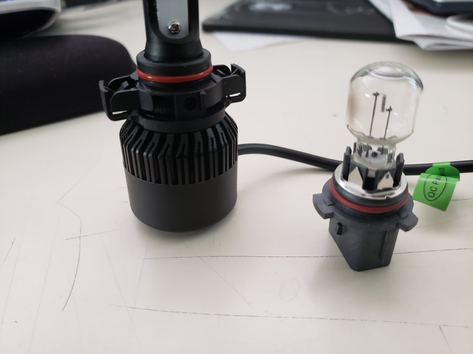

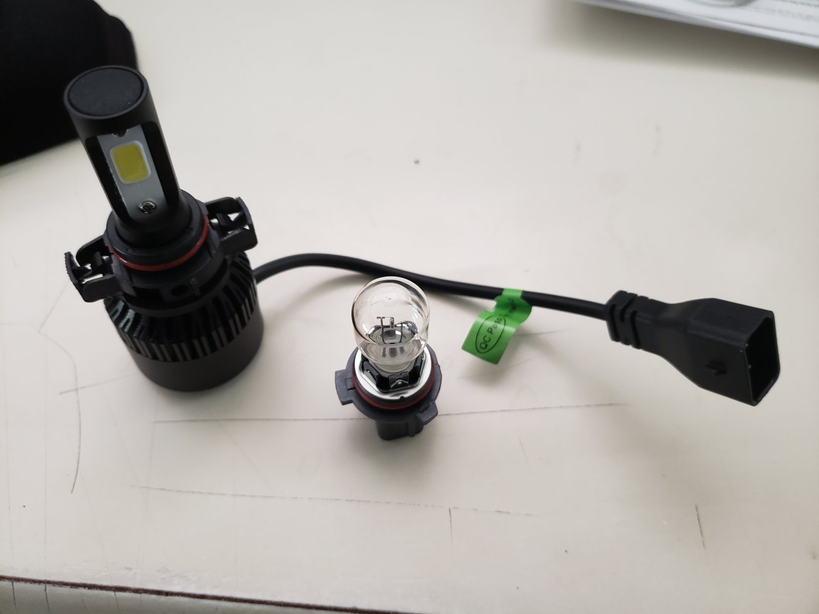

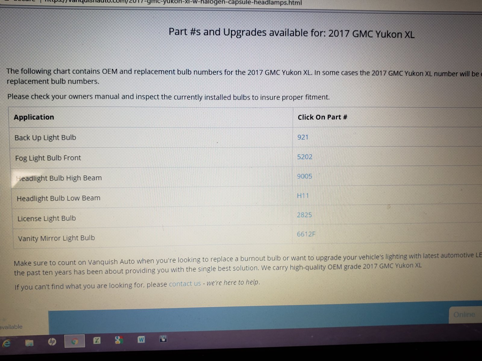

I really feel dumb, am I missing something here on how the Halogen bulbs take a LED replacement???
Everything posted says 5202, but the factory Halogen bulb has no 5202 markings on it and they both have completely different mounting positions???
Attached is the photo of my factory Halogen Fog light from my 2017 GMC Yukon XL SLT, and next to it is the LED replacement lights I ordered to swap them out, and the LED light does not lock into the fog light housing at all???
Am I doing something wrong here...feeling kind of stupid at the moment...any help, tips, or guidance would be much appreciated!
Thanks Guys!

Thanks for replying...honestly still baffled as everything says use 5202 and that is what I got, but they are totally different. Been doing the Youtube search for installation etc...Nothing shows the actual LED light that is being installed, or how it locks into the fog light housing, only for the early trucks up to 2014.
Totally strange, and there seems to be so many here that have LED fogs

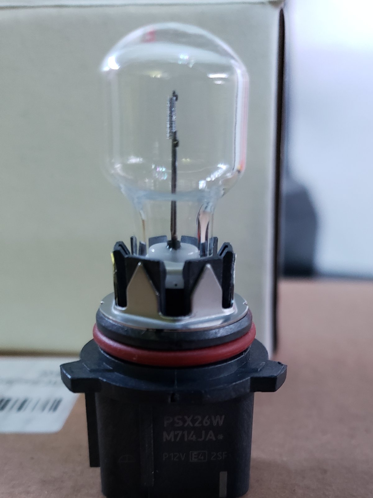

Are you sure there's no writing on the sides of the factory bulb (black part of the bulb)? That's where mine said the bulb size.I attached my bulb
So that bulb there looks identical to my OE bulb that I took the picture of with the LED replacement that I received and your and mine look like the same bulb, but how in the heck does that replacement LED go into the fog light housing??? I rotated and pushed etc?? Like I said, feeling a bit dumb at the moment!

Figured out, the bulb is a PSX26w, this is not the same as a 5202, there is a PSX26 LED bulb that has the configuration with the fan, but it uses a rotating locking position to the housing, not the snap style. Everywhere out there it says use 5202, but that is not at all the correct one for this model year application.
Going to order the PSX26 ones and will update when complete.

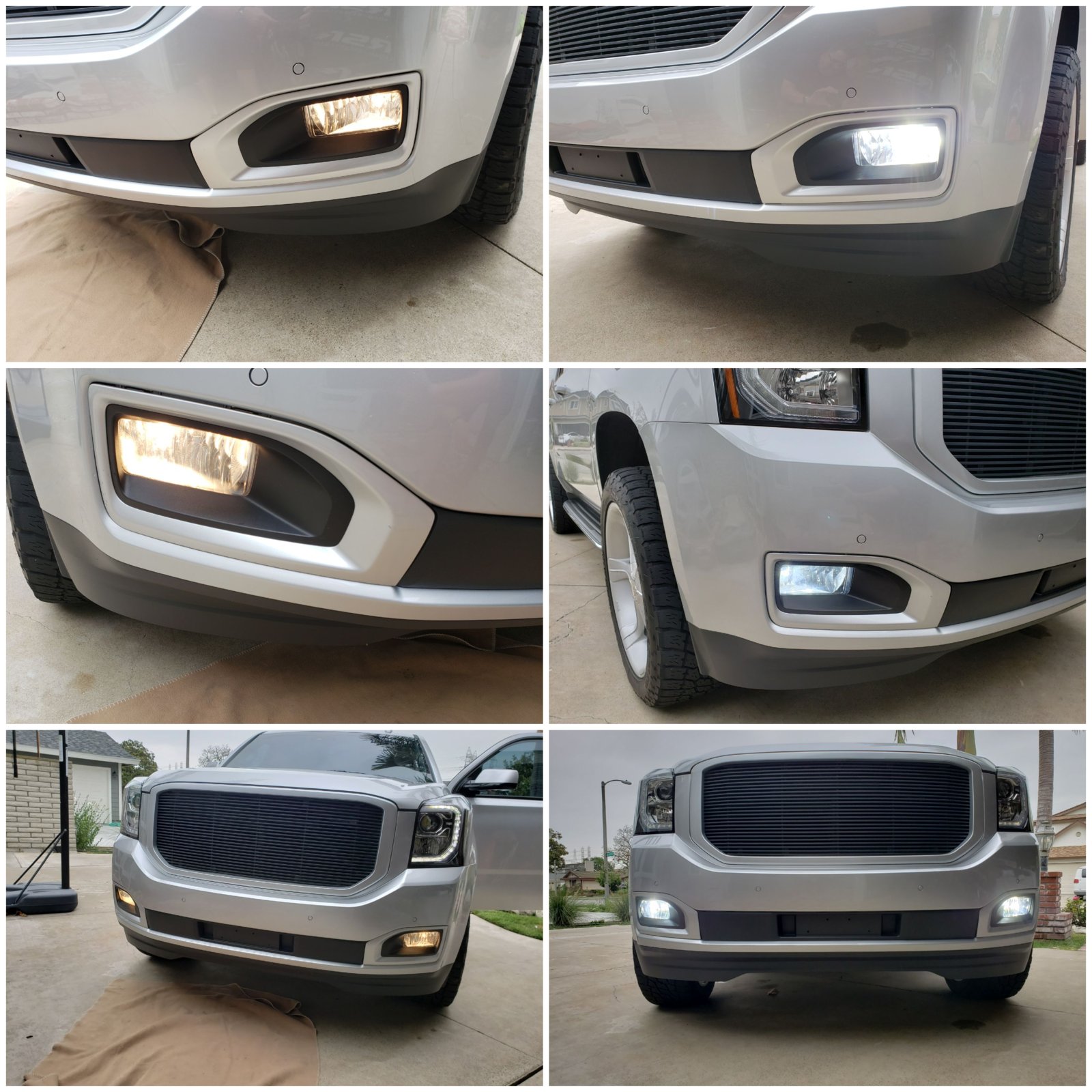

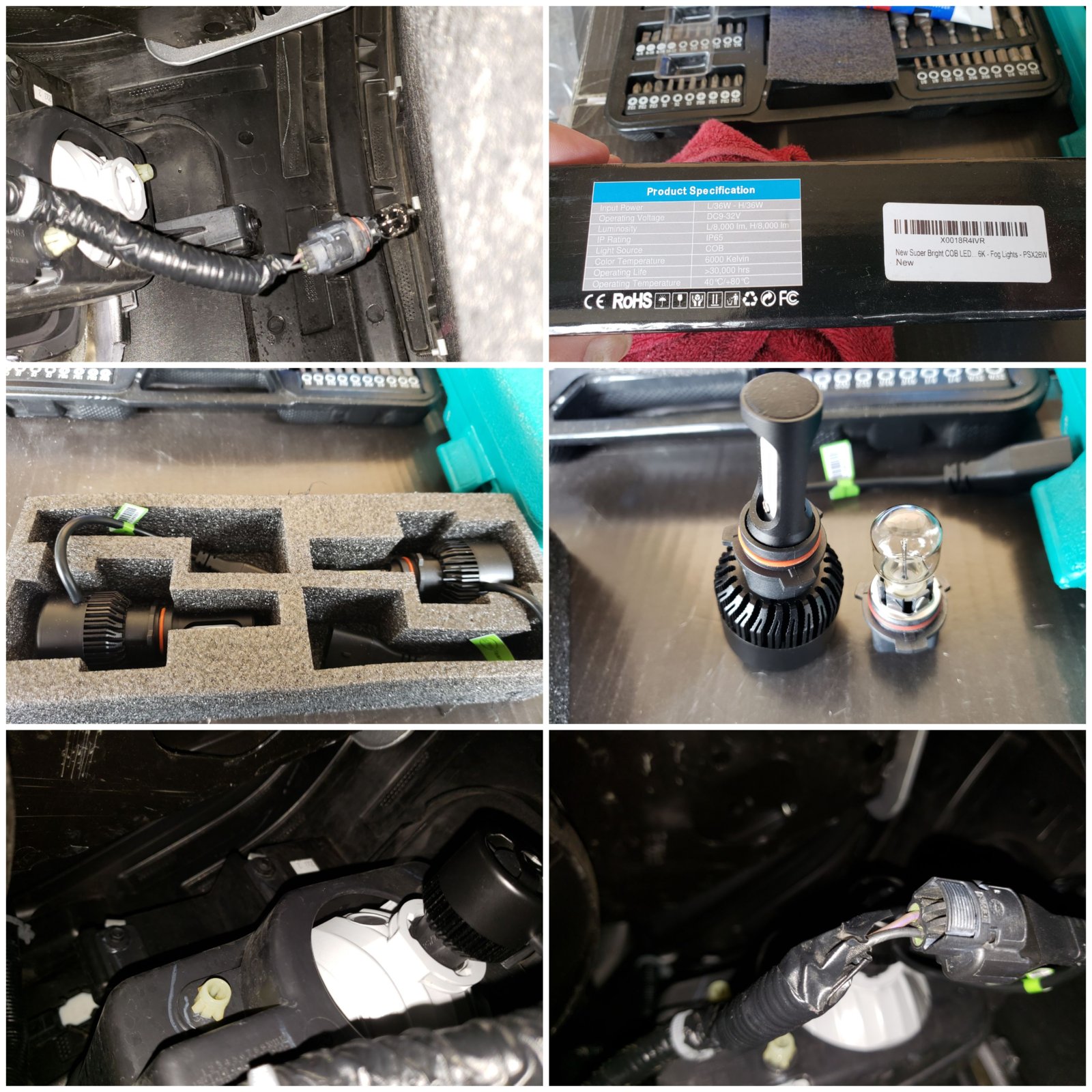

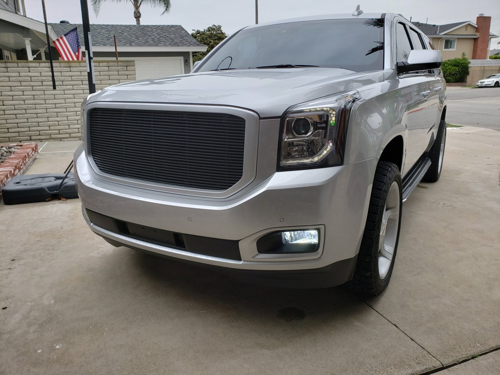

Quick update; received in the PSX26 LED fog lights and they fit perfect! Took some pics, hopefully this is useful for any of the other members, it was baffling for me that most of the research for the model all said the light was a 5202, so not sure if earlier models took this and they changed in 17? My truck was a late 17 production, so not sure if some 17's and 18 models are different? Either way, the LED fogs are so much nicer and match the LED lighting for the headlights low and high. Thanks for the help and input tool2269!
