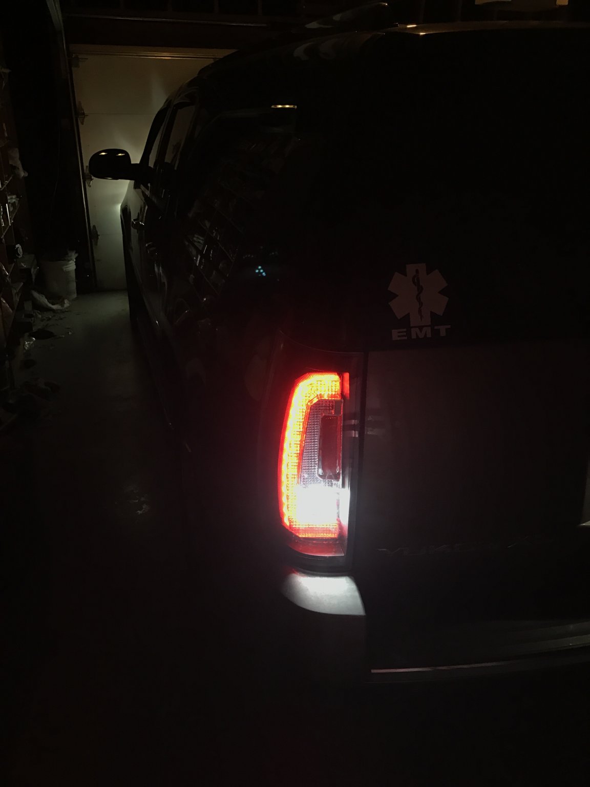

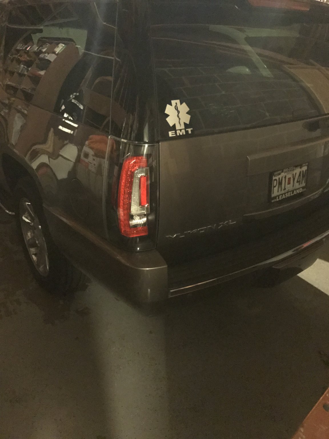

I just posted this on a different thread. These went on relatively easy and look fantastic. The only issue I had was disconnecting the original harness which is located underneath the vehicle. Additionally, you need to provide your own 3157 bulb since the OEM bulb is a different size.
Since they are of the aftermarket variety, I've seen some condensate buildup on occasion, but it dries itself out in the sun. A bead of silicone around the seals will rectify that.
