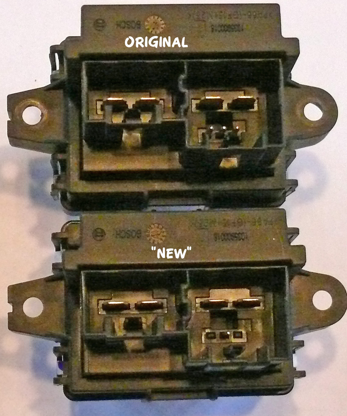

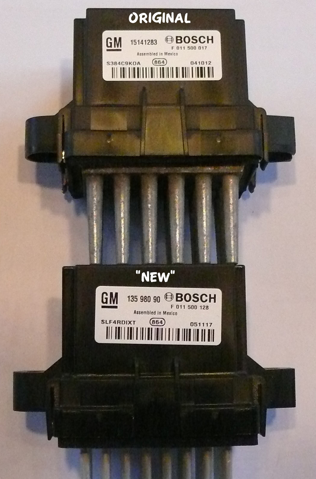

Hi.. Back but No Joy yet.. And I need your sharp eyes on these modules! Got a 'new correct'? Module at O'reilly. It does not cause the fan to blow. AND it looks a little different. See here: The "Original has 3 pins in the right connector. The "new" one has only one. Can this be correct?? The BOSCH labels are different too.. Any info/pointers,advice VERY welcome. AND should I / Can I test the motor itself?? THANKS!
and Here:
