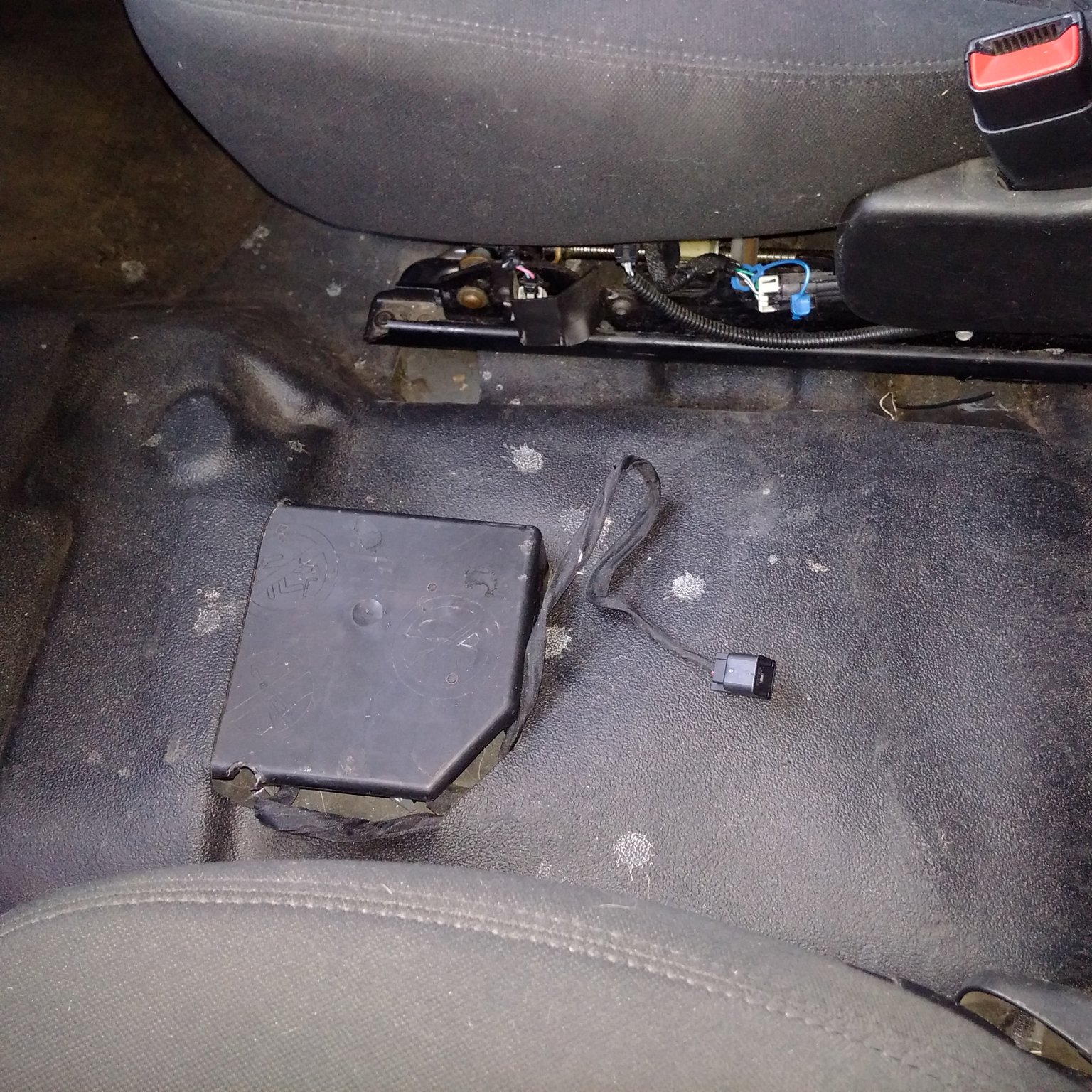

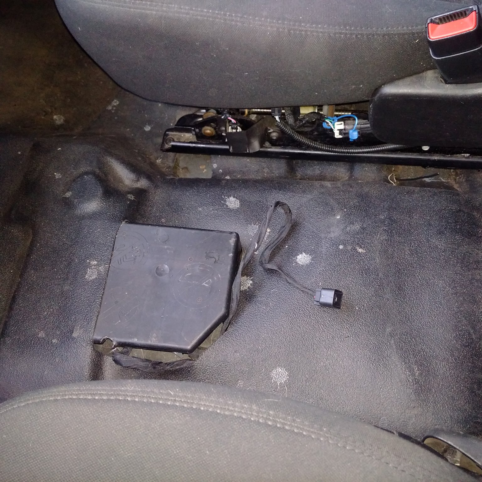

Also, in the center of the floor tucked under the rubber floor mat behind that flat plastic cover is a 12v pigtail with connector. That's from the factory and will connect to the power outlet option on the console. Don't forget to fish that out.
Well, the universe helped me find a console, but the harness that powers this console doesn't match up at all to the 12v harness under that black cover. It's one big harness that integrates the Bose amp and the rear entertainment/hvac controls as well as the two 12v outlets. 3 plugs at the forward end of the console, but none fit that 12v harness.
