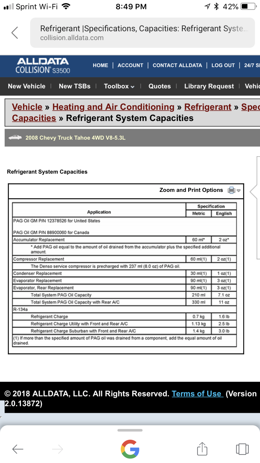

I had a major failure of my original ac compressor. Replaced condensor, orifice tube, expansion valve (rear air), rear evaporator, drier, hard line from condensor with muffler, pressure switch, high and low side valves, compressor and did a thorough flush on what was re-used in the system. 11oz of Pag through the system, deep vacuum, 2.5lbs freon and new belt.
