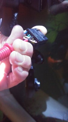

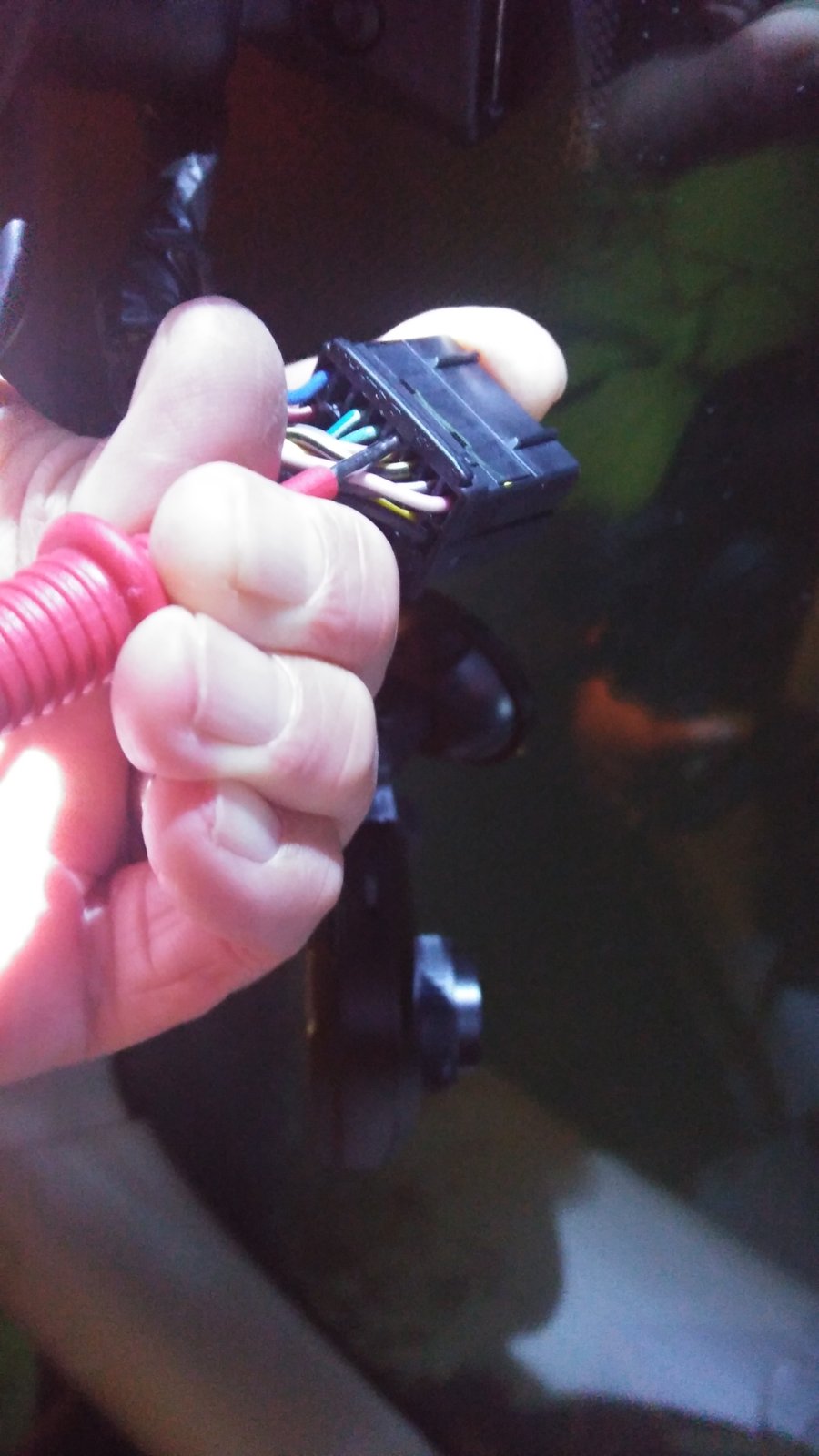

If anyone is interested I've probed and later found online the pin for 12volt on with ignition for wiring things to the rearview mirror like a radar detector.
13 - ignition voltage (12v -main power IN to the mirror)
Picture is of the pin and probe. Hard to see the color but should help you out.

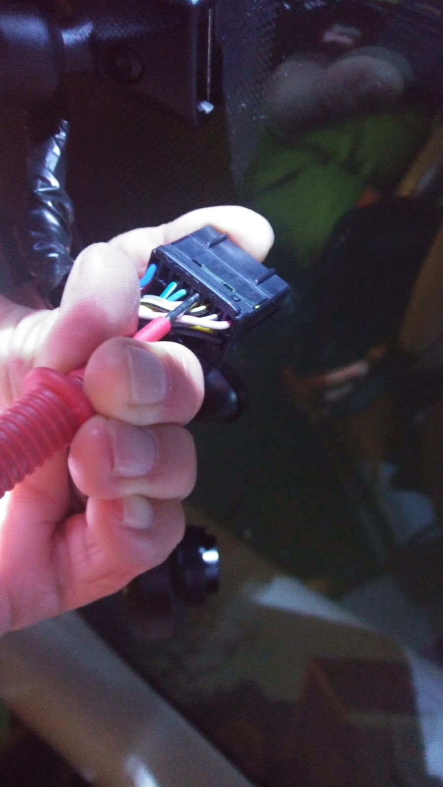

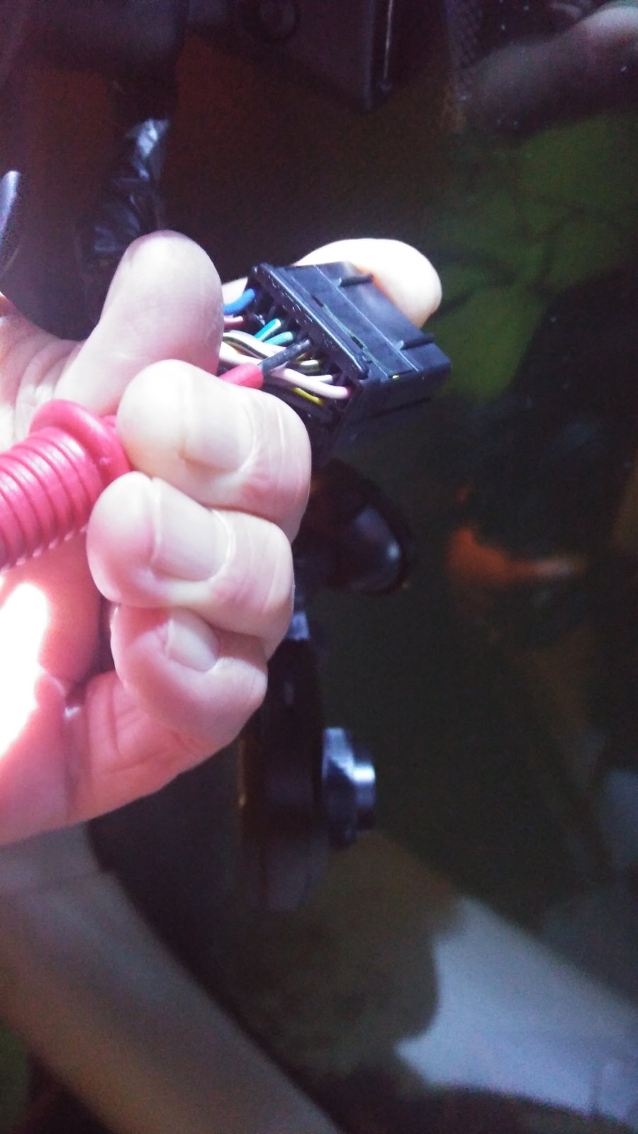

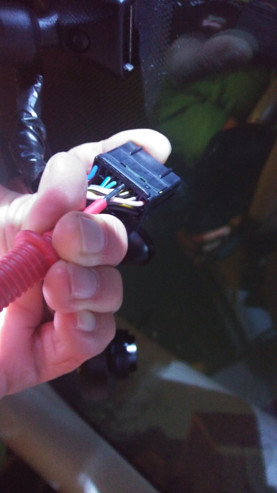

View attachment 182624 View attachment 182625
Thank you so much for this, I was going crazy trying to find the right slot. Saved me from having a nervous breakdown lol
