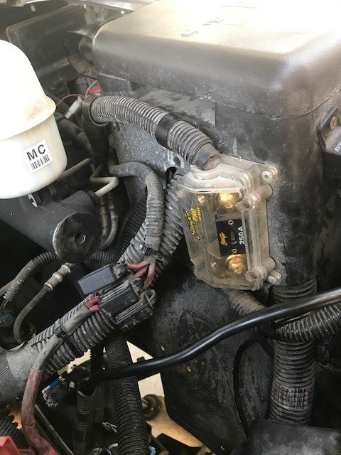

update- tried pulling those fuses, radio stayed on... (it's aftermarket with its own separate positive lead and 250A fuse... wired correctly)

By radio, i'm assuming you meant amplifier? 250A is huge! If the remote turn on wire for the amp is not wired correctly, and the amp never shuts off, it would drain the battery like that.

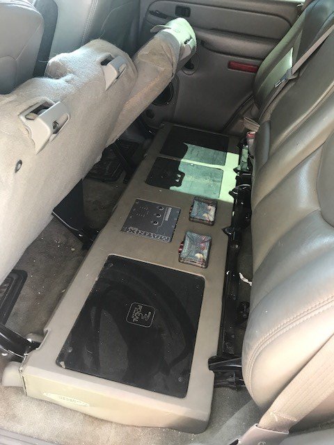

i did a further test on the alternator.... thinking that is what is bad.
disconnected the alt, hooked up the battery, and charging battery again now.
but first time i tested it in that setup, no voltage drop from battery.
the stereo/amp setup looks like it is wired better than the rest of the truck.. never had an issue with any of it, but i will check the remote turn on just in case...
3 amps, 2 crossovers, 1 equalizer, separate power and wiring, 12 speakers, but i have a little experience with car audio, and the setup looks better than i have ever seen before. (truck came with the system, i did not install it, but it looks very professional.)
leaning towards bad alternator now that i disconnected it, and truck started right up with full charge on battery, then died 4 minutes later.

yep... alternator.
battery has been charging 2 hours, reads 11.9v, alt disconnected, started right up with no drain on voltage.
all accessories came on like normal.
plan now is to pull alternator and swap out for new one, FULLY CHARGE the battery, and fingers crossed, problem solved.
dashboard battery light is still on, however............ thinking that is just computer telling me what i already know- that battery is not charging.
