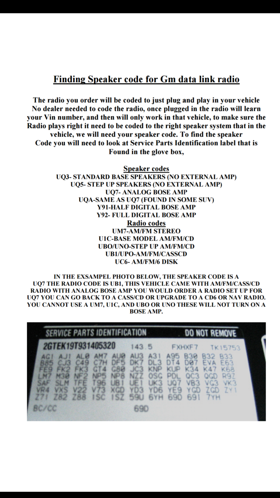

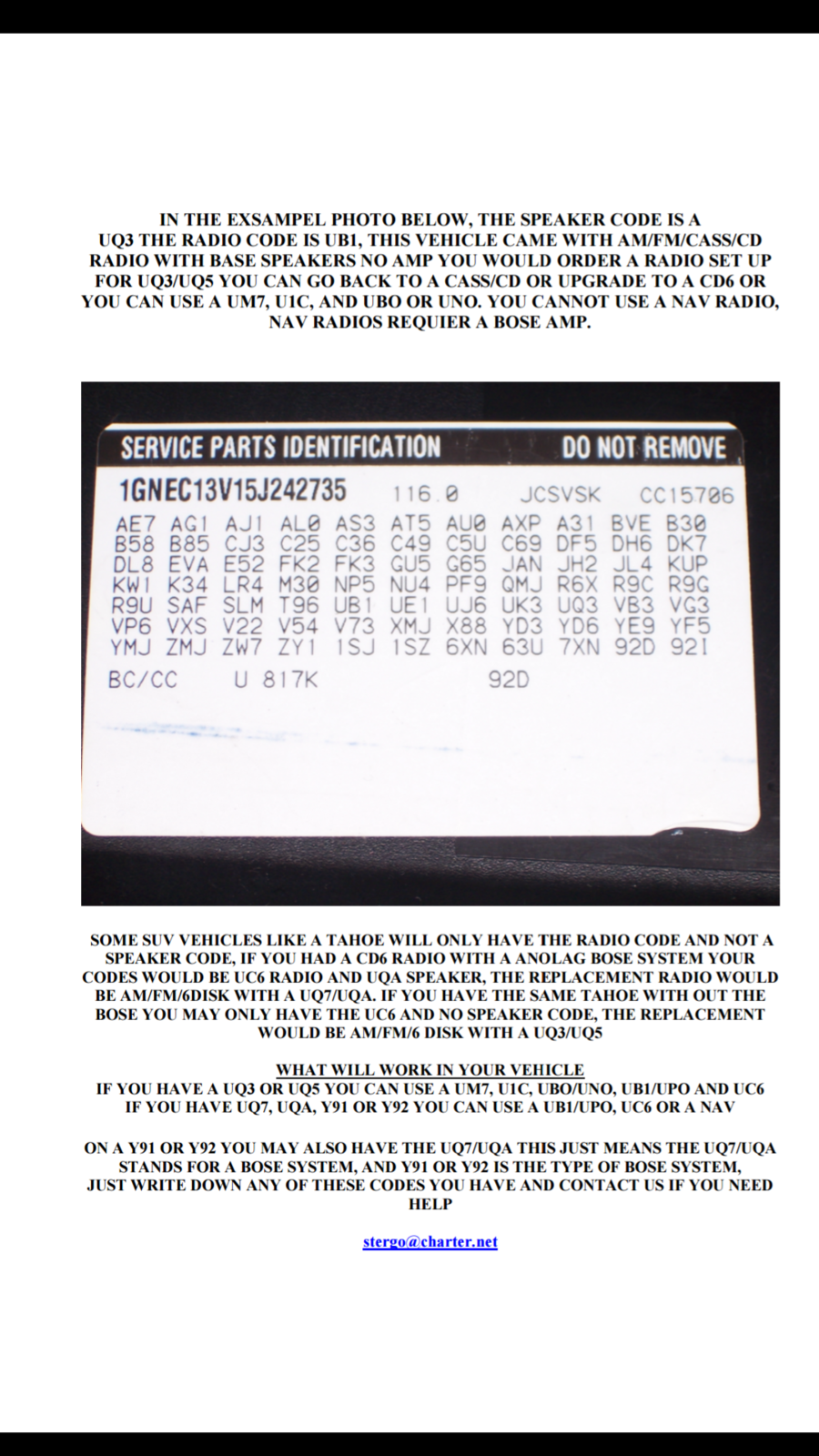

I am new here and I just bought a 2004 Tahoe LS, which has the original factory single cd/cassette tape radio, no steeringwheel controls and no ONSTAR, but has rear audio controls. It is a Bose System. I would like to replace that unit with a GM approved unit with 6-cd changer and possible aux port. Don't care about the tape part. The important part is upgrading from single cd to 6 cd changer. In my manual there are 3 units shown as options available, one is a plain radio, the next one is what I have now and the 3rd one is the radio with built in 6-cd changer. This is the one I would like to upgrade to. They all have the same footprint and were available as options at time the car was put together. I went to my local Chevy dealer to find out what the correct part number for this radio was and he said it would be impossible for him to tell me that because he plugs in my VIN and he can tell me what's in there now, but not what I would like to put in. There might be a difference in wiring etc, etc. He said the only way that he might be able to help me is if I can find an identical Tahoe to mine which has the 6-cd changer in it and get that VIN number and then he can see what is in that car and chances are it will also work in my Tahoe. And then he said after the radio has been installed it needs to be activated or coded or something like that by Chevrolet. Wow, what did ever happen to the good ol days when you could just yank the old radio out and put another one in? Can anybody shed some light on all of this and hopefully done something like this and can recommend a compatible unit that will fit right in (plug in and play) and have the part number for it. Thanks
