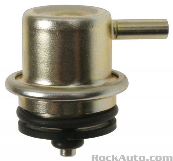

    I believe fuel pressure should be around 58 and no drop in pressure.(maybe 5lbs) we don't have a fpr on the fuel rail as it's in the tank with the pump. Sooner or later the pump will completely give out so might as well change it now and fix that evap while your down there
