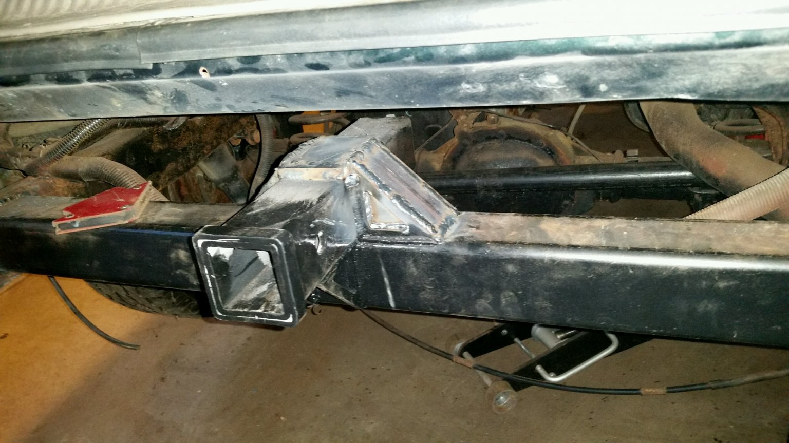

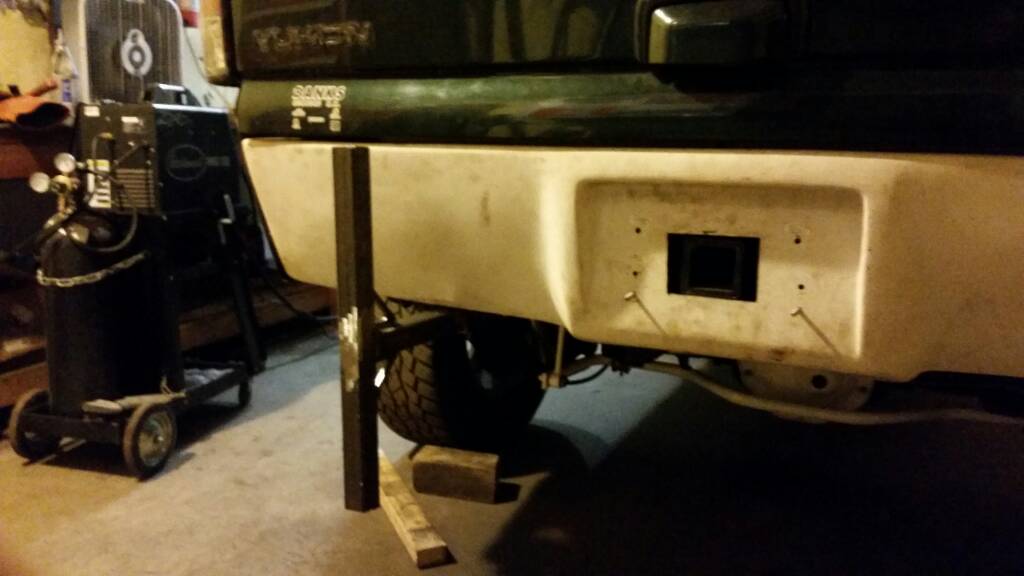

To start it obviously started as a 2003 yukon denali. It is now a 2500hd swapped denali as the denali clip went on my dmax. i refreshed the top end gaskets, rebuilt trans with a trans go full valve bod upgrade, e fans, coil overs with Qa1 all around, all poly urethane bushing/body mounts. a zone 3 inch body was stacked on top. the denali bumper was rotted inside so i went to a roll pan and custom hidden hitch. custom heim joint trailing arms similar to spohn with matching panhard bar. jk (?) cant excatly recall sway bar links. gm brake lines, new fuel lines, full interior sound deading. Magnaflow high flow cats with brola xr1. all stainless steel ptfe braided trans lines and oil cooler lines with custom adapters to stock radiator new trans cooler. mini h1 7.0 retro headlights and all morimoto led lighting. new inner outter rockers, wheel well archs and quarters. pics to come soon....
