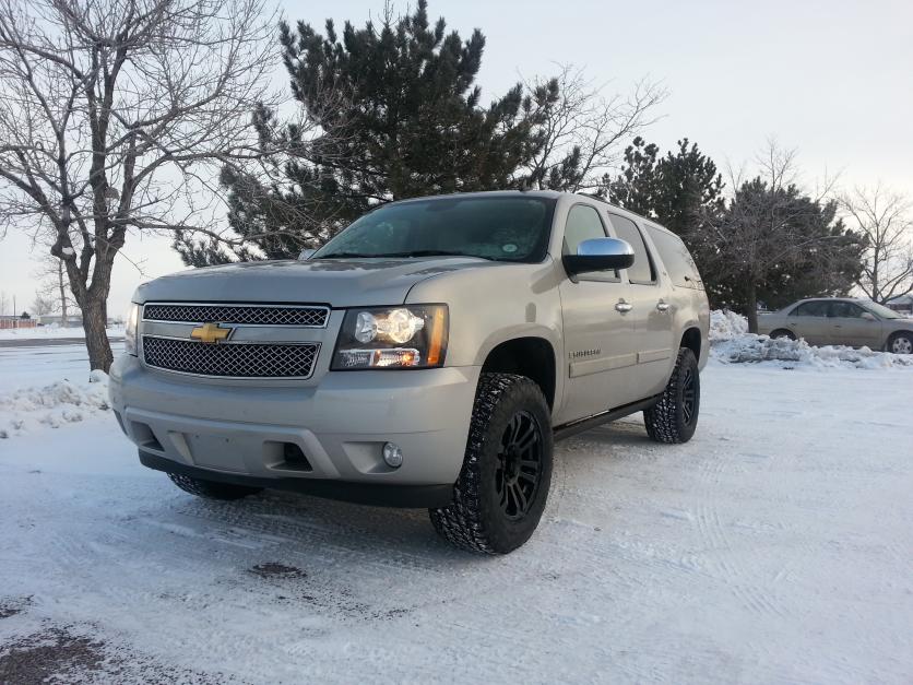

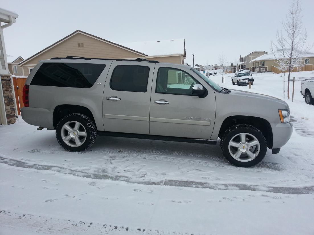

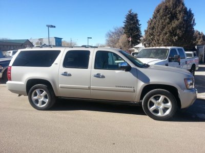

I went with the Rough County 2.5" Front leveling kit and a Pro Comp 1.5" Coil spacer for the rear. I think it sits just about perfect with that combination, just slightly higher in the rear. Both were very easy to install. I put 305/60R18 Nitto Terra Grapplers on 18x9 MB TKO wheels, offset is 25mm. Rubbing is very minimal, the tire just brushes the front inner fender at full lock. I may do a bit of trimming to eliminate any rubbing in the near future.
Pics before and after level.
