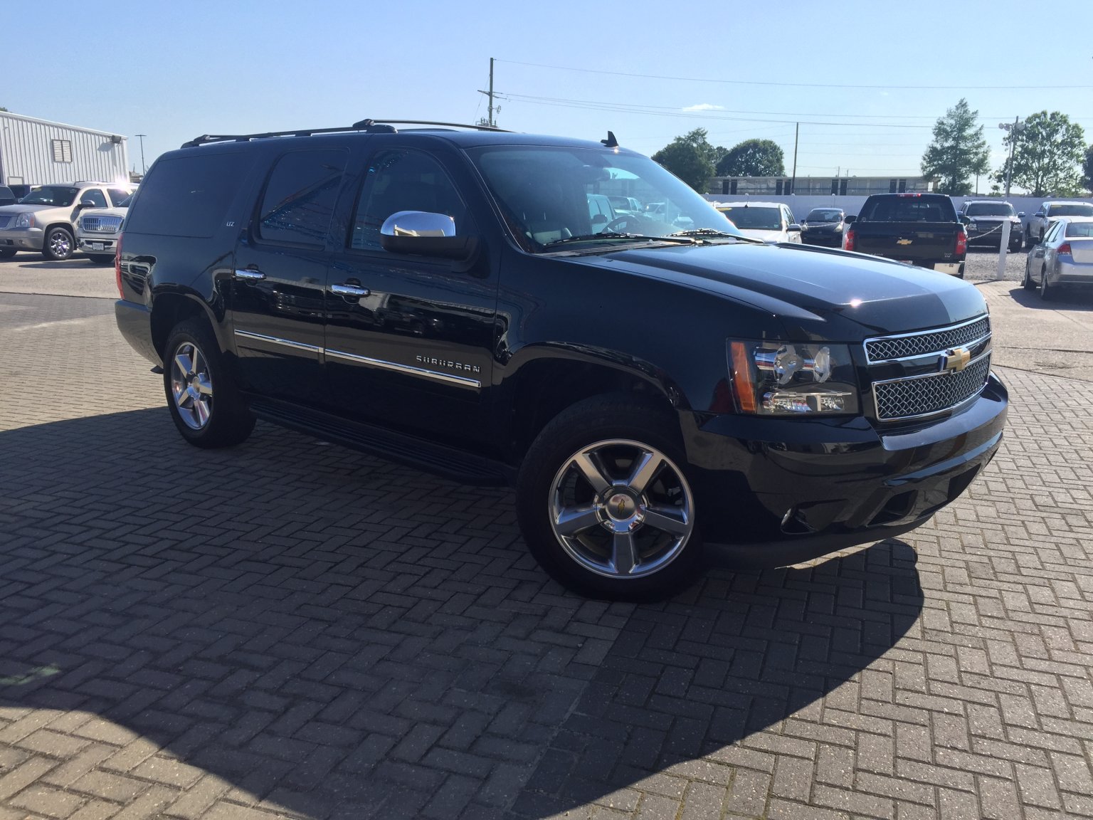

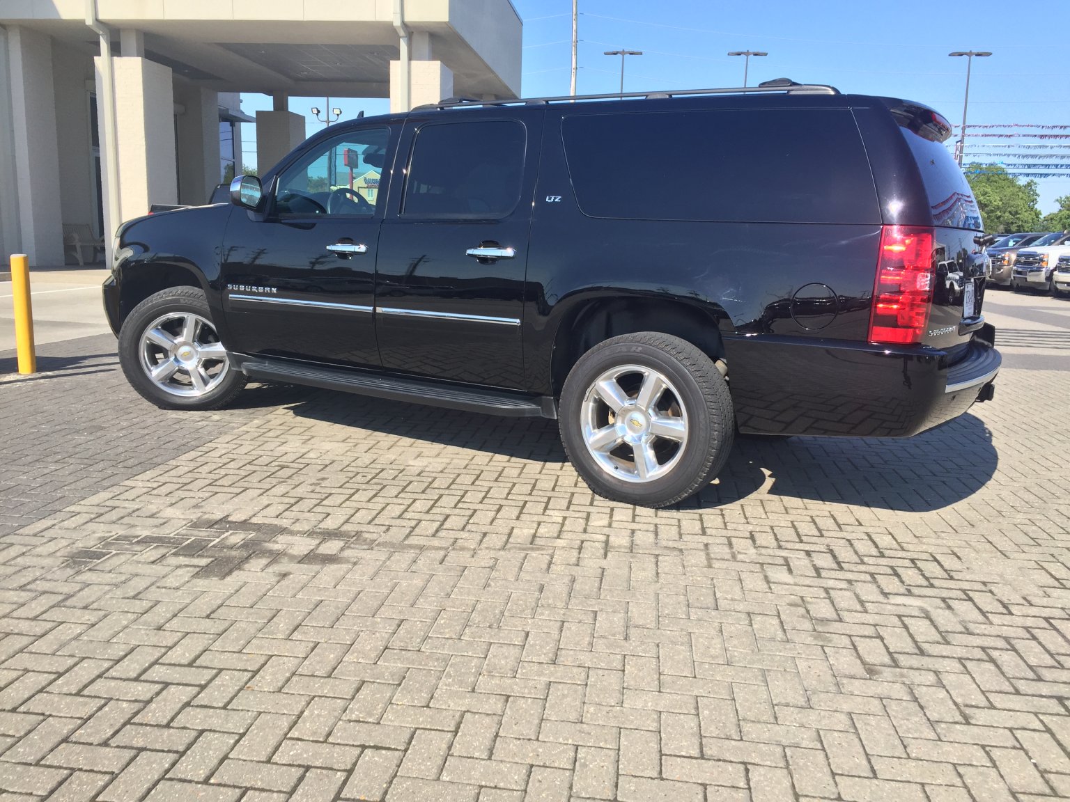

Any thoughts would be appreciated. And I will post pics! Here she is currently... long and low and already pretty close to level, just a tad higher in the back. Also these are 265/60r20 Goodyear Wrangler SR-As. Actual height it about 31 1/8 inch tall on the truck.

Heh. I agree she is clean and beautiful, but needs a little more edge with some decent rubber and I just do not like the chrome wheels!
