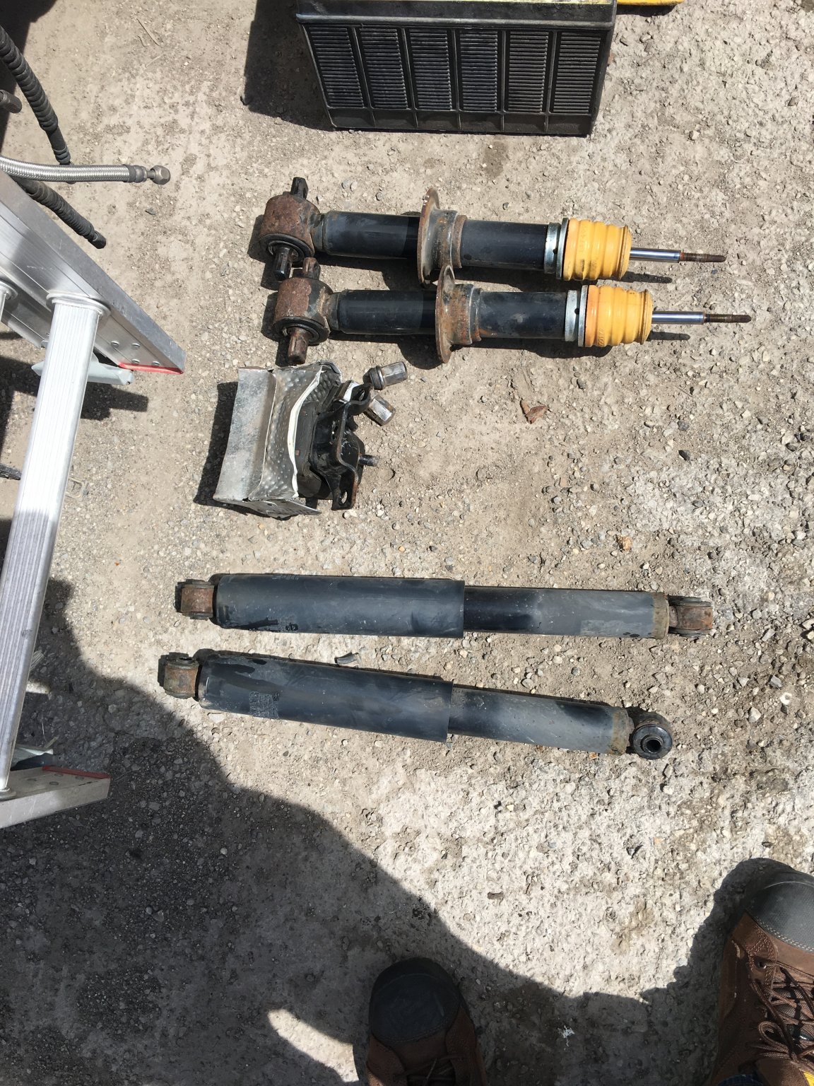

    I'm doing struts schocks on my 10 PPV , going with Belltech
    All ready have stock 20" Tahoe wheels
    Let you know about ride in few days

    Yep .. all done
    My old shocks did not work .,.
    Beeltech are smooth , and you can adjust heights on struts
    Did only struts and shocks

  9. metelhead
    metelhead Full Access Member
    Posts:
    126
    Likes Received:
    37
    Joined:
    Jan 30, 2010
    Name:
    josh
    dam those look rough!.....So the Belltech struts are height adjustable? thats cool. What the going rate on the belltechs?
    Just what are the differences between PPV and stock(suspension wise)....is it just different springs?....if so where can you buy?

    Day and night ...
    Still bumpy , but in good way .
