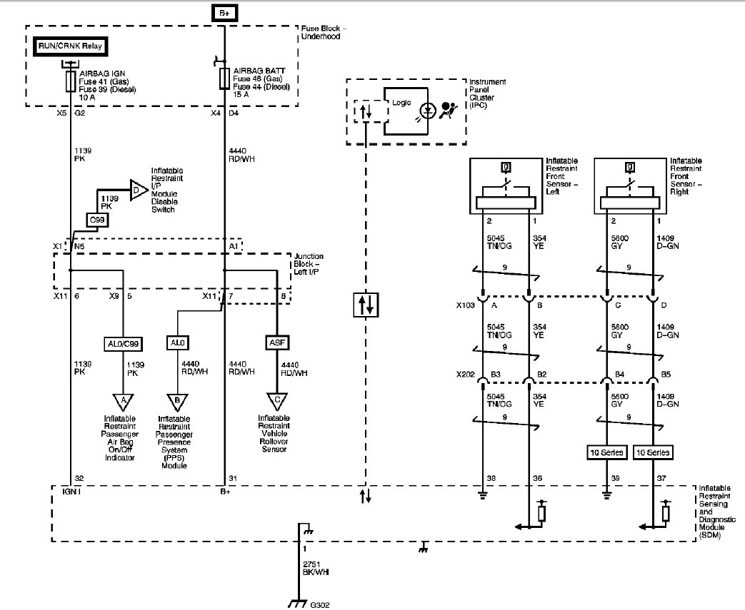

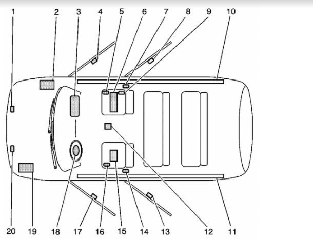

OK, so I finally got the scanner so I can read my airbag codes, came up with this one B0084-39 Right Front Impact Sensor.
Tried to clear it, did not clear, so I am assuming the sensor is bad or has an issue.
Anyone know where the Right Front Sensor is? I looked and did not see anything. A diagram of where this is located would be great!
