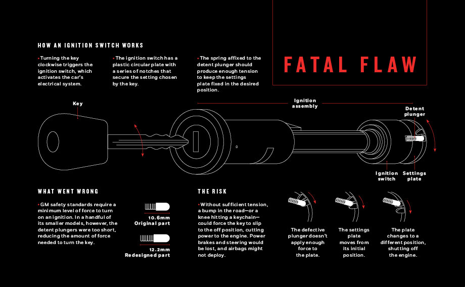

    I would start by removing the ignition lock cylinder and inspect the ring and detents that the plungers ride along. It's a pretty common thing for GM's that those wear pretty bad.

    The spring action does not come from the ignition lock cylinder. It comes from the ignition switch(electrical switch). There is a spring down in the ignition switch. Anything binding in the ignition lock cylinder or the ignition switch itself will cause this "sticking" along with the internal spring being weak in the ignition switch itself. Every one that I have seen do this sticking has been the ignition switch itself. Failure is the weak spring or the plastic dusting in the mechanical part of the switch causing binding.
