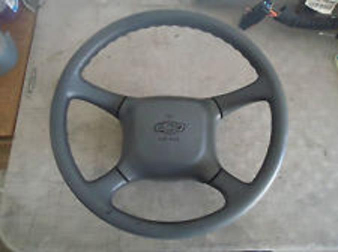

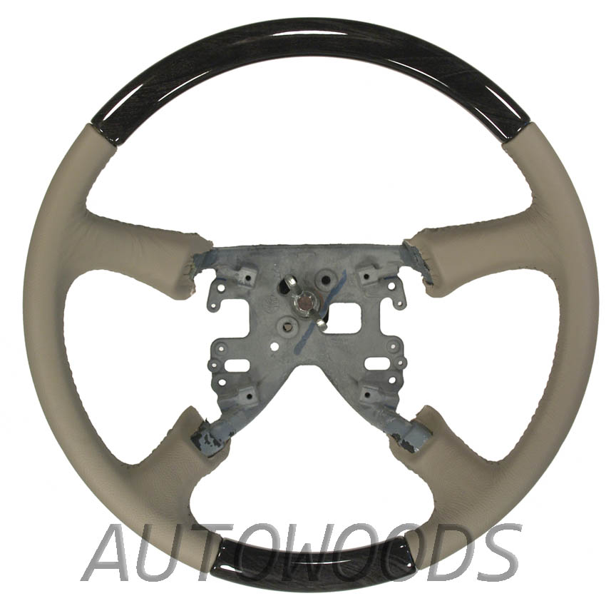

    Can I swap steering wheels from an 03-06 Yukon/Escalade/Tahoe with wood trim into my 2002 Yukon SLT? I can get my hands on one relatively fast but I want to make sure I don't throw away my money. I really don't like my plain, black, outdated steering wheel.

    What I have
    What I want
