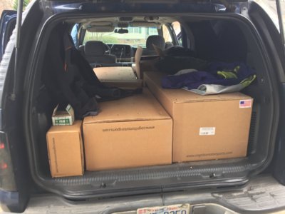

So close but not out of the woods yet. Most everything has shown up just waiting on tie-rods, will be putting the lift on and rebuilding all the steering over Xmas week, got a shop that can do the alignment scheduled for the 29th. Crossed all my I’s and dotted my T’s, lol.
Parts list:
