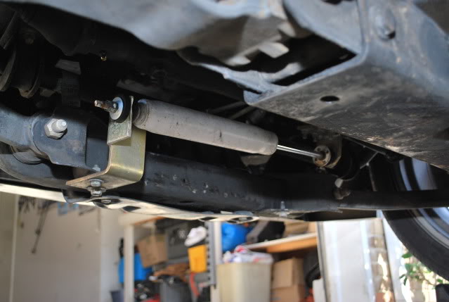

I dont use those stud washers. Tried everything else and the only thing that worked was the stabilizer.
Jk could we possibly see pictures of this set up ? this is something new to me.. and might consider doing it
I didnt take any pics, but if I get a chance to get underneath the truck this weekend I'll try to snap a couple pics for you.
