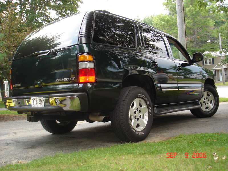

bone stock

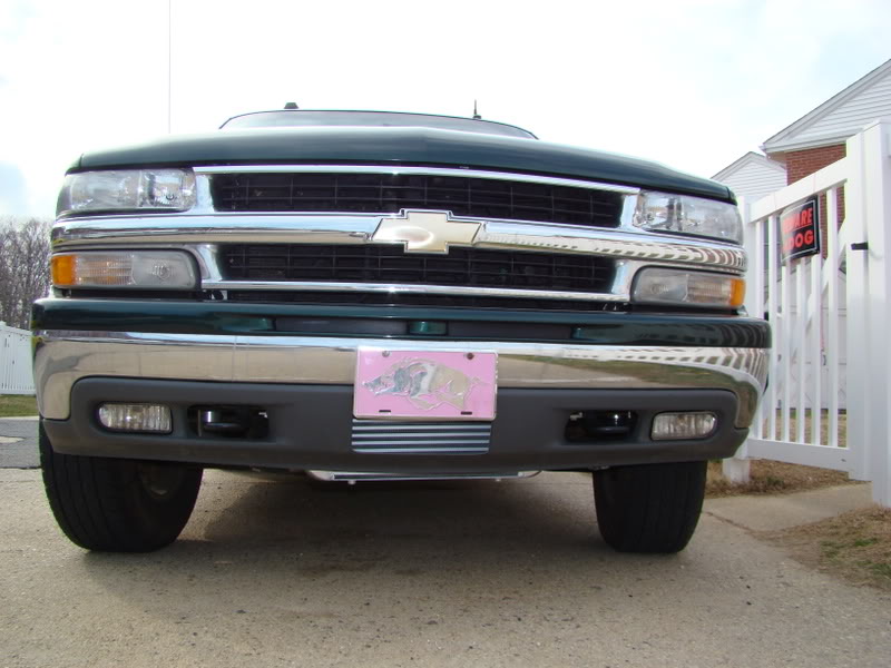

intercooler hole with wifes pink arkansas razorback.

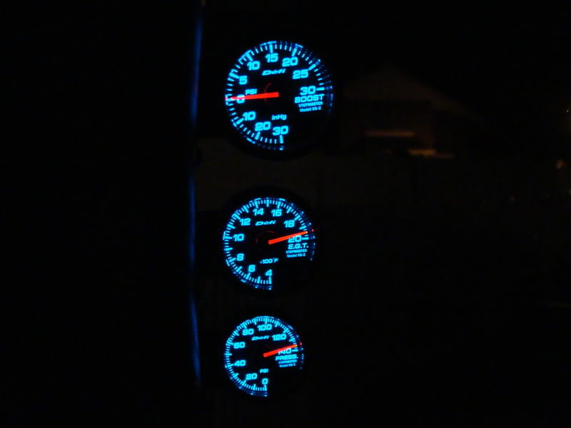

gauges

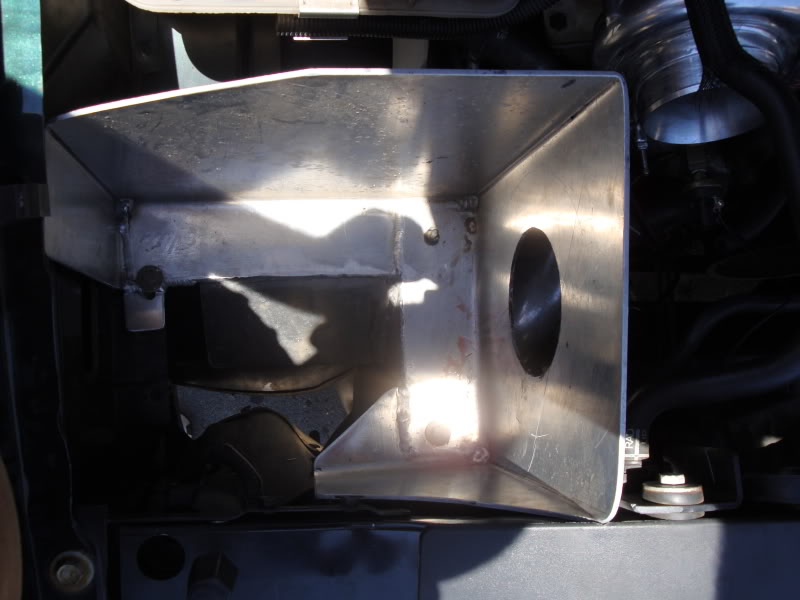

first homemade air box with ruber seal to seal off heat.

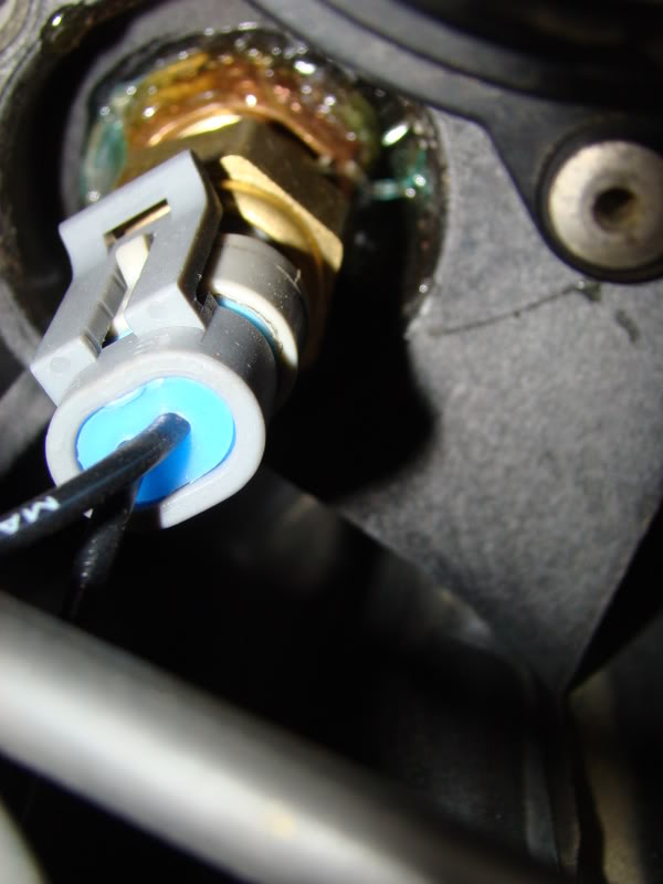

new IAT sensor in manifold

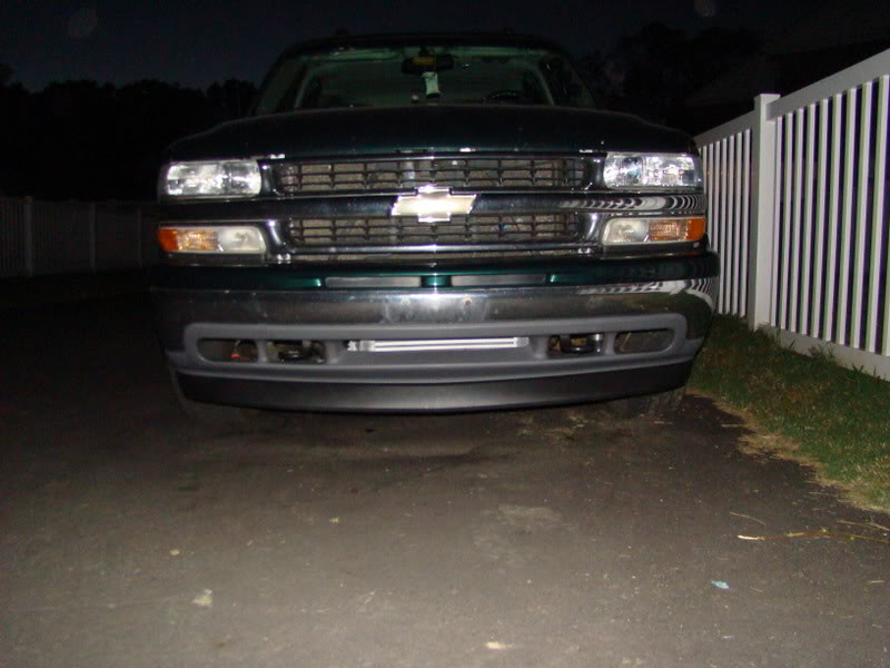

new lower valance, a mix of HD parts and 05 tahoe parts.

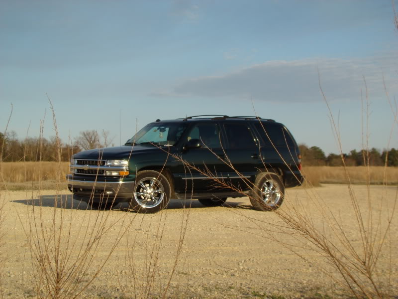

new wheels

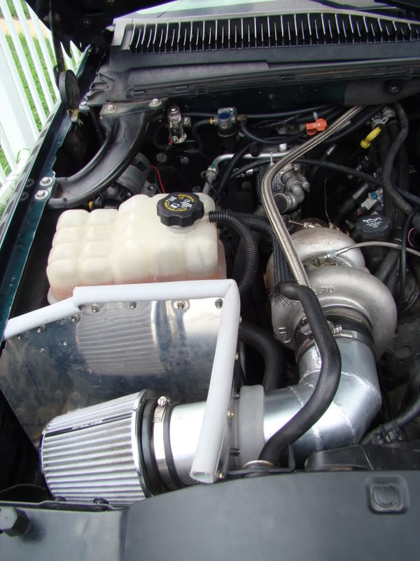

new stronger airbox with small scoop

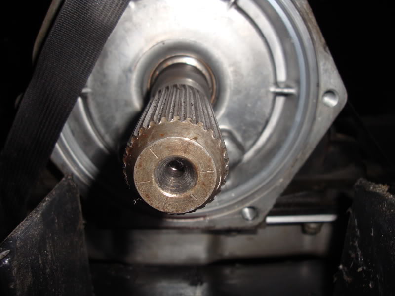

twist in out put shaft splens on trans

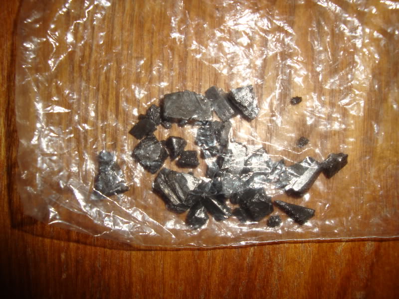

chucnks from same trans

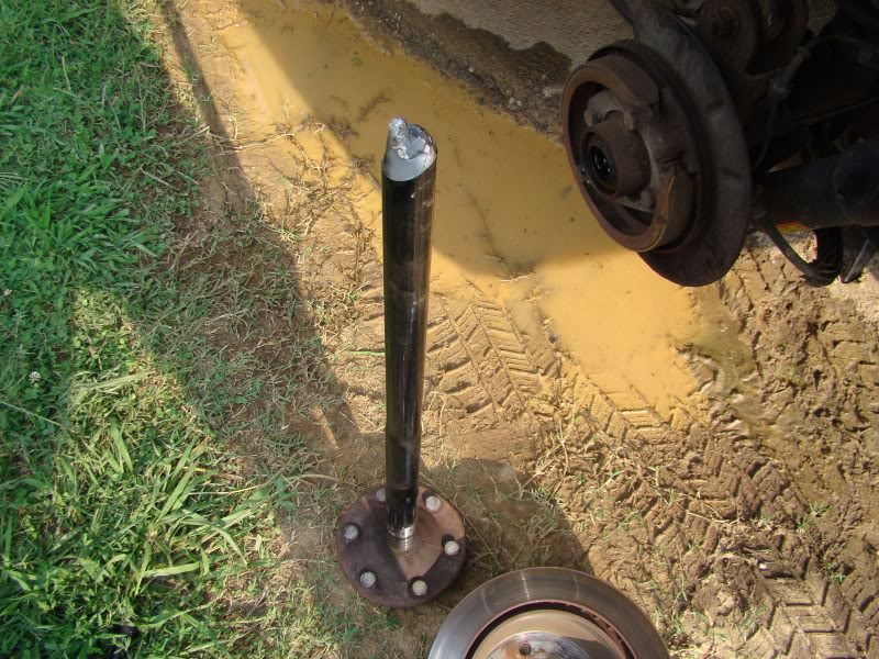

broken axle

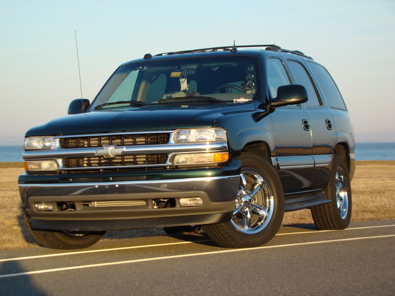

just a sexy pic

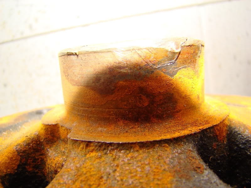

broken detroit locker

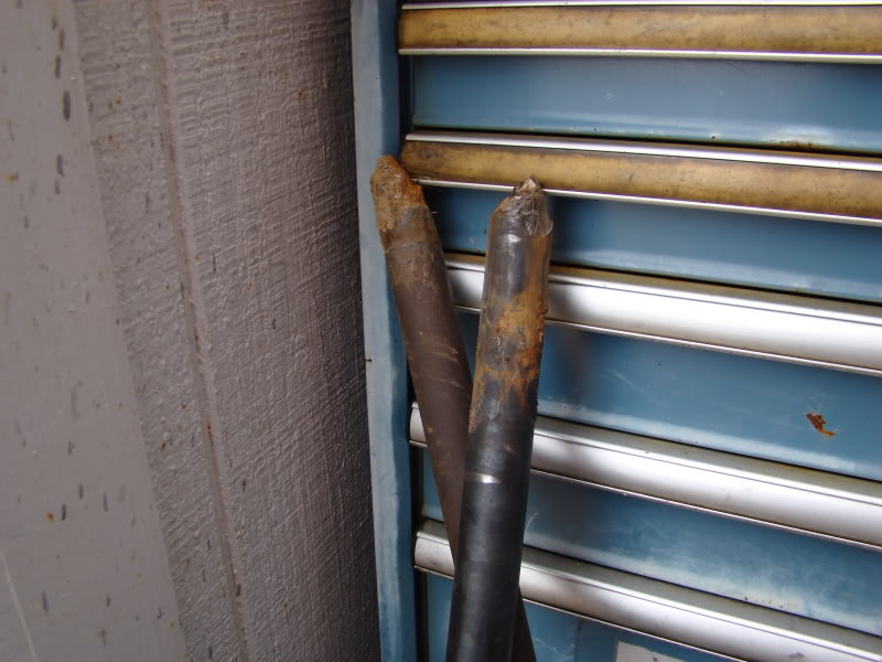

axle cross bones. both from left side

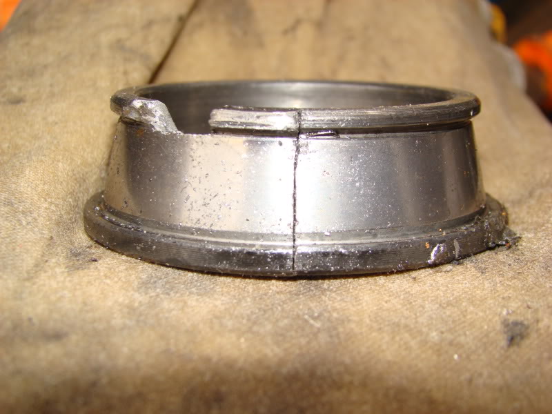

broken inner bearing race off locker

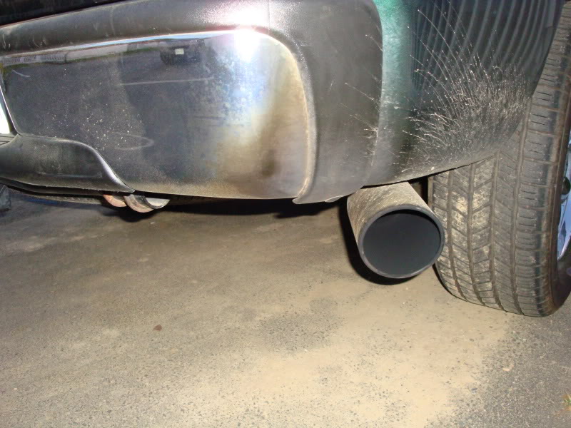

the turbo hot pipes are from trick as is the intercooler. the turbo is a tc78 turbo. 3" downpipe with a 4" duramax exhaust with magnaflow muffler. stock the tahoe is AWD. that case is not ideal for racing with this much power. so i went with a SSS t-case. but then my front end started to whine. so i pulled it out and installed a modified autotrac case. i took all the 4wd parts from the case so its only 2wd. that's whats in there now until i get the front end back together. torque converter is a yank sc3200 and tune is done by me with hptuners. its running seimen 60's for injectors and dual fuel pumps. and a zo6 cam with ls6 heads that have been port and polished. running 10psi on the street with a high boost switch that gives me about 12.5psi.

here are my guages. they are made by defi

these runs were made after going 2wd. doing so my rear end didn't like it. here is what 7psi launch will do.
http://videos.streetfire.net/video/turbo-tahoe-breaks-axle_719346.htm
---------- Post added at 04:06 PM ---------- Previous post was at 04:04 PM ----------
dang, you always can find the next weak links when putting that kind of power down :D
tell me about it. that's why i want the awd back. help transfer the power to all 4 vise just the two.

haven't got to a dyno yet. i really want to before i go back AWD. i found a local dyno i may try out. incase you guys didn't know, if you want a stronger rear axle with out alot of trouble. you can go to a new model escalade axle. the 6.2l ones have 14bolt 9.5" rears that have the same suspension as us and it will bolt right in.
thats one of my future mods. but i think for now with the awd going back in i should be fine. i hope.........
