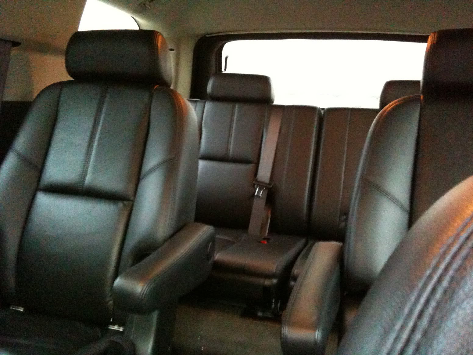

I was bored while waiting on my girlfriend at a restaurant so I took a picture. :D
Looks good!! :Handshake:
