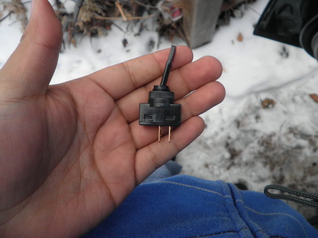

You will need a switch that is rated to equal or more of the amps of either the fuel pump or crank fuse. You see where I'm going with this?:naughty:

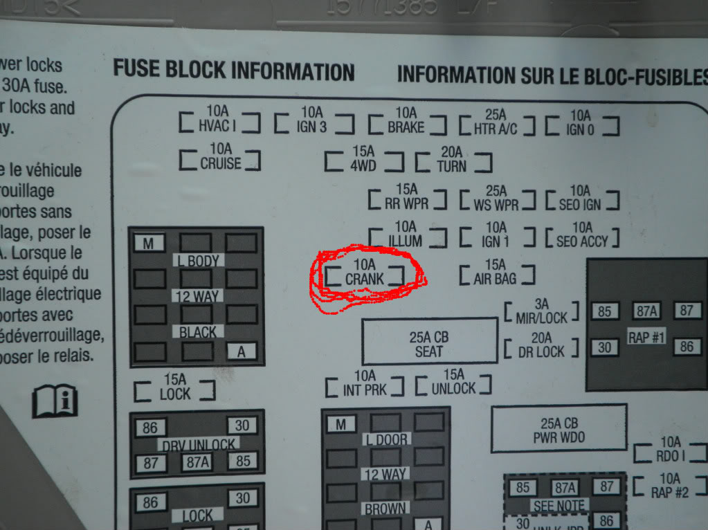

Find the fuse that disables the fuel pump or cranking. Our GMs only have a fuse labeled crank this should do it. For any manual transmission car/truck use fuel pump fuse.
You can find a fuse holder like this or just splice your harness. Make sure you keep a fuse in line with the switch in same size as oem.
The last step is to find a hiding spot for your switch. Make sure no one can see you activate it not even friends/thief:blah:. Usually is best somewhere where you can activate it with your foot.
