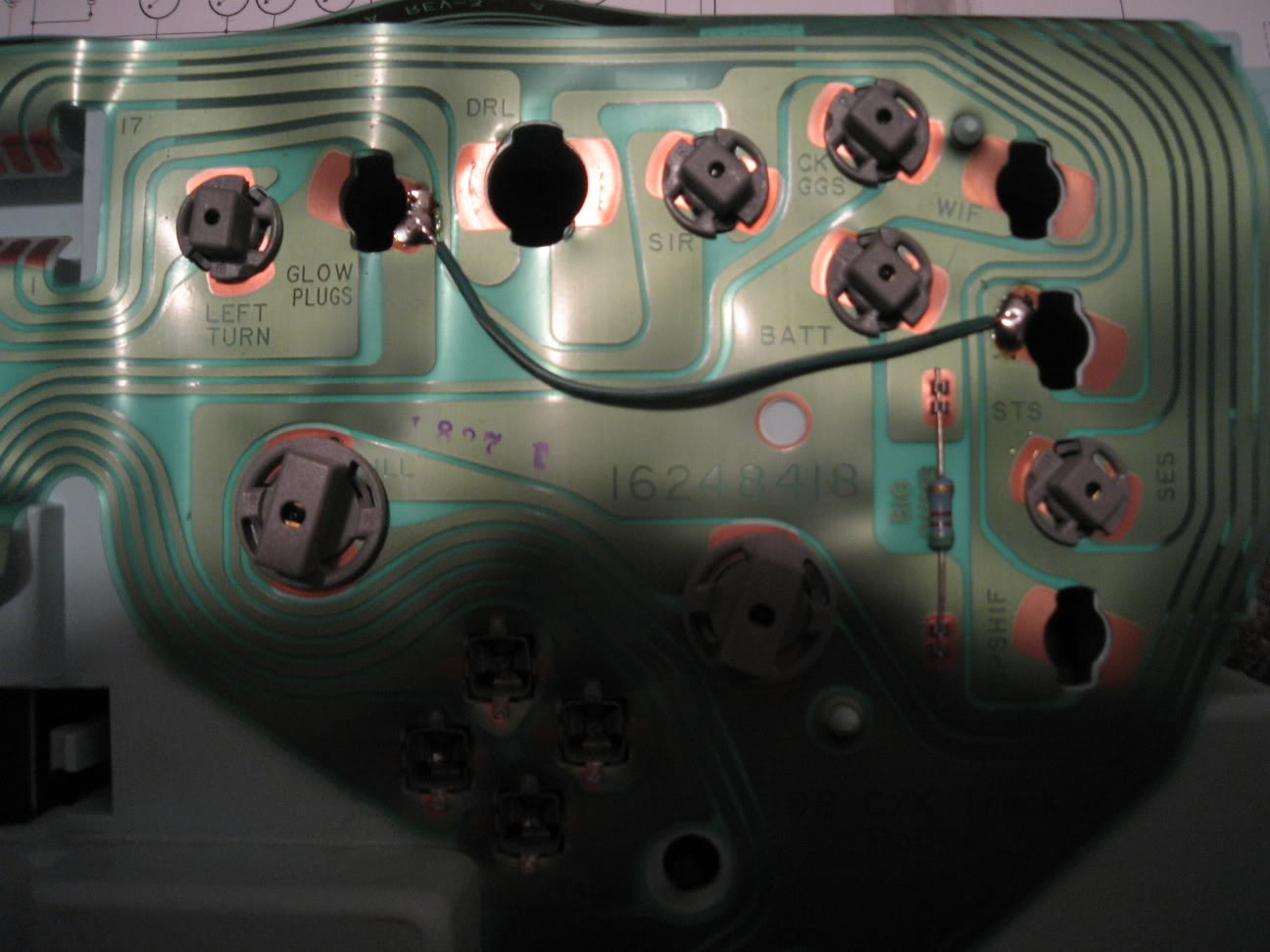

The 130mph police speedo needs a jumper wire soldered between two points on the back of the cluster and it will work too without any other modifications.
