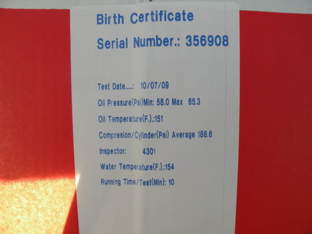

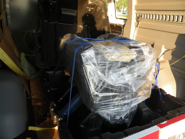

purchase a new longblock, and if you want more power, just to a cam/spring swap before installation.
