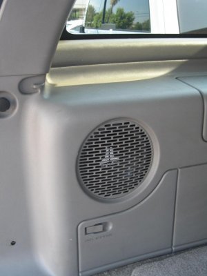

I just unscrewed the old one hooked up the power and ground and screwed the jl in

Got any specs (size, dept and such) on the stock sub? I need a new one as well, and I'm not sure what will fit in the original location.

Next time I head over to my moms house ill grab it for you, Any 8" shallow sub will fit

the stock sub is a 6", no? Maybe a 5" (doubt it, but this is Bose, King of the Odd).
If you're looking for just enough bass to fill in what the door speaks can't do, I think JL makes a 6" sub. I don't know how low it goes or how hard it hits, but I would think that'd be the easiest sub to retrofit into the Bose box.
Note to clarify - I'm talking about the center console one in the newer hoes, not the cargo area one.
Cool. I have a non-Bose equipped one though. But the side console looks the same as posted above, with the Sub and all.
