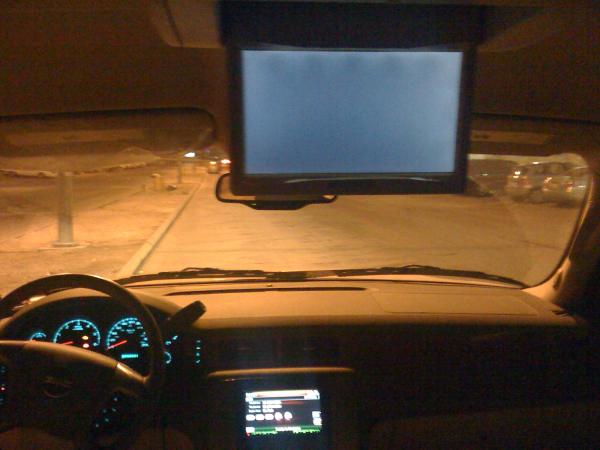

the rear DVD monitor always on after i install PAC GMRVD ?
check the image below
is this normal or some wiring issue with my installation

The door chime/turn indicator/warning chime is a known issue. they should have told you about it when you bought the Kenwood. Personally I don't miss the chimes.
The microphone should be okay there but perhaps you can move it to the top of the steering column.
Did you try to use the OEM remote control to turn the overhead unit off?
i will test it when i find the remote :banghead:

i had problems with my door chimes and turns signals not working when i installed my audio equip. after taking it to my guy, he just switch the channel on the amp. I have a crunch amp running my voice and it has a knob on the side to switch the channles and the rear dvd moniter is always on i noticed that whenever i put a new cd in the disc player but when i turn it off with the factory remote it doesn't do it anymore until i turn the truck off and get bac in. if that helps also i have the factory Nav.

YES, with newer Chevy/GM you need interface/moduel(sp?) for things like OnStar,Bose,Door Chimes,steering wheel controls etc. to work properly with aftermarket equipment...As far as the player on all the time, if it is wired to the raido you can hook up power for the DVD player to you accessory 12v power on the kenwood (RED not yellow wire is accessory). This is what i usually do, with an inline fuse as a precaution in some cases. Hope this may help. GL
