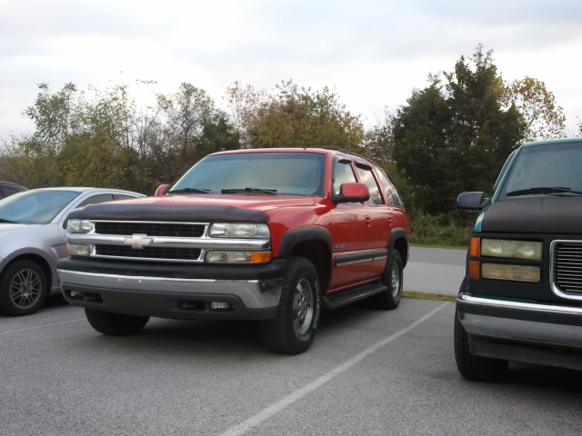

Her she is at work yesterday :rockit:
Only Red one I found in my search, and the three tone interior is growing on me :Caffeine:
Her backside

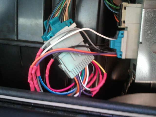

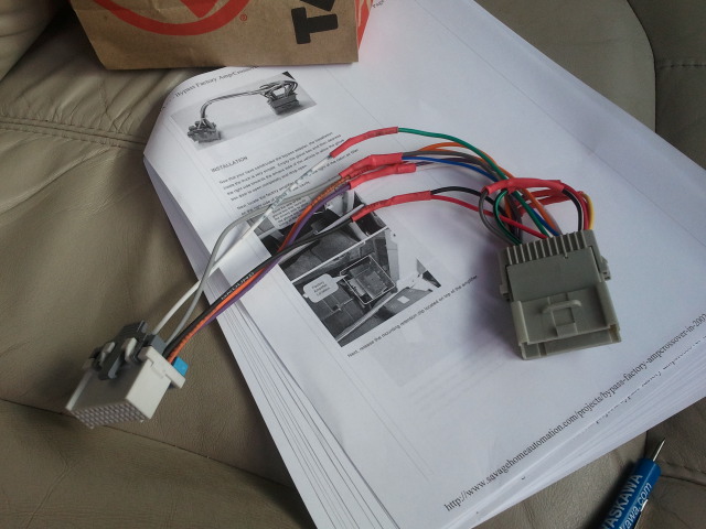

First mod was the high pass wiring mod for stereo, not the neatest one
hardest part was "breaking loose" the amp from mount to move it for install of cable, it was "glued" with 2 sided tape???must of been a rattle at some point
Amazing difference in sound quality :party36:

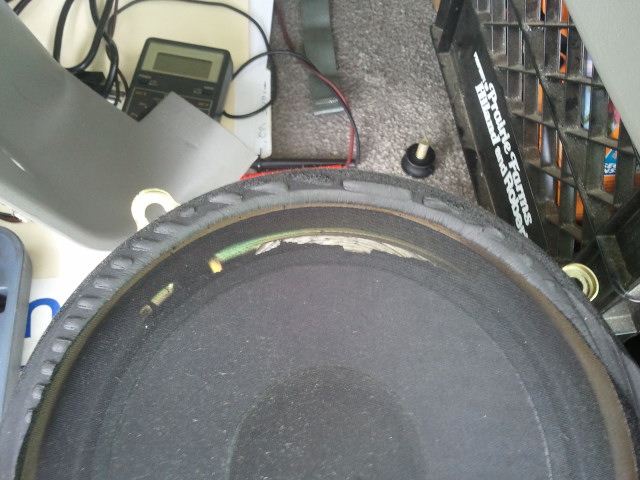

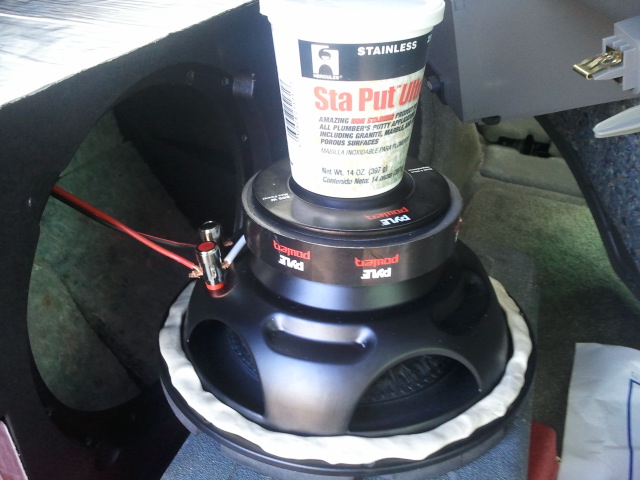

so now the factory sub really sounded like shit!!

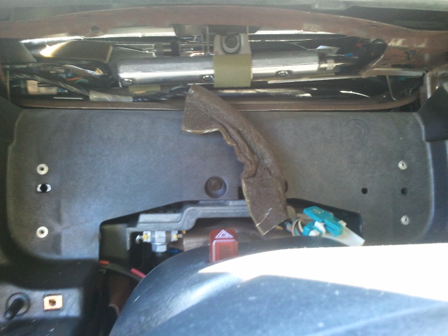

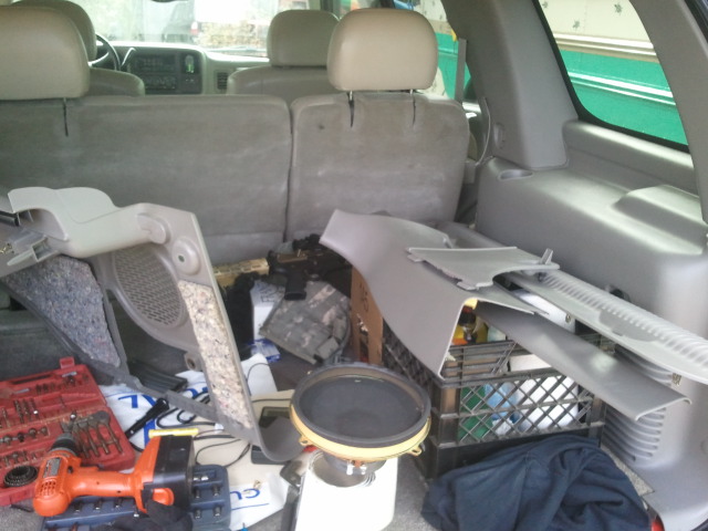

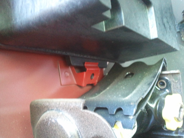

so....tear apart back of truck

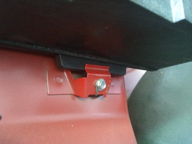

find this:
and since I didnt have any silicone....I used Plumbers putty :jester:
installed

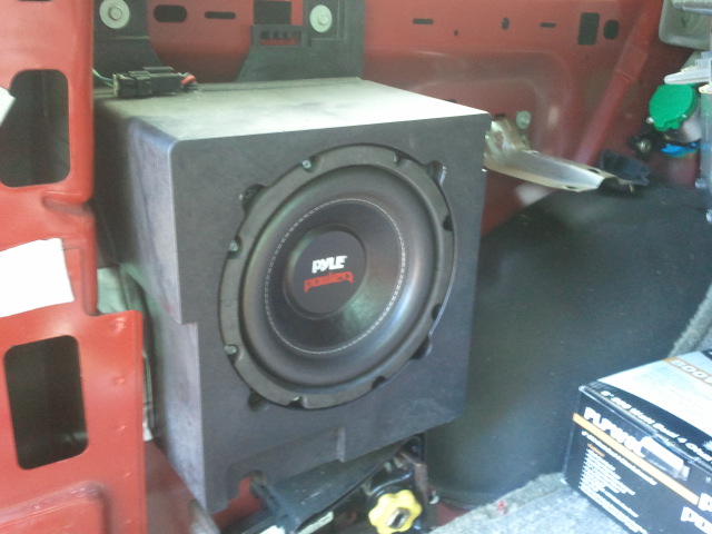

sounded good except for the rattle...who was the genius that designed this
:hmmm2:
I rolled up a rag and stuffed it behind the box and then grabbed a 1/2 in ling screw with washer.....no more rattle

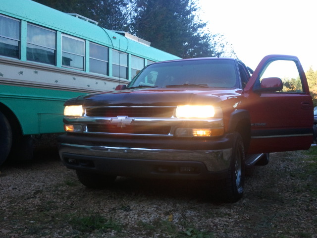

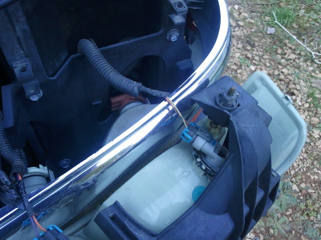

4 high mod
simple 5 min job
pop out light and splice into yellow wire and ground it out
walla'

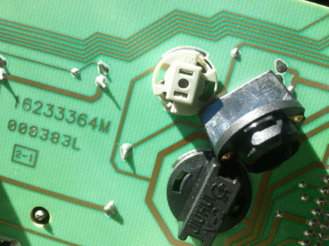

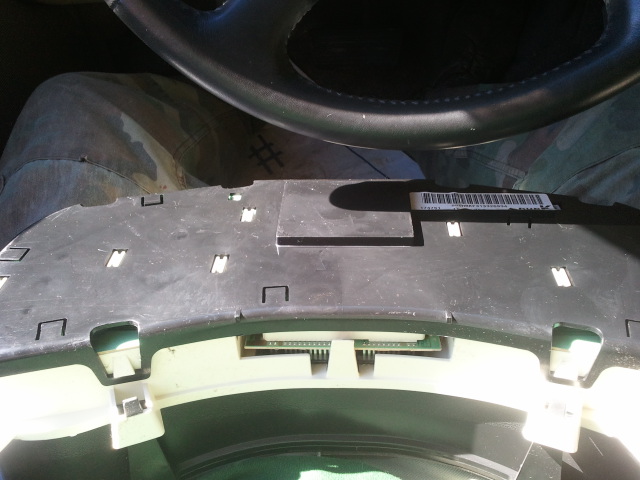

first step, remove dash bezel
then 7mm(socket size) bolts x 4
well, she decided to bite as I pulled on her gage cluster
I know "dont be a pansy" I am still on blood thinners so I had to stop the bleeding....3 bandaids later

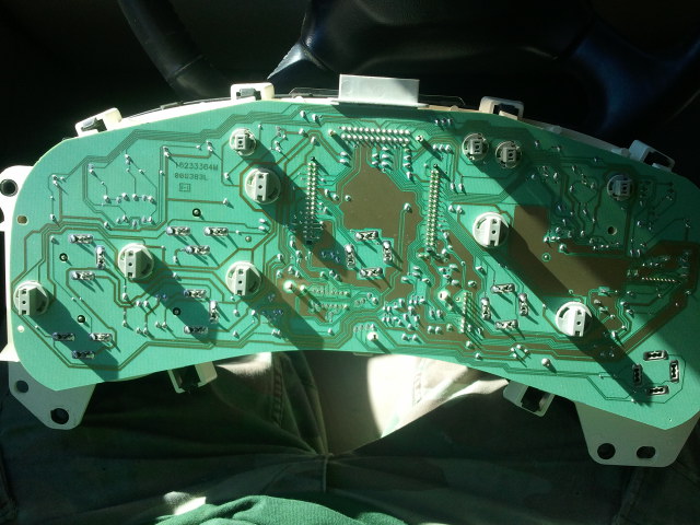

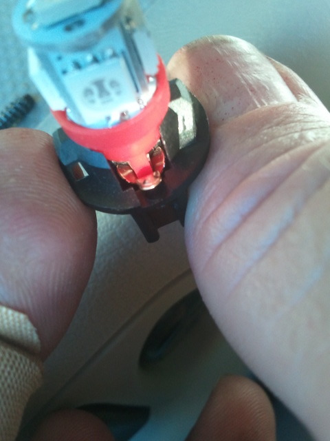

pop off back black plastic

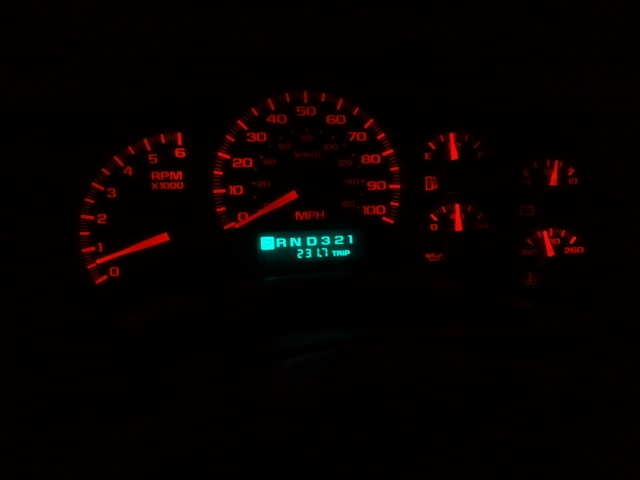

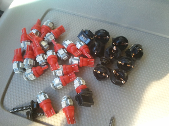

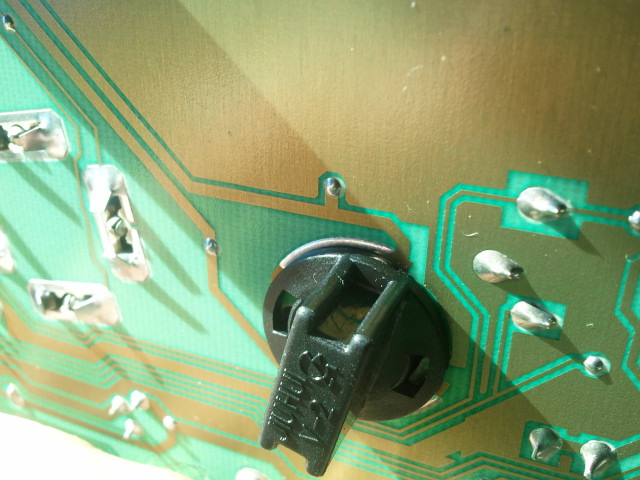

remove 6 larger light bulbs
grab a hand full of sockets and LED's
and replace them

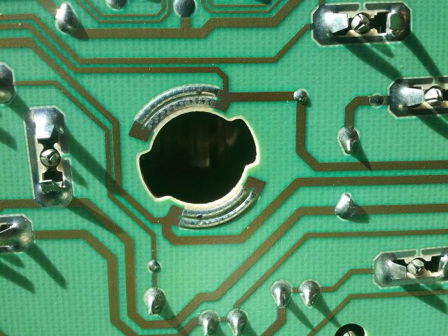

remember to not over "tighten/turn them" because you will not make electrical contact
see the contacts?
see the contact strips on the board?
and notice the "groove" in the sockets, which is too long for our dashes?
so turn them enough to stay in the hole and have contact with board
repeat 6 times
put back together, before final assy make sure polarity is correct, you may have to spin bulb sockets 180*....i will find out tonite

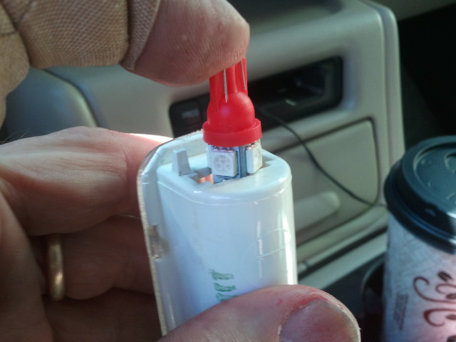

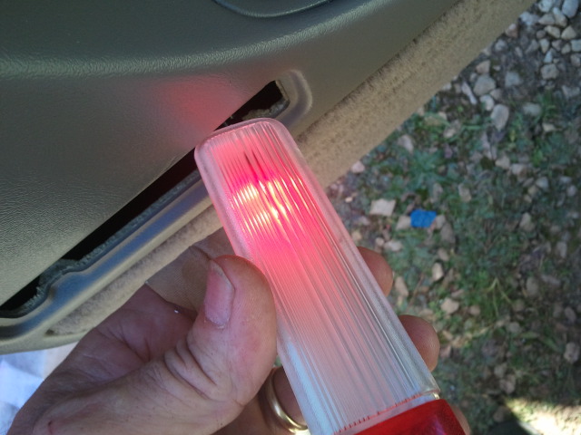

next door lights, small screwdriver on the "RED" end will pop them out

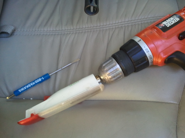

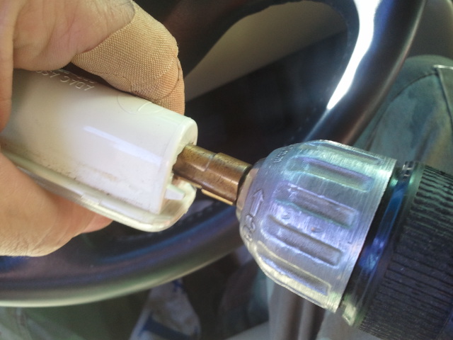

the 5 LED bulbs dont fit into the sockets...so....
break out your step drill and open them up
open up to 1/2 inch
install bulb and repeat around the truck

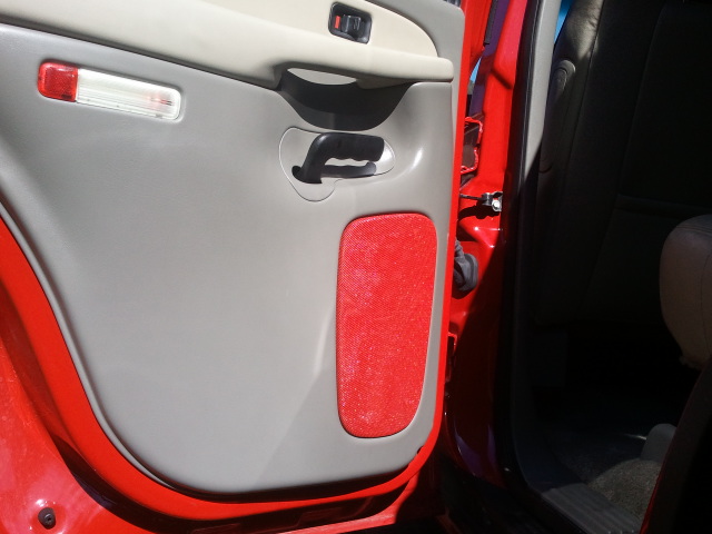

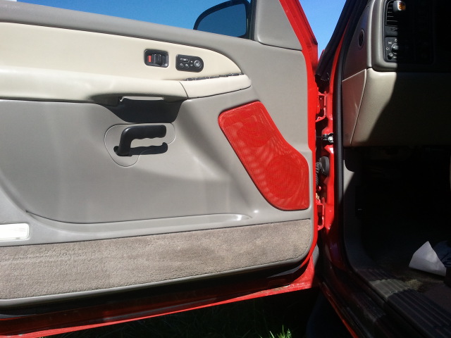

dash...yup...red not blue...I have 100 more leds for everything else
so when we leave winery...we have nothing but dirt until we get home (5miles of road actually)
well......mama said "why does it smell like paint?"
ugh..ugh..oops...she rolled her eyes....
grills look alot better in person??? no streaks etc...weird
she actually said "you know your 45 and not a kid....:upyours:

Great build thread! Nice to see someone else paint the speaker grilles too, are you planning on painting more of the interior red or just the grilles?
B
bansil
Oct 21, 2014
36
East TN in the MNTS
thanks
more will get painted, like the inserts around door handles
