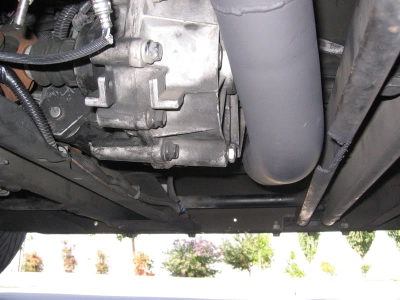

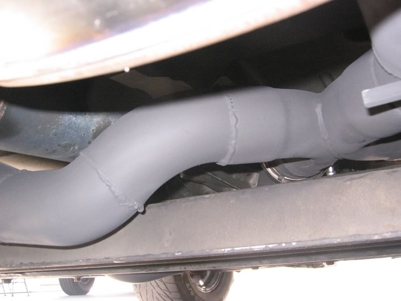

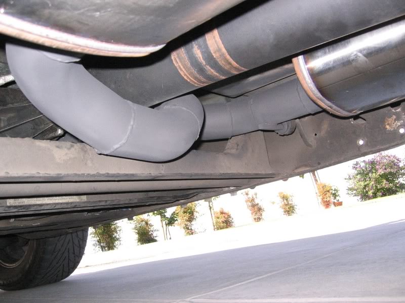

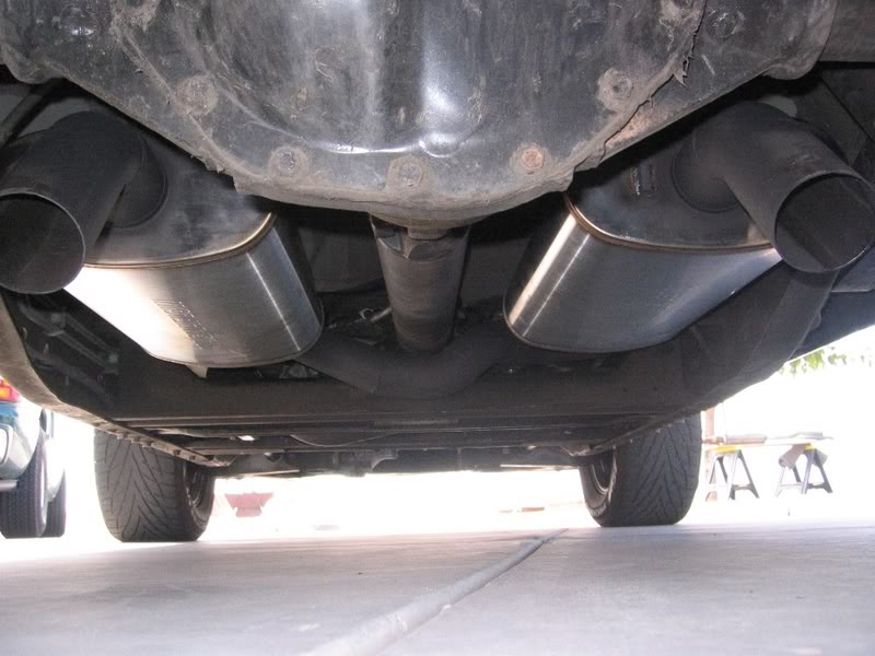

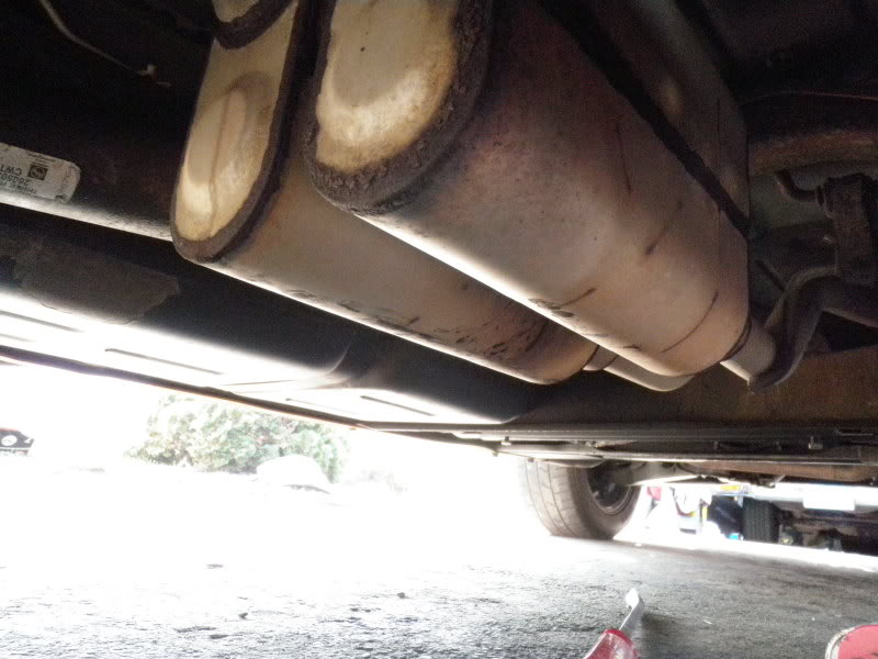

Mine
Dual 3" 5x11x22" magnaflows, 3" mandrel bent tubes, x-pipe, v-band clamps for easy removal.
Whippled2dr
Stock
May 20, 2009
102
SF Bay Area
Its pretty loud even with the two huge mufflers. The dual 3" made the tone louder but deeper. I also have long tubes so that probably adds to the loudness.

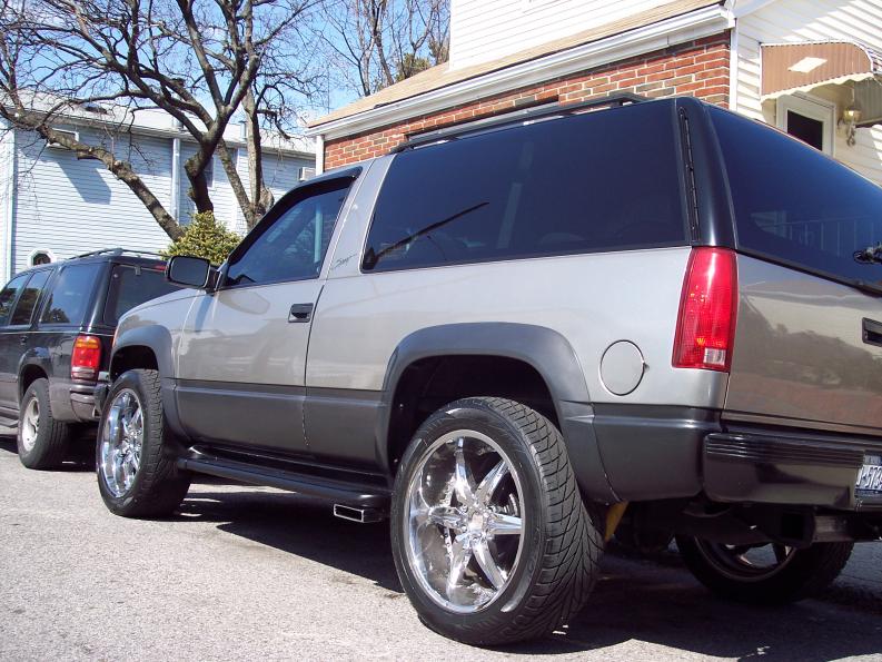

how i did it 2-2 1/2 in front of rear wheels

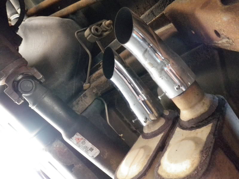

I'll post up some pics of mine tomorrow if I finish by then..
Edit: Here they are.. it's not pretty but it will do for now

Whippled2dr ,
Thats a sweet set up. I'm planning on doing mine like yours but I have a 2wd so I have quite a bit more room. Is it obnoxiously loud? What kind of power are you making with your set up? I'm jealous.

Very creative. How does it sound? Is it a Flowmaster? If so what series?

destroyer1362,
How does that sound with the Borla? Also how does it sound from going to a di/si to si/so? Specs on muffler?

The muffler is a borla turbo 2.5 center in/ offset out, and the y-pipe is a stamped magnaflow 2in in/2.5 in out. When idling you can only hear a light rumble inside the truck. I think its quieter then a fm 40. When accelerating it gets pretty loud but not overwhelming, you can still carry on a conversation. I'm pretty sure it so quiet inside bc im running a single out. One more thing, according to my friends the thing is pretty loud if your driving next to me if that makes any sense.
