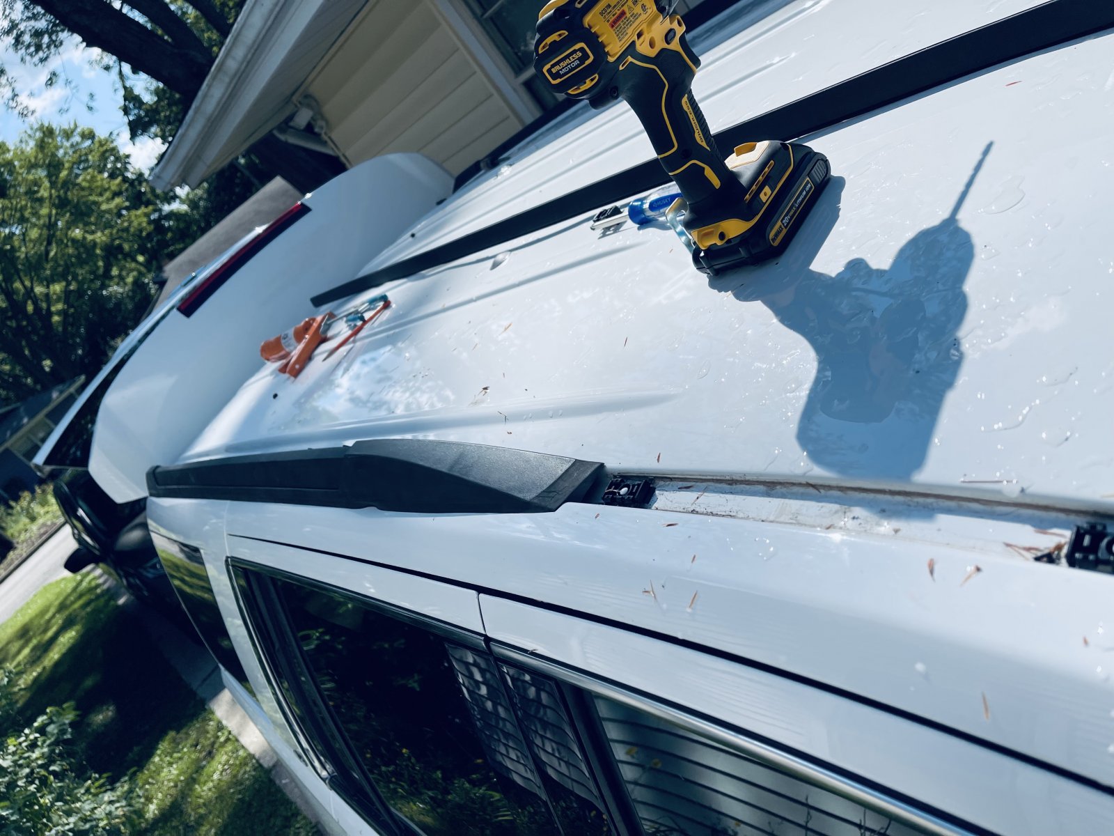

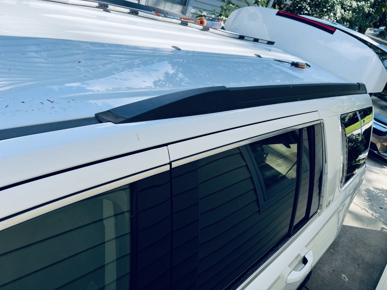

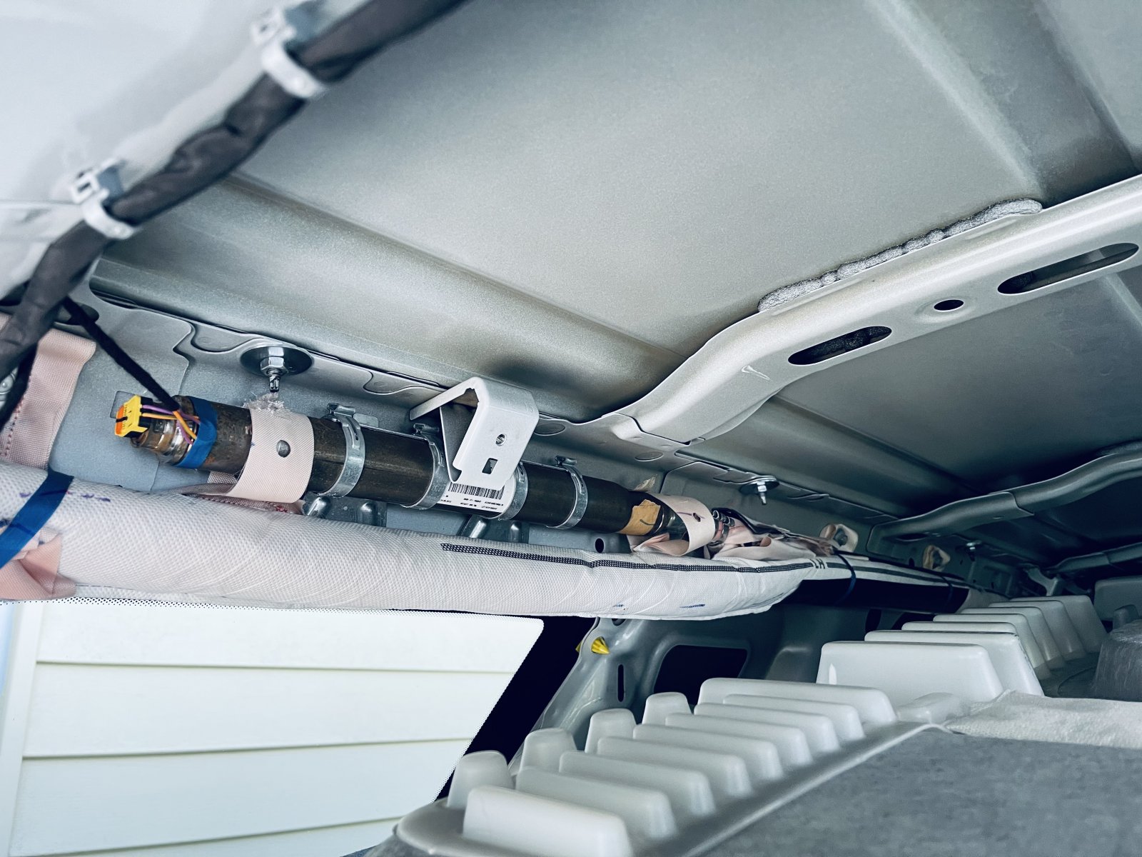

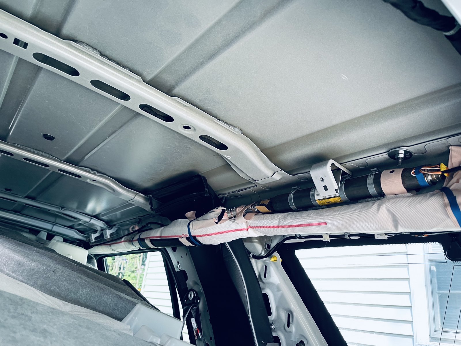

Hi
New to the forum!
It is crazy that I did the same exact thing today. Worked out great and looks pretty nice.
The whole process took me a little over an hour. Pls see the photos
