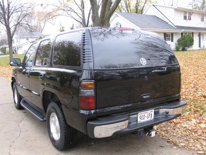

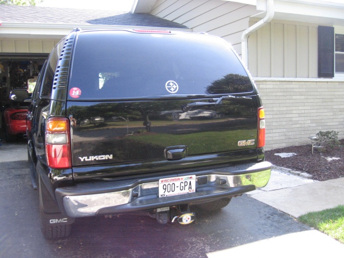

I used the nightshades and afterwards used some 1500 and 2000 grit paper and wet sanded them, followed by a cleaner/wax and they ended up looking really good. It actually took some of the dark tint out of it too which is what I wanted.
BEFORE:
AFTER:
BEFORE:
AFTER:
do you really consider that smoked?
yooformula
Sep 6, 2009
271
Milwaukee, Wi.
lol, ok how about tinted.. better now? They were damm near black before I began to wet sand them but I dont need them that dark. I have kids that ride daily in that truck and would feel safer knowing other drivers could see my taillights.
