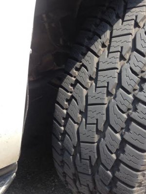

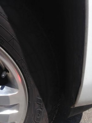

Yukon11
May 23, 2012
32
Arkansas
sorry for the bad quality was in a rush. You can see the first two are with the tire straight, the other two are with it turned in (cant really see the front i know) There is plenty of room with the tire turned out so i didnt take a pic of that. Wishing i had time to clean it up and take some better pics, but i hope this helps.

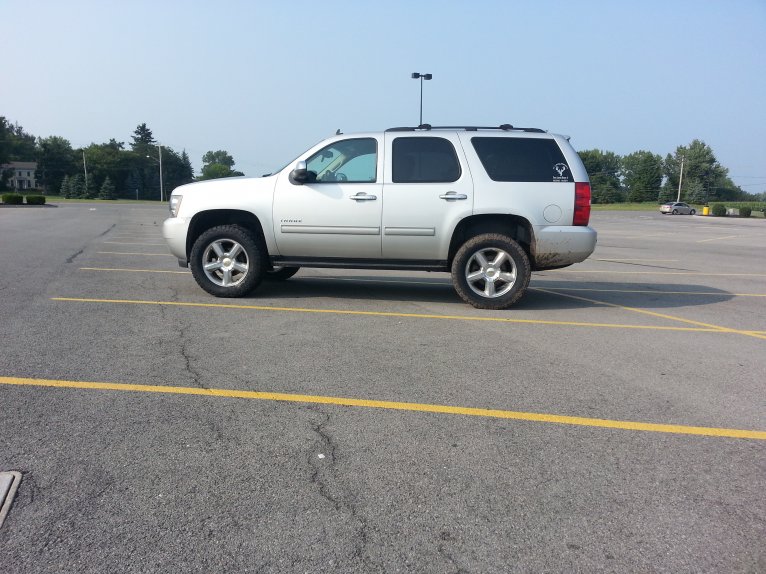

kpachastings
Jun 2, 2014
18
wny
2011 3inch front 2inch rear lift/level kit. 305/55/20 on stock rims. I have been following you guys for a while now. Finally got my tires yesterday. Minimal rub on full-turn right now with no wheel spacers.
