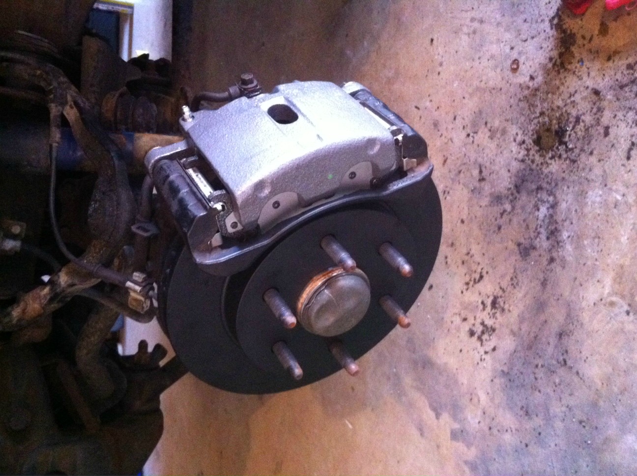

Front rotors were toast. Pads worn. Calipers stuck. Did a rebuild with new parts.

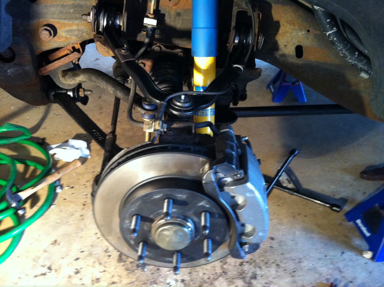

Oh and finished the drivers side. Lower/upper control arm, sway bar link, shock. Waiting for Amazon to get me the passenger side parts. I used Raybestos arms, moog link and Bilstein shocks.
The Raybestos ball joints were damn tight and didnt take much grease. I pumped hard and none came out of the boot. Once grease was in they moved nicely.
Oh and get a real tool to remove the torsion bars. Worth it.

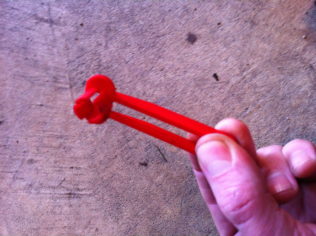

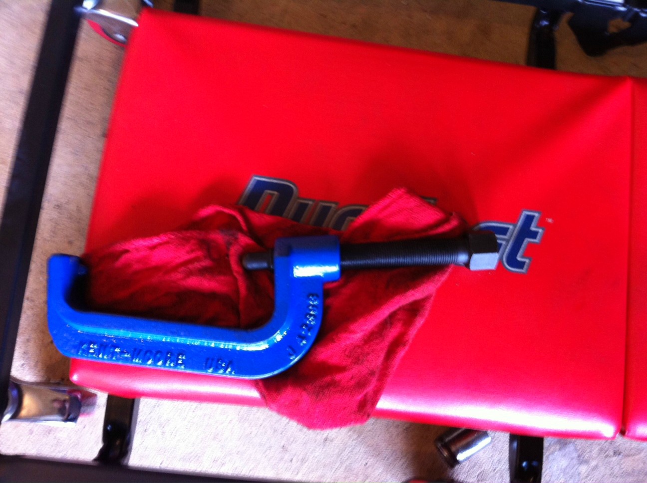

So you wanna remove the fuel filter of a 2002 or earlier truck. Get this OTC tool not the Autobros POS tool. This works. My hands look old.

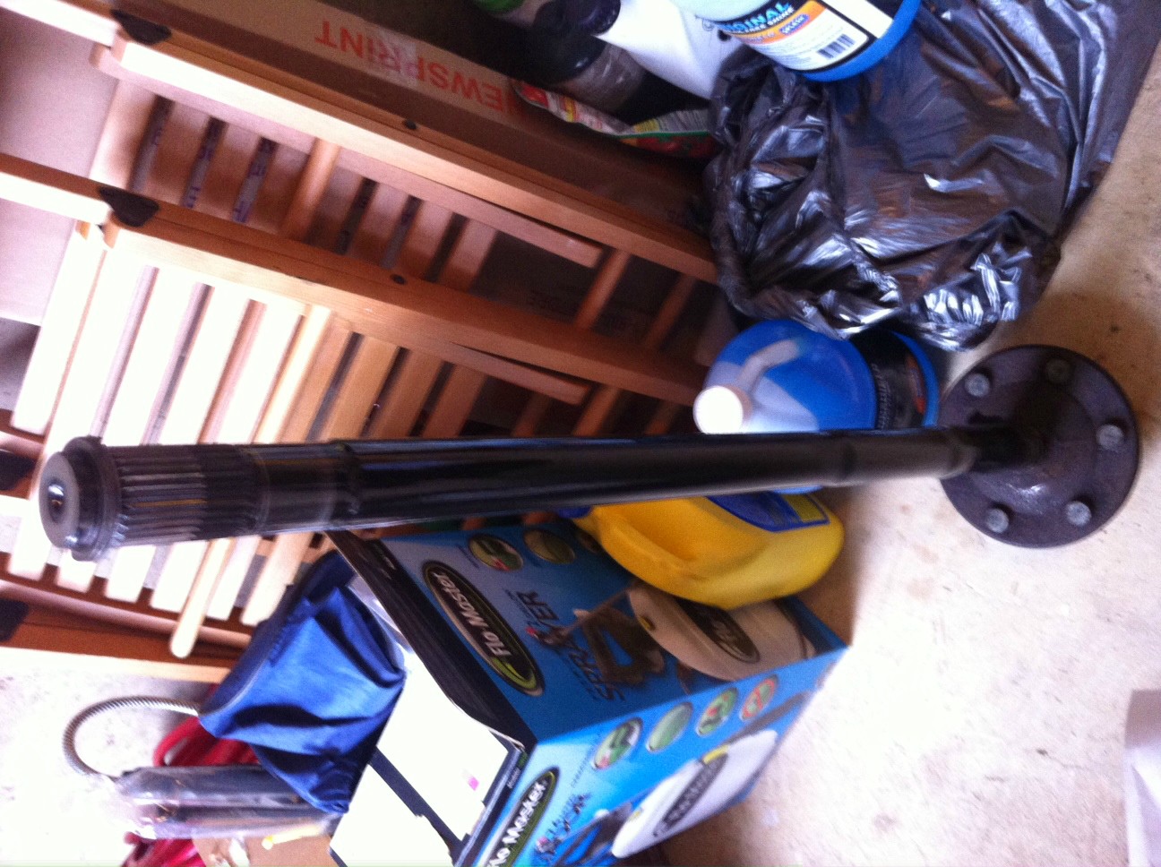

Here is my rear axel.

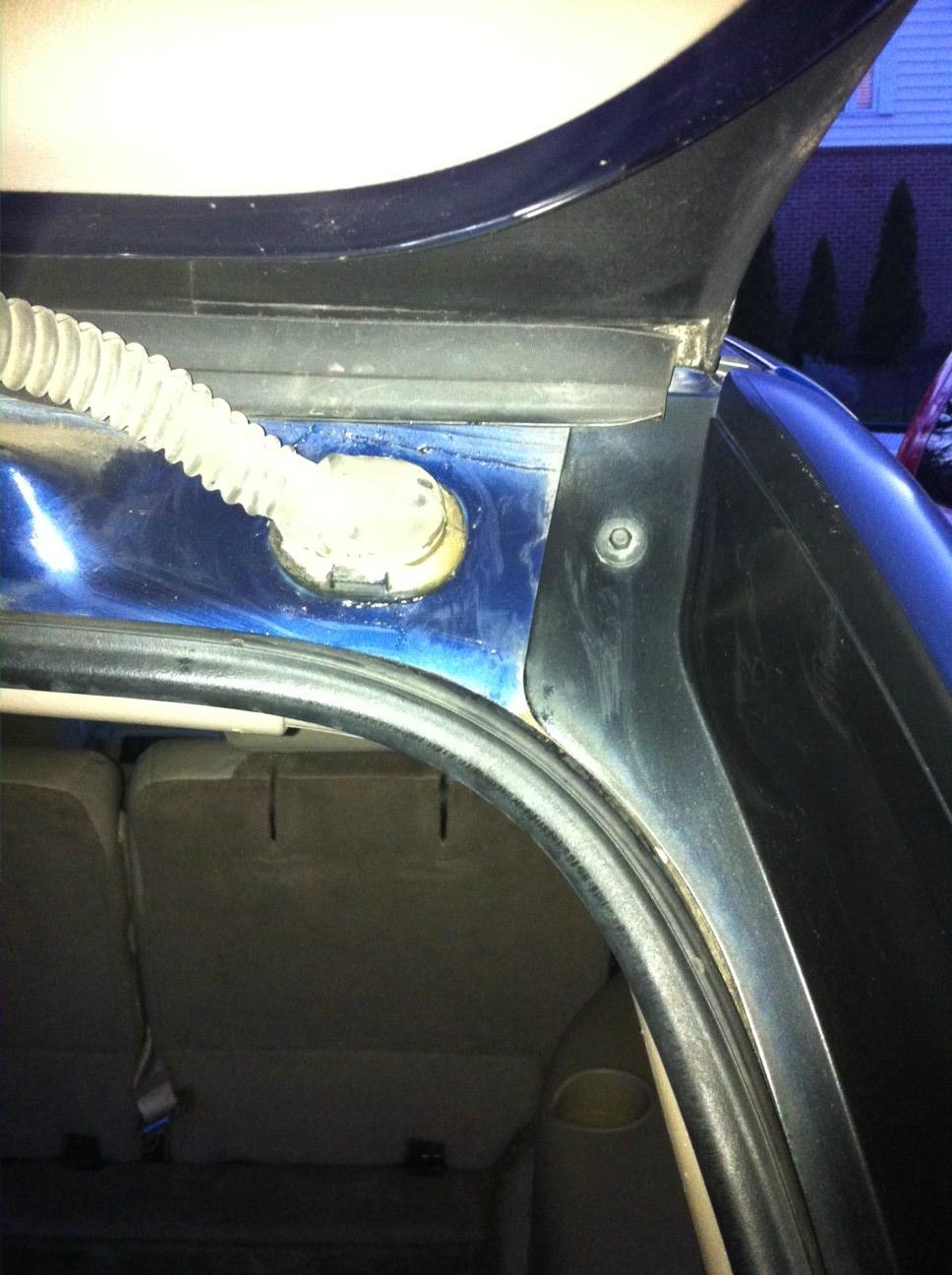

We had a huuuge rainstorm! I found that the rear carpet was getting soaked. The trim seemed OK at the rear hatch. What I did find is that the gromet that holds the wire loom in place seemed old and loose. I used some clear silicon sealant to hopefully take care of the leak.
I also decided to replace the cabin filter. It seems that it has never been changed. 12 years of crap in the filter. All the crap on the ground and on the paper towel is only a part of the shit I found. Lesson here is to replace your cabin filter once in a while.

I had the same thing with my barn doors on mine and used the same fix. Cabin filters are fun aren't they?
