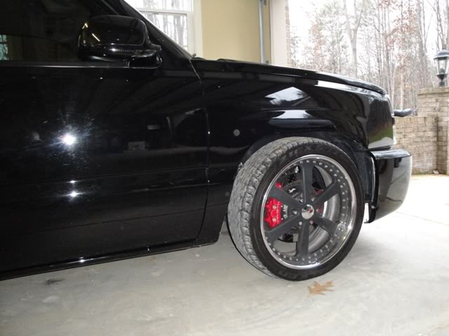

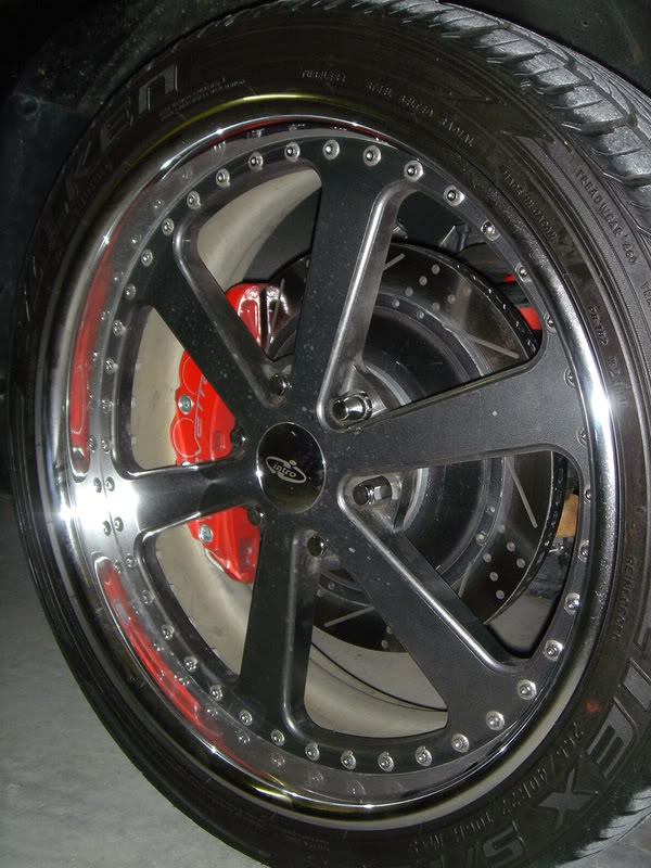

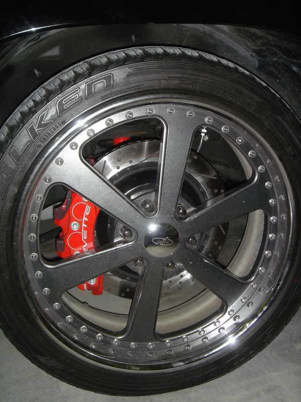

Had them on my NBS. Nice project that you can piece together little by little to get a pretty cool end result, something very unique. Sad that Rudy won't be making these brackets anymore. Were you able to score the rear ones too? Snag em while you can!!
Nice choice on the yellow calipers. That oughta look pretty nifty on that Esky!

Robbie is so...... been there done that...... that he posts old pictures claiming......... I been there done that
Hahahahahhahahaa

Ain't seen it done on a NNBS. Besides, atleast I can try to offer assistance. I know my install was a ***** with my lowered spindles. Had to do a lot of grinding.
