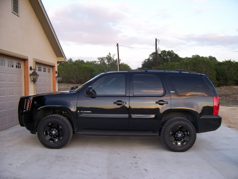

BTW, I was able to find a picture of this truck while searching. Those are 18x9's with 0mm offset and 5.0" BS.

So it would rub because they were too far in or too far out? Its my understanding that the more positive offset, the more they are inside the fenders. With the stock wheels being 31mm offset, and these wheels being 10mm offset, you are saying that they would stick farther out?
With the picture of the Yukon I posted, is that a 0mm offset or not?
