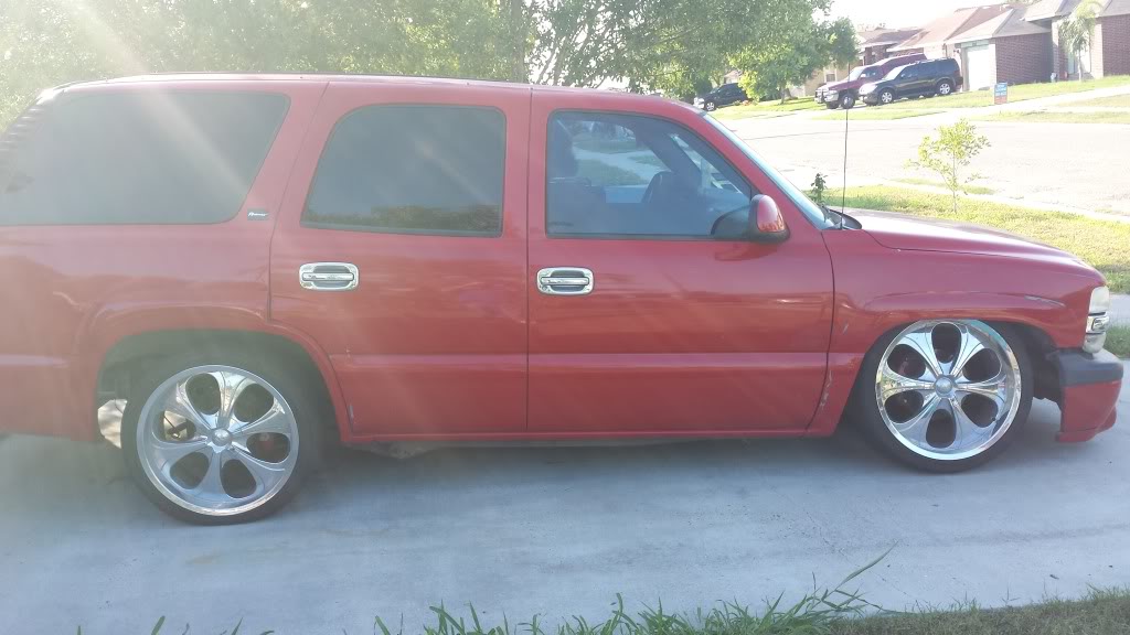

Haven't installed the shocks yet. I have the parts from ekstensive just haven't had time. Here's a pic of it aired completely out. That's as far down as the back goes right now.

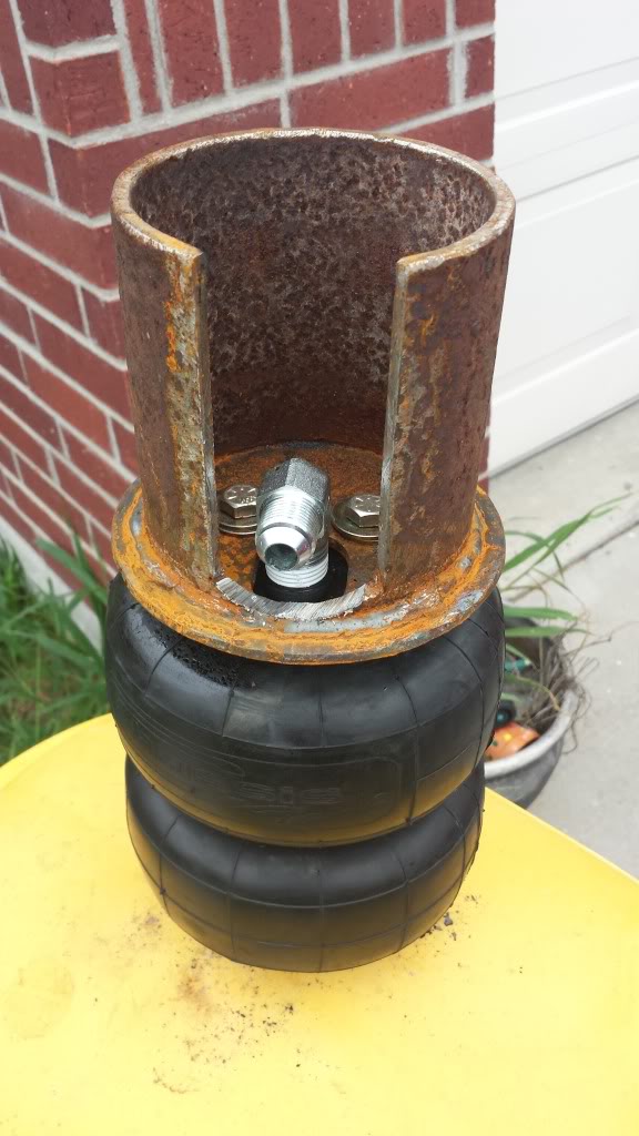

Not much of an update but I was forced to redo the back quicker than I thought. One of the sleeve bags that was used pulled apart so I took it apart and made new cups and used the second set of bags I got as spares back there. Made the cups too tall so now it's high in the back and need to cut them down.

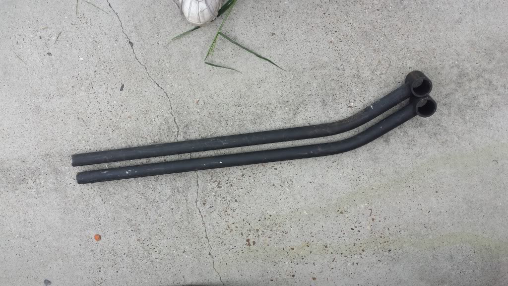

@groundscr8pr I made these up last week. Do you think there would be a problem using them.

Looks like a great modification for the RLCA, nice job. Be cool to see how those will work. Should get better clearance from frame just by using round bar. If they don't, you could always make your own RLCA relocation brackets, if you don't wanna buy them (which I've always thought were ridiculously expensive for that they are) if you needed help, lmk and I can try and get you dimensions from mine. But would be easy to make. Only 3 pieces of Steele welded together and holes for bolts.
Here's a pic of my set-up and can see I have plenty of room. Adjustable LCA with relocation brackets.

Nice! Looks like you be tuckin.....:head3:

@ WHITEOUT I'll be installing them next weekend hopefully so we'll see how that goes. Looks like they should work just fine and give me much more clearance.
@ Sicko Yes sir the front tucks pretty good. Up close it looks like more, my yard slopes down from the driveway so you can't tell.
