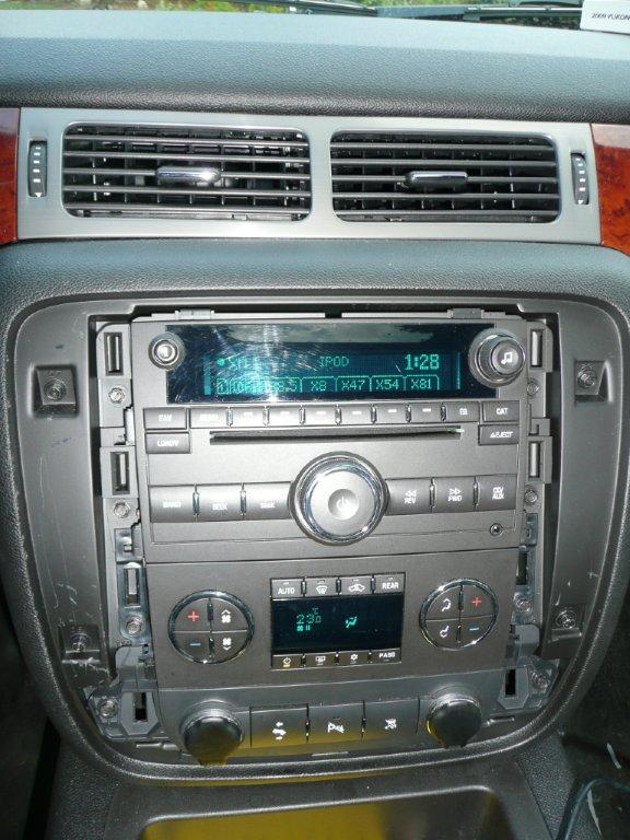

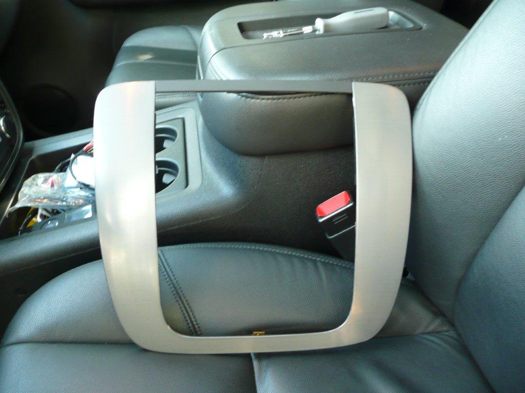

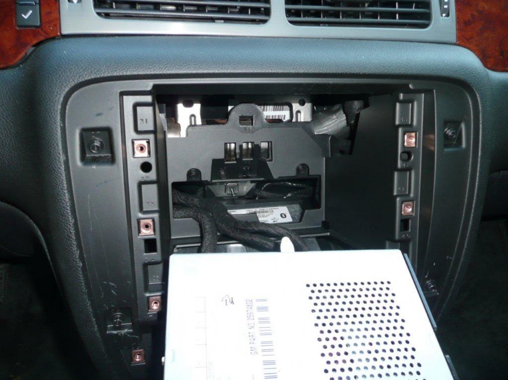

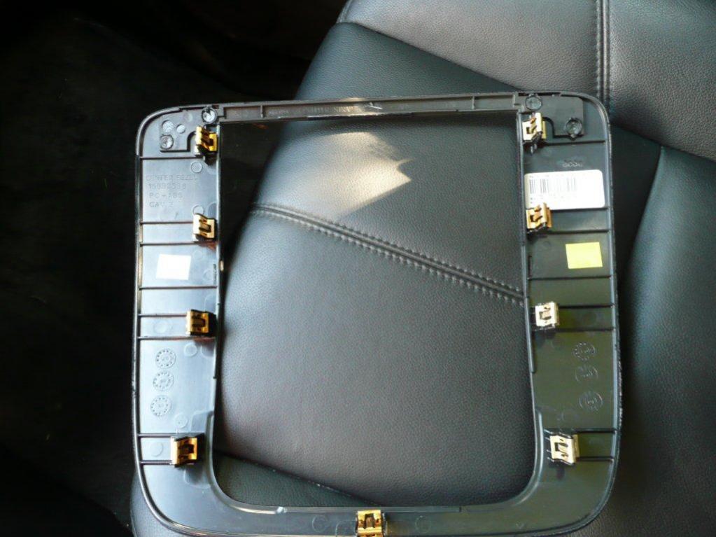

Took a few pictures while taking out the stereo to put in an uPac-GM29 device to add real iPod functionality to my existing factory stereo. I've been looking all over the internet for days and unable to find anything anywhere.
I knew that it had to be easy but I really didn't want to damage my 2 week old SUV .. lolol
Enjoy :)

I had to take off the stereo bezel and take out the stereo to plug in the cables for the uPac directly into the back of the stereo. Getting at the back of the stereo through the glove box is impossible on my 2009 Yukon. I did however fish the wires that go to the actual uPac controller device and mount that in a small space beside the glove box .. also ran the cable for the iPod into the glove box itself.
