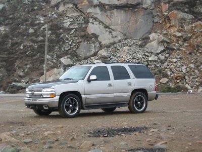

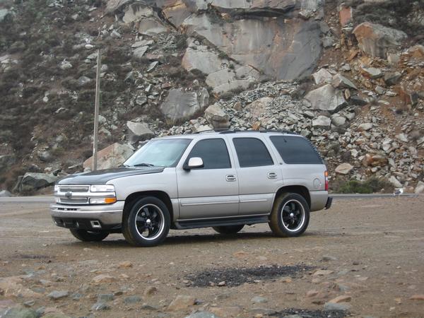

Torson keys and springs it will be under 200, or you can just get the rear springs and turn down the torsons this is what a 2/3 looks like on 20's

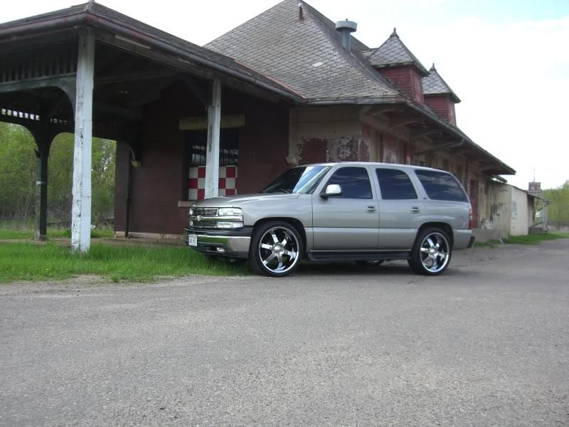

Whatever drop im at right now im loving it..its technically a 3/5, but the front is up a little bit cuz my front end is worn out, and the rear has the "big gay shocks" that max and I discovered..once i switch out the shocks in back i will hopefully be down a little more..I wouldnt mess with the 2/3 cuz you will want to go lower..heres my "3/5" ish on 24s..the front is perfect for me and once the rear comes down a little more ill be happy
