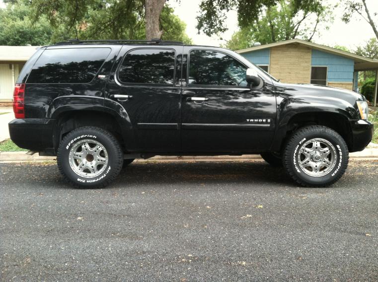

Just had the leveling kit installed yesterday and put on new wheels and tires. Had to do some minor trimming. CCM 2.5/1.5 with 285/65/18 Nitto Trail grapplers. Drives nice, thanks for the advice..

actaully back was 1 inch spacer that was used. Truck looks good like I told you lol

i ended up putting stock spinldes in for him along with a 2.5 inch front ccm kit
in rear used 1 inch spacers from belltech with stock suburban springs
