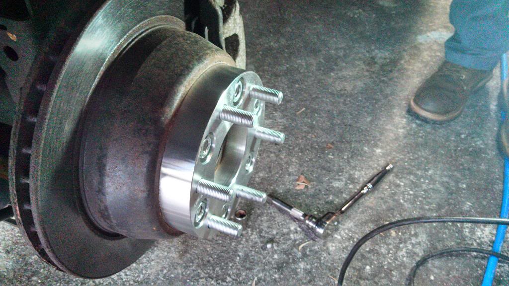

Finally got them on, the spacers at least should have pics, should I figure how to embed them into the post tomorrow.
mmeachem
Apr 12, 2010
1,031
96
Finally done!!!
The Spacer
The Hoe
The Profile
Looks good
