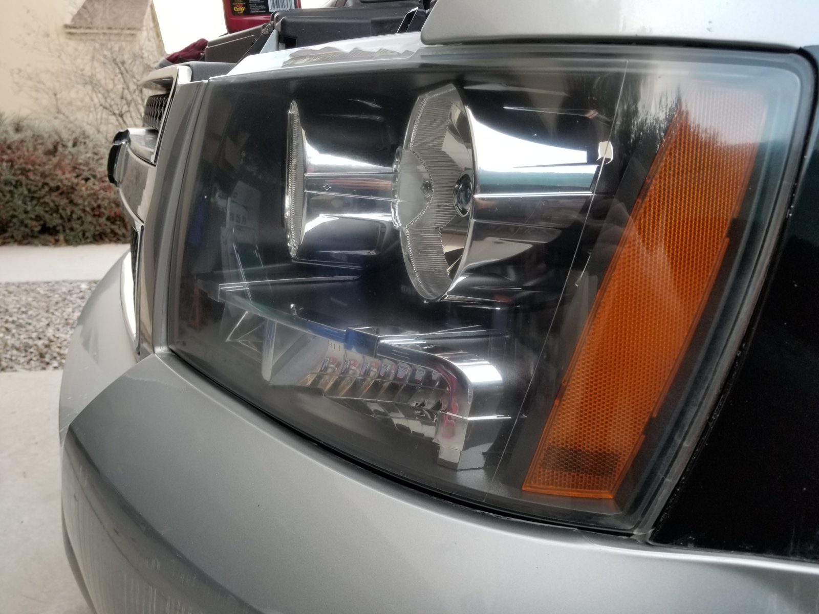

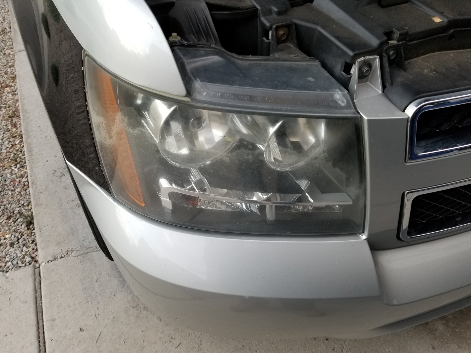

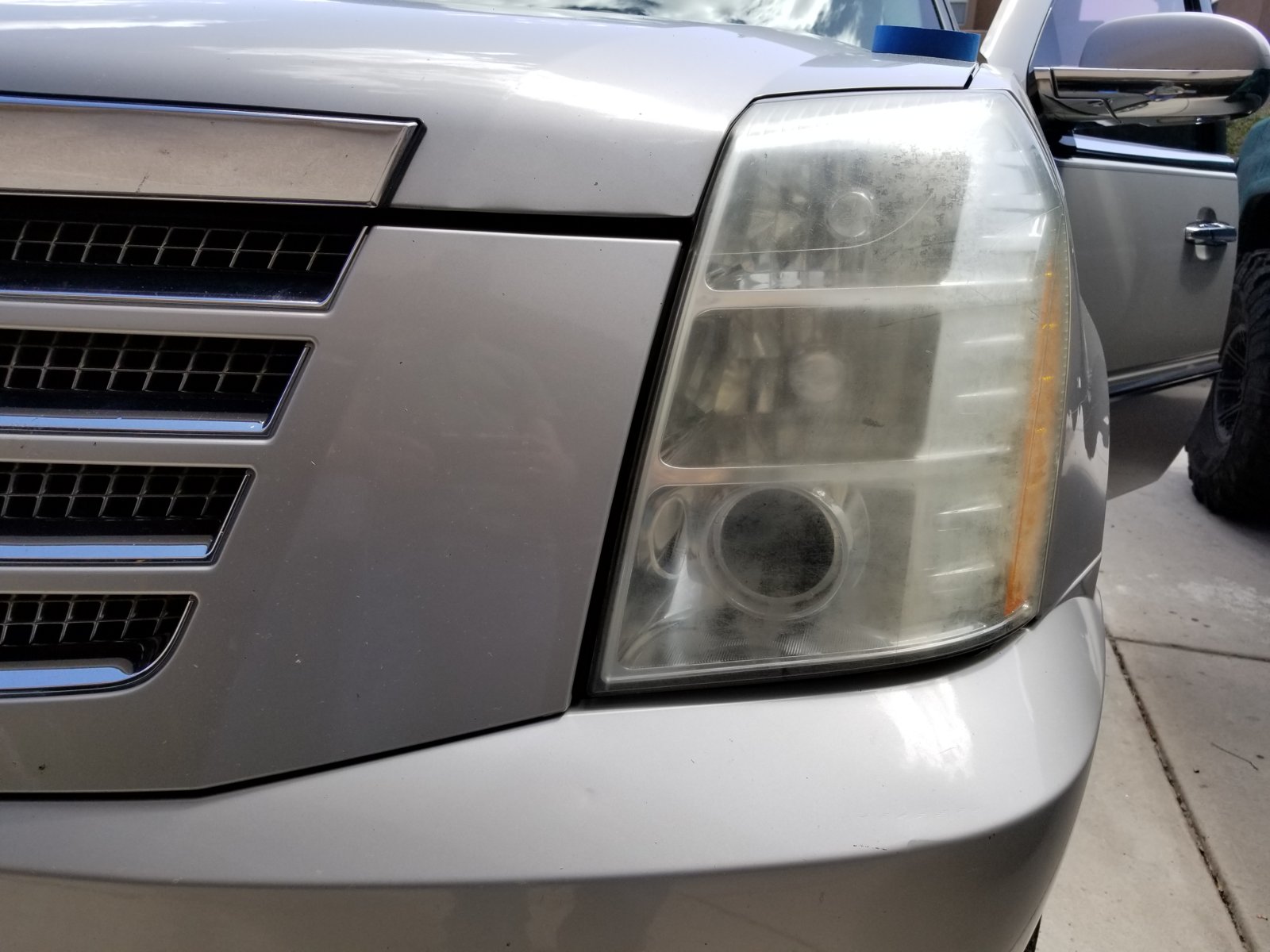

I used to do these all the time. They came out really good.Went and polished up the wife's headlights today. I shouldn't have used the protective coating on such a windy day. It captured little dust particles but still looks a ton better.
Before
After

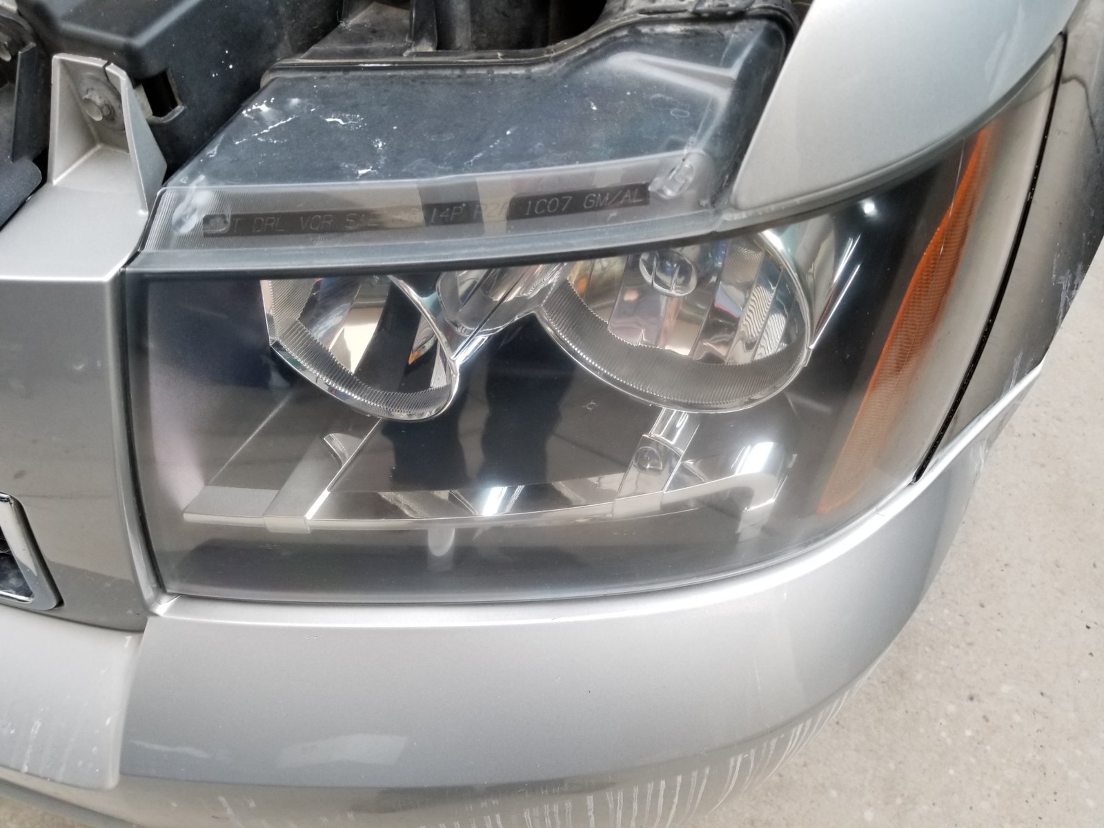

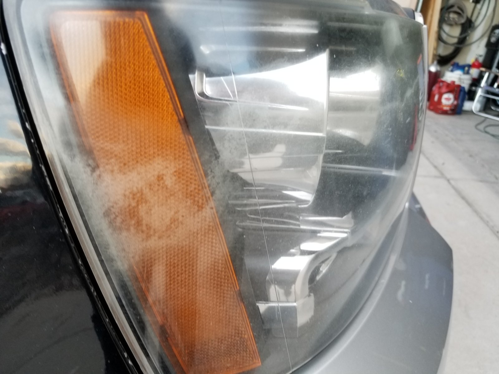

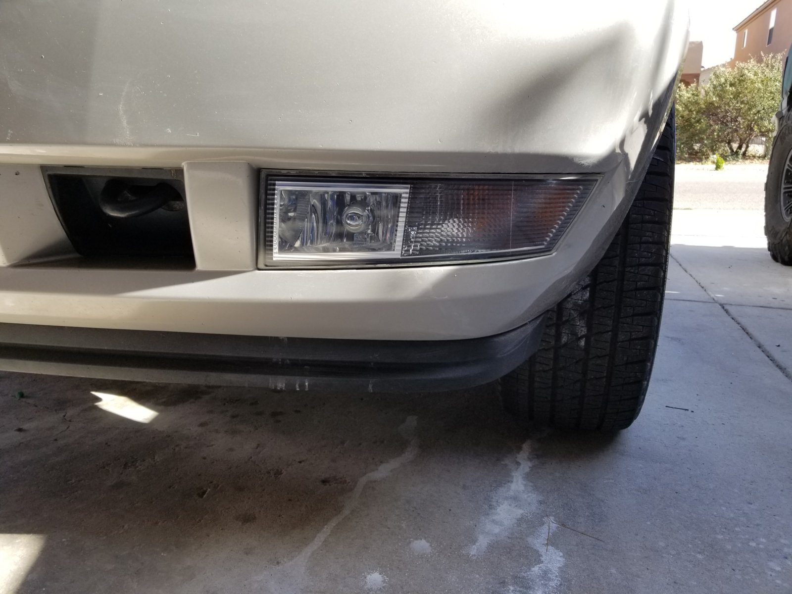

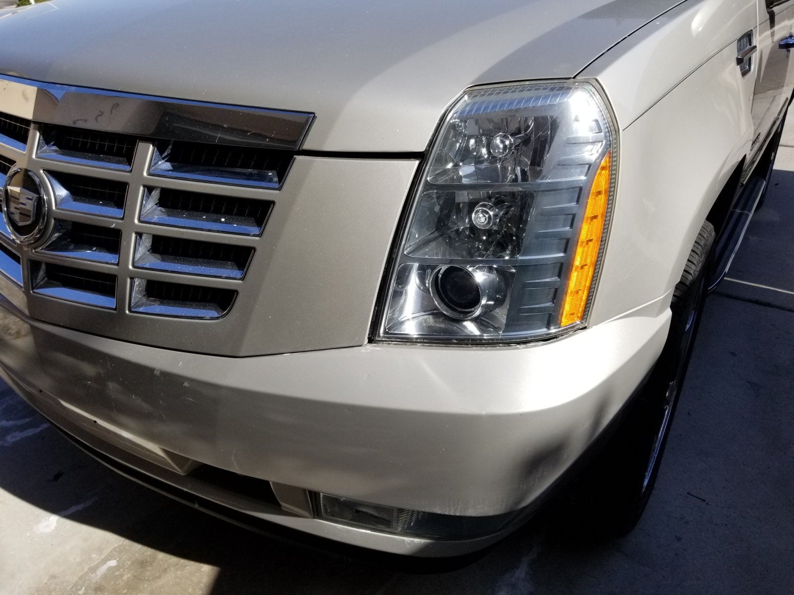

This is how I was taught to do it as a detailer. The cheap “restorer” kits never seem to work, but this does.I tried all of the box kits and they work OK but the yellowing never really goes away or comes back even worse.
I got tired of it and hopefully this will last a lot longer.

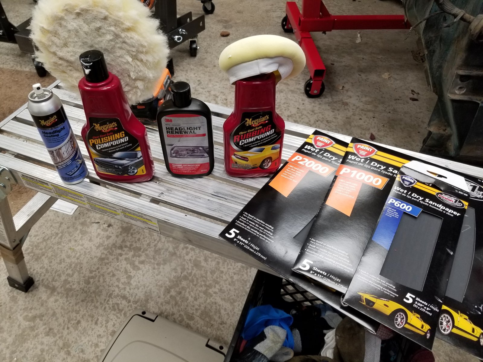

I used in this order:
600 grit wet sandpaper
1000 grit wet sandpaper
2000 grit wet sandpaper
Maguire's rubbing compound with foam pad
3M headlight renewal
Maguire's polishing compound with wool pad
Maguire's headlight coating
Came out like a brand new set of housings.
Before
After

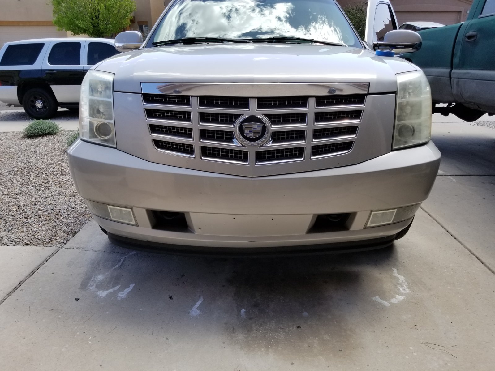

Nice work!! Looks great. As far as I know, the yellowing is just oxidized plastic, and it depends on the climate and weather of where you live, as to how long the new clarity will last. But certainly a clear coat should help.Went and polished up the wife's headlights today. I shouldn't have used the protective coating on such a windy day. It captured little dust particles but still looks a ton better.
Before
After
