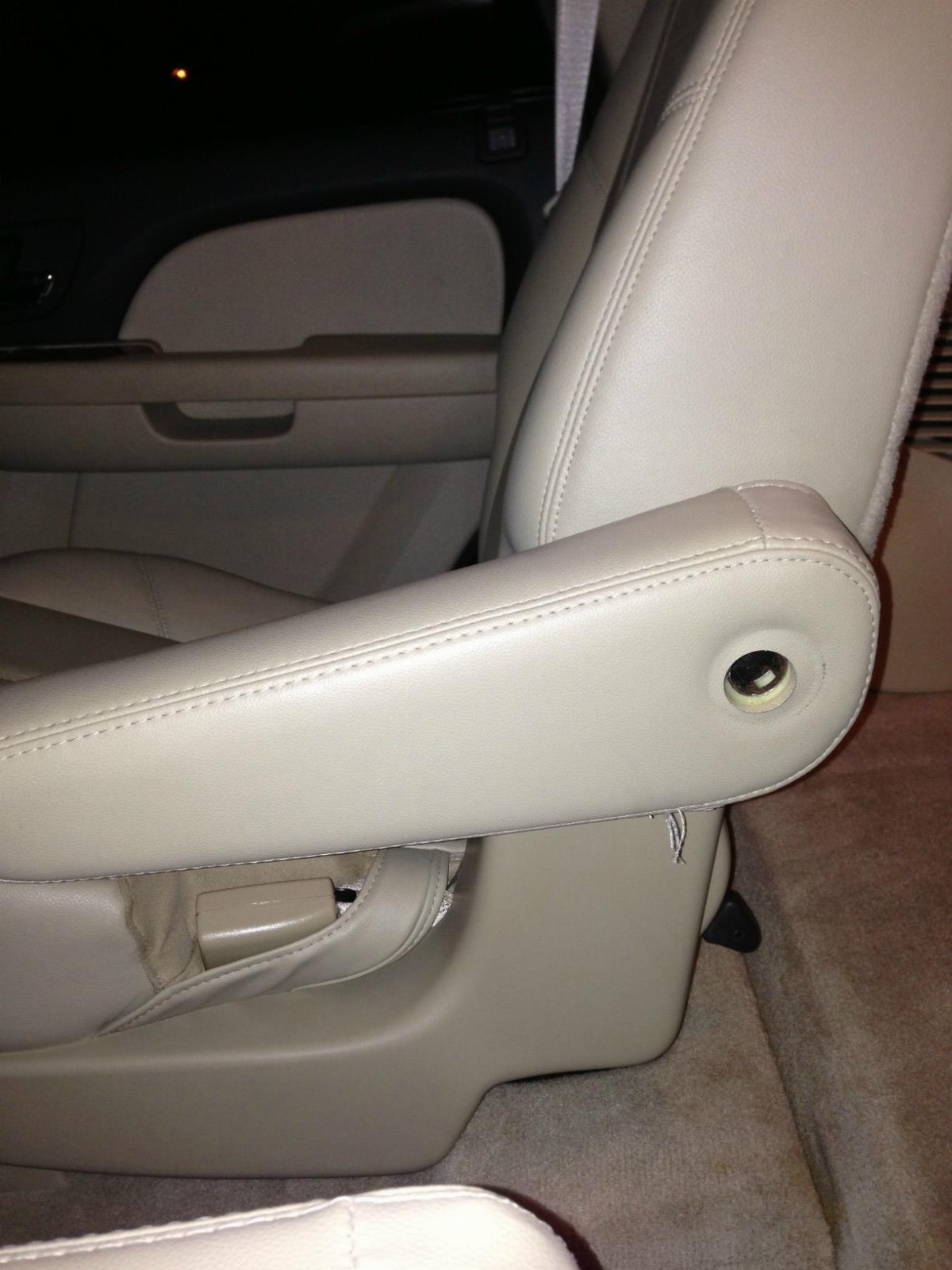

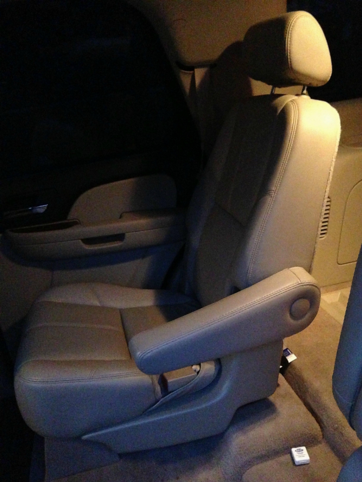

So somehow one of my second row seats got a broken armrest the weekend before last. I think the seat was folded and tumbled forward when the arm was damaged. It's like it hangs a little looser than it should. It goes a little bit out from the chair and hangs lower than it should. Any idea how to fix it? It almost seems like a screw needs to be tightened somewhere that it connects to the seat.
Here's a picture, I'll try to take more if you guys want me to:

That round cap on the armrest pops off and you can take it off from there. I don't remember if its a bolt or nut. I've never taken one off but there might be a stop or something in there that it popped past. Hope this helps.

Mines broken like yours...
p.s. this pic is HUGE.
Anyone have any advice for an '02?

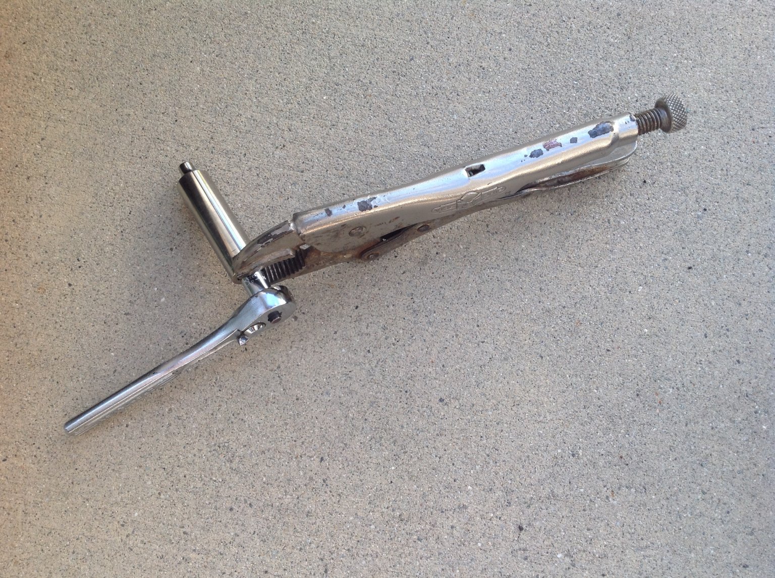

Sorry. I took a few more that are clearer and hopefully not quite as large. It looks like I just need to tighten a nut, but I need to figure out how to get a socket wrench in there. Hopefully I can reach it with an extender.
Also, don't pay attention to the loose stitching on there.

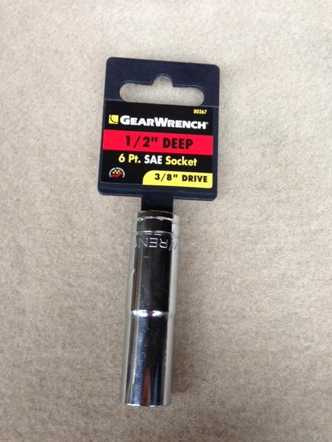

Yeah, sorry for not posting a follow-up earlier. I basically just had to tighten that bolt inside the armrest and that took care of it for the most part. I needed one of these in order to reach it:
At the time I had no idea what size I needed, but the people at Advance were nice enough to let me take sockets out to my truck in order to figure out which one was the right size before I bought it.
