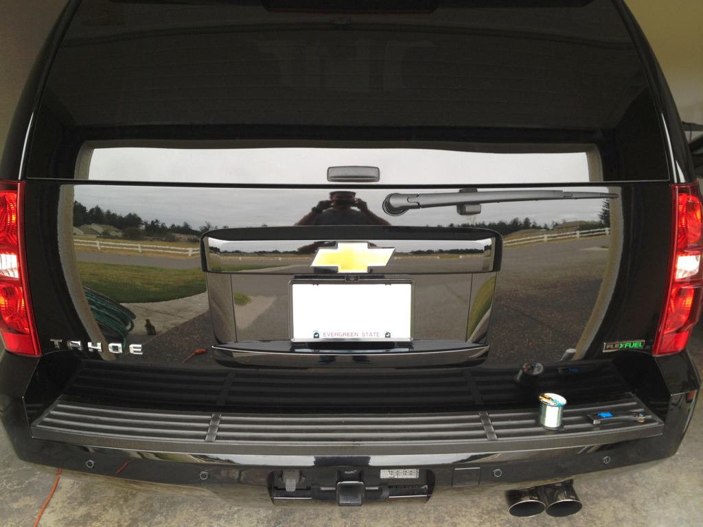

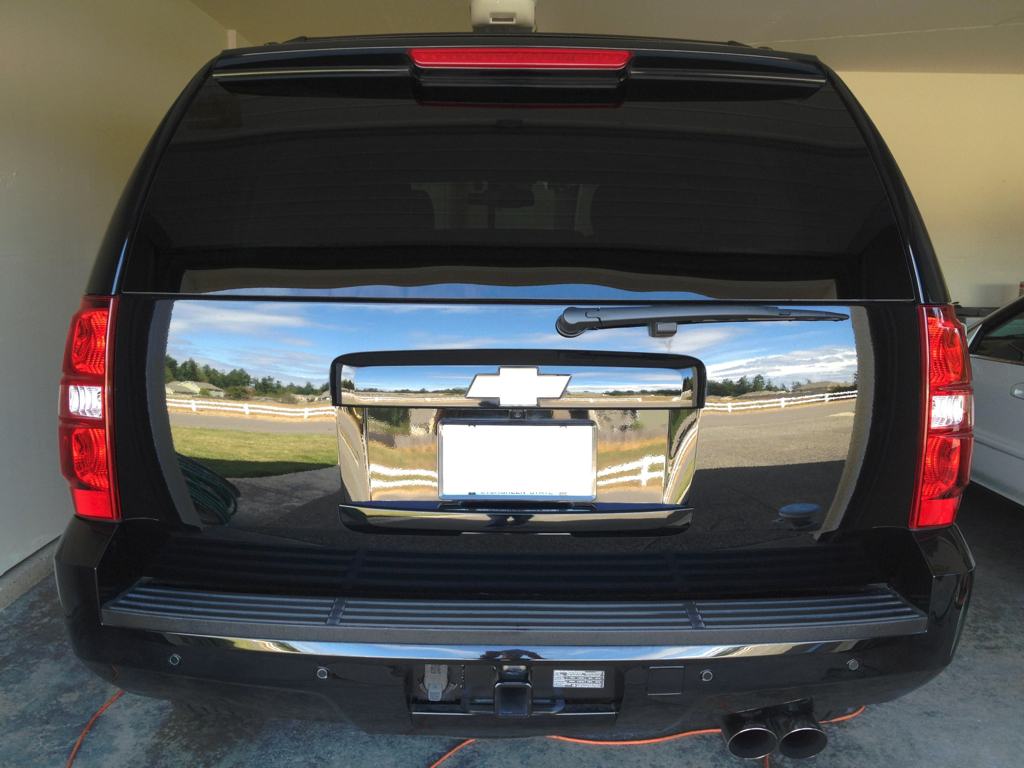

Rear Before Debadge:

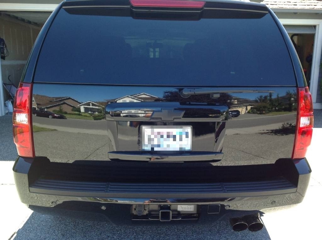

Rear AFTER debadge:

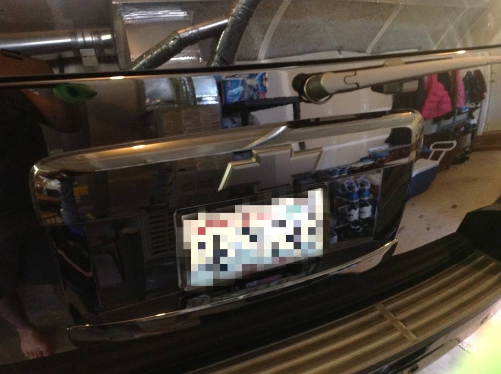

Side before debadge:
Side AFTER debadge:

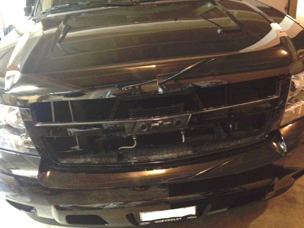

Plastidip on front grille:

Tito teeds, I did 5 to 6 coats on the front grille since I took the time to take it off (it was a PITA!). I wanted to make sure it holds up. 4 coats on the rear bowtie. the key is to leave some space around the emblem when you tape it off and spray the whole area evenly. If you don't lay enough coats down it won't peel away easily.
Practiced on the front bowtie the first time I used PDip. Glad I did, bc I was spraying too far away and too light which creates a texture. NOT what I was going for. No biggie, just peeled it off and resprayed it. Dialed in my range (held the can approx 5 inches from surface) and layed it on thicker which dries pretty smooth IMO.

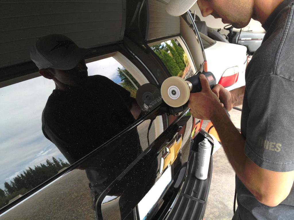

Removing adhesive left behind after the liftgate window handle thingie's been taken out.
felixgun
Oct 7, 2010
9,746
136
Lafayette, LA
Great job Jarin. Your truck looks :boobs: with those TBSS 22's!!
---------- Post added at 07:47 PM ---------- Previous post was at 07:46 PM ----------
Looks good!! What is being done in that last pic?
3M Eraser wheel doin it's thang
