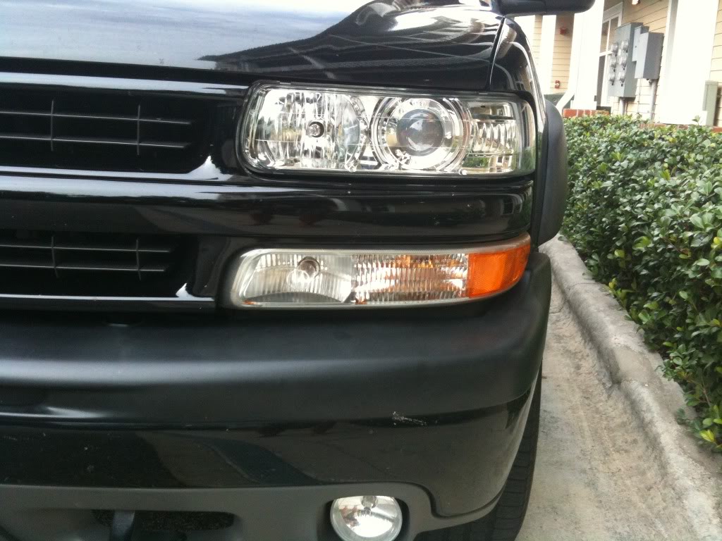

Don't get those. The build quality is not that great. I just got a pair of these (link below) off ebay and installed 35w 9006 HID in them. Fantastic output. I am very picky about lights. I had planned to retrofit a real xenon projector, because I thought these were going to be crap. But the output is 85% as good as the Valeo projector I was going to put in there. The only thing was the bracket is not as strong as the one on the factory lights, so these wiggle over bumps. To fix it, I just stuck something behind the bracket and it solved it instantly.

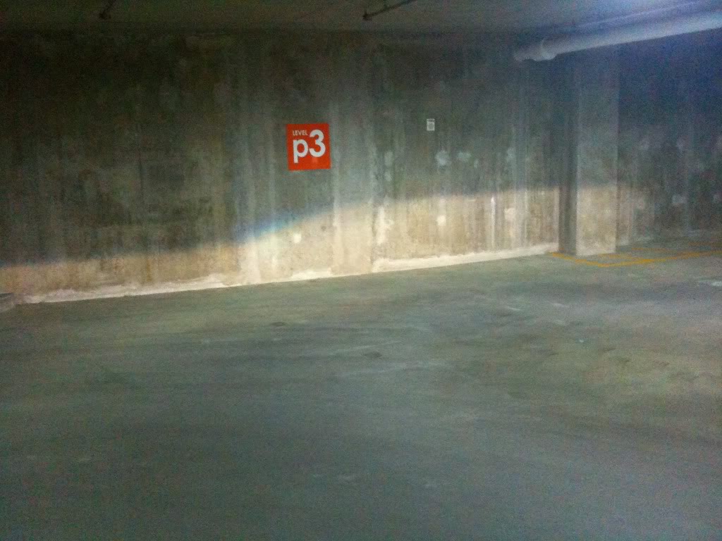

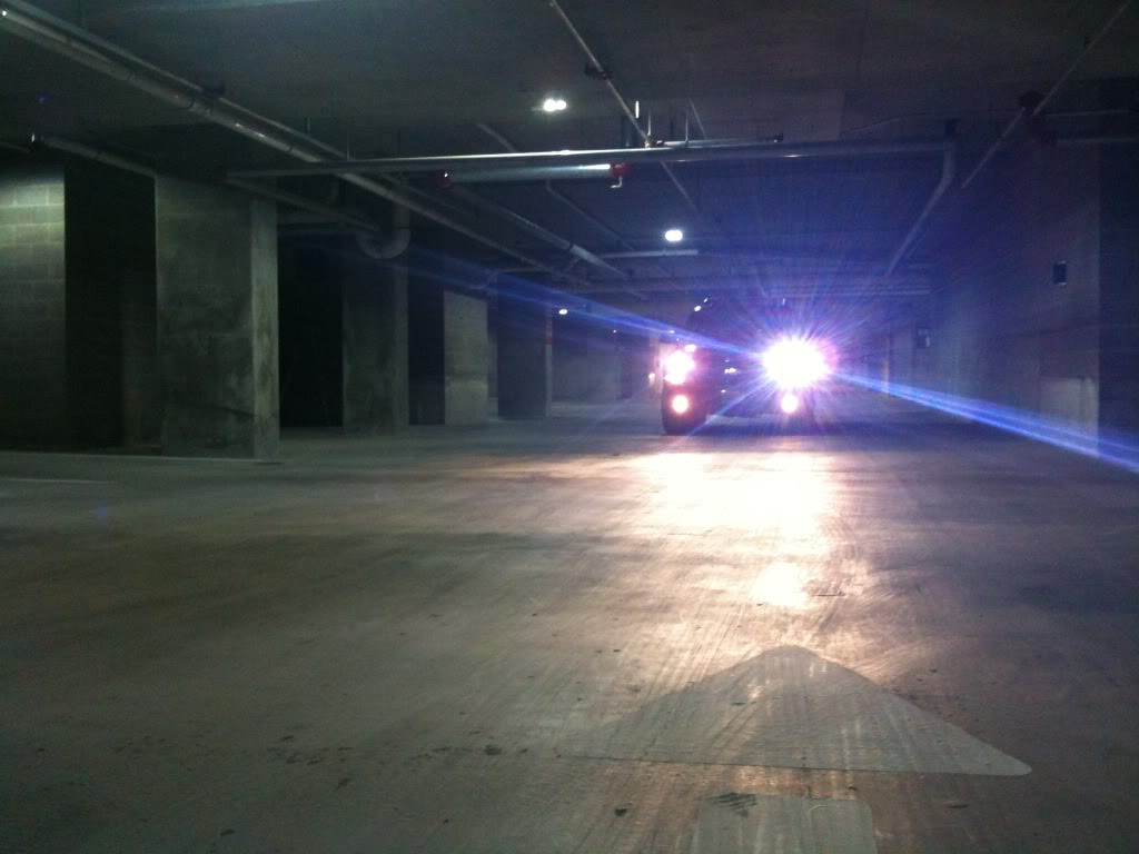

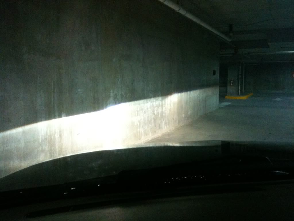

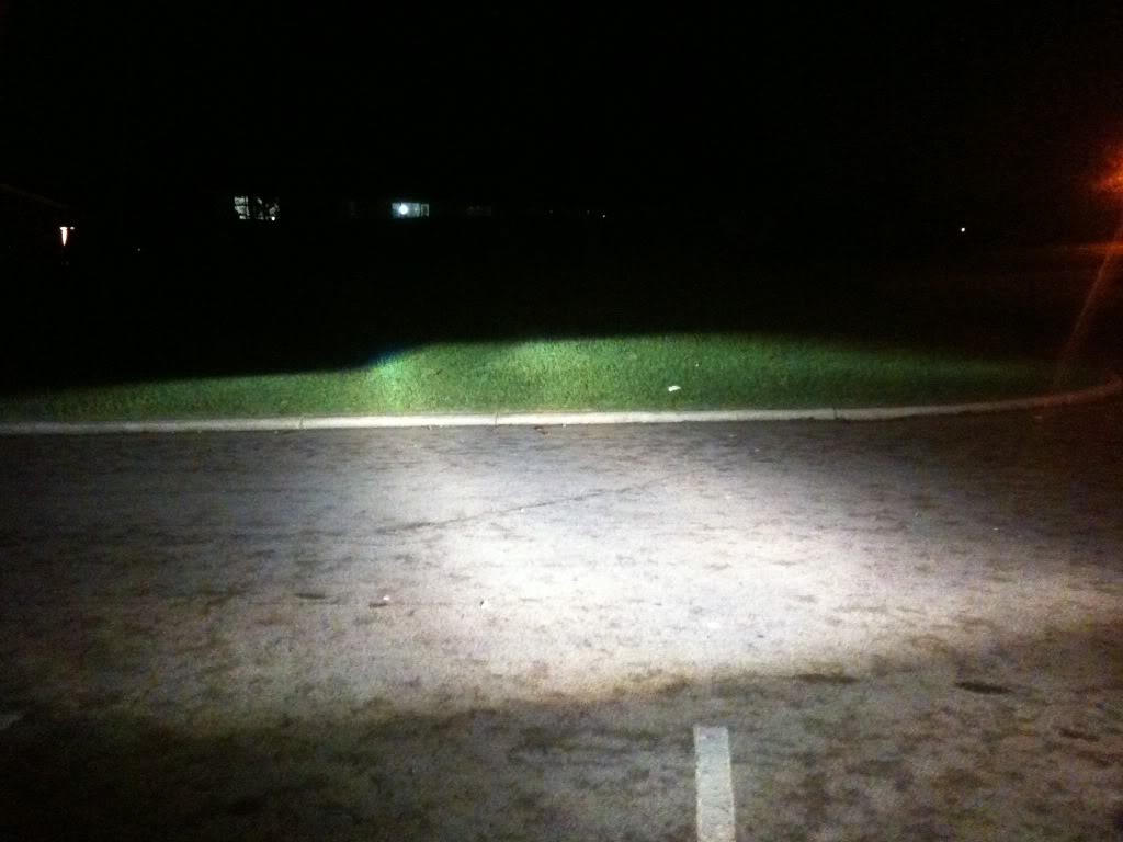

Looks good. I'm a picky light guy, too, and that's a decent cutoff. I was thinking about a custom retrofit, but that looks pretty good to me. One thing I don't like about the stock projectors in my Denali is that it is TOO focused. There's just two white spots. It needs a little bit of lateral spread to the light, not just one super bat-signal beam. How does the output look in the dark? (in your opinion as the driver, can you see the sides of the road, or just what the lights are pointing right at?)

I know what you're talking about. I had the HID kit in the Denali projectors for a while. Much better than stock, but not great overall. These DEPO projectors seem to be pretty wide. When they were used with halogen, it was like you said, only lit up right in front of you. With HID, the light is much wider. It is not as wide as an OEM xenon beam, but for a retrofit, it's pretty good.
In my Denali, I put bi-xenon projectors in. It was a lot of work, but they work great and throw out a lot of light. It was just too much work to these DEPO's to do that seeing as they are already pretty good.
