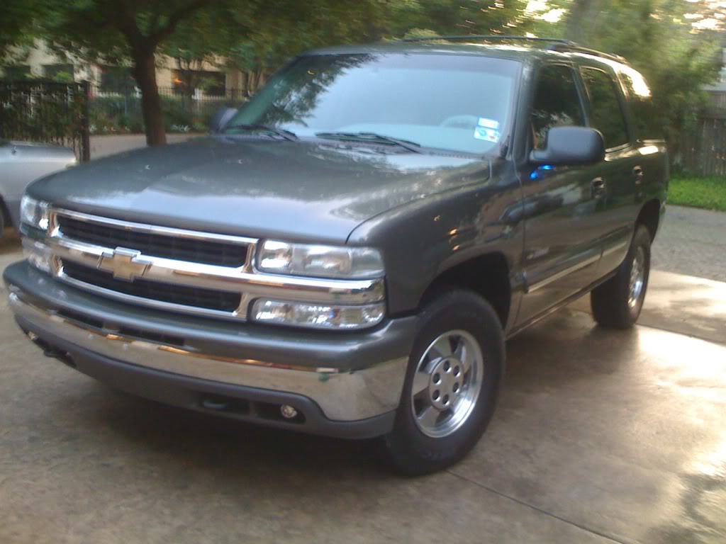

she's one of the first NBS tahoes to roll out the factory. 2000 with a 5.3 and 2wd. when i got her in 2008, it was my mom's old vehicle since she bought it in july 2000. here's a picture of me and the parents WAYY back in the day.
well my mom put 118k loving miles on it and when i graduated high school, she bought a 2008 tahoe and i got her's as my college vehicle.

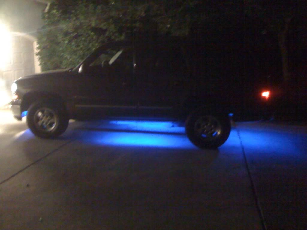

Started out with small mods, clear corners, lame blue lights that are no longer there, some debadging and a new rear badge i thought was pretty nifty.

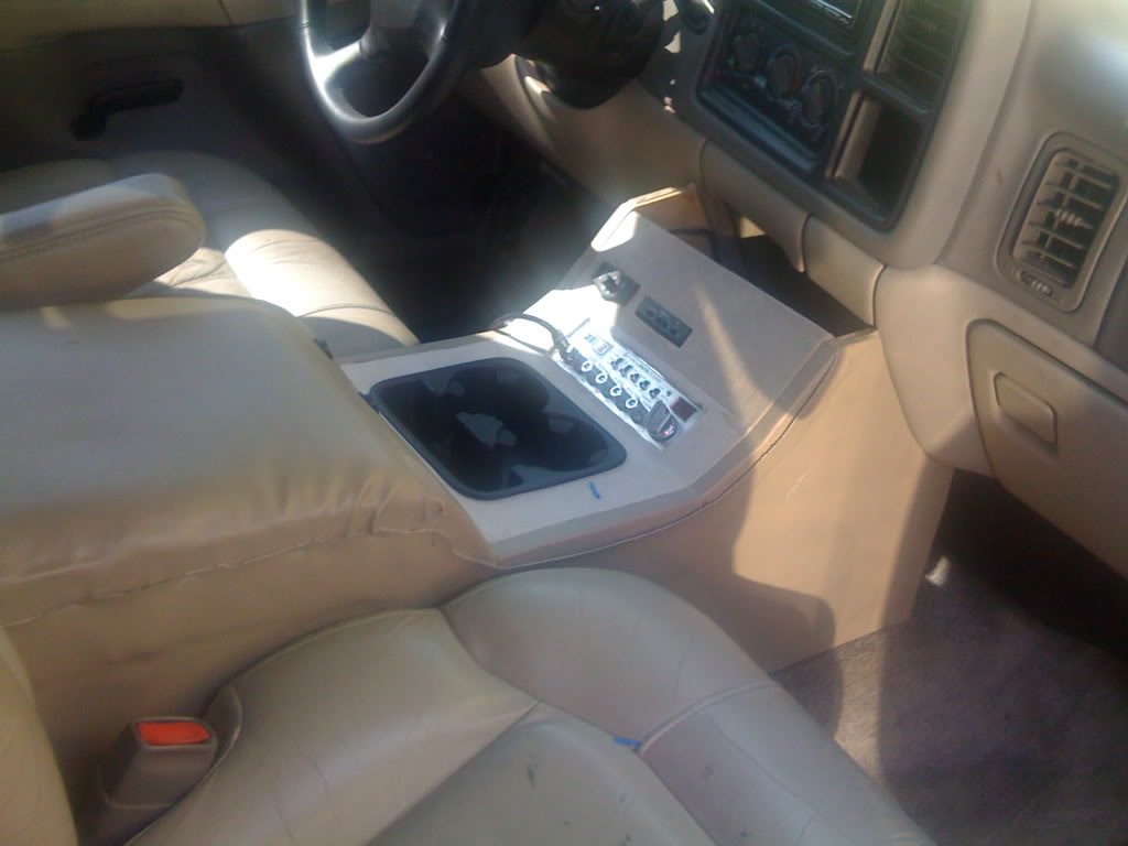

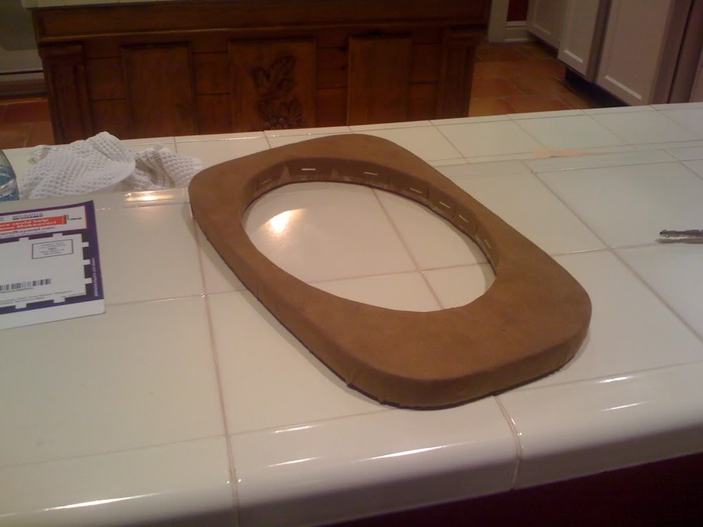

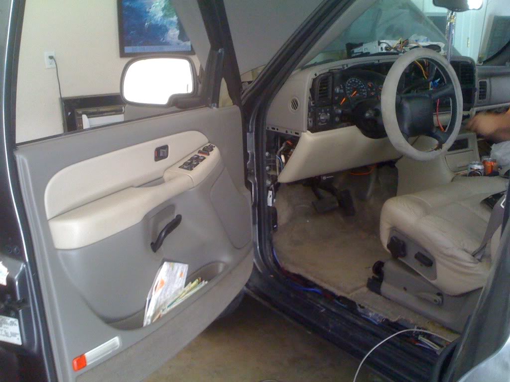

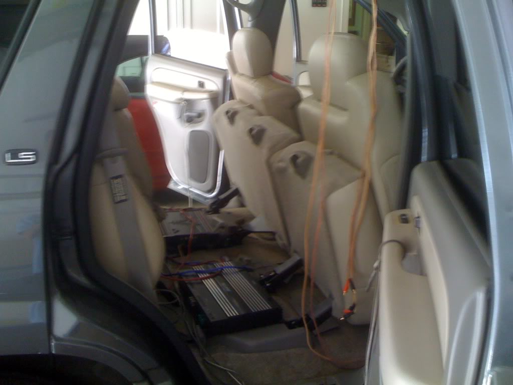

custom built center console with CB radio

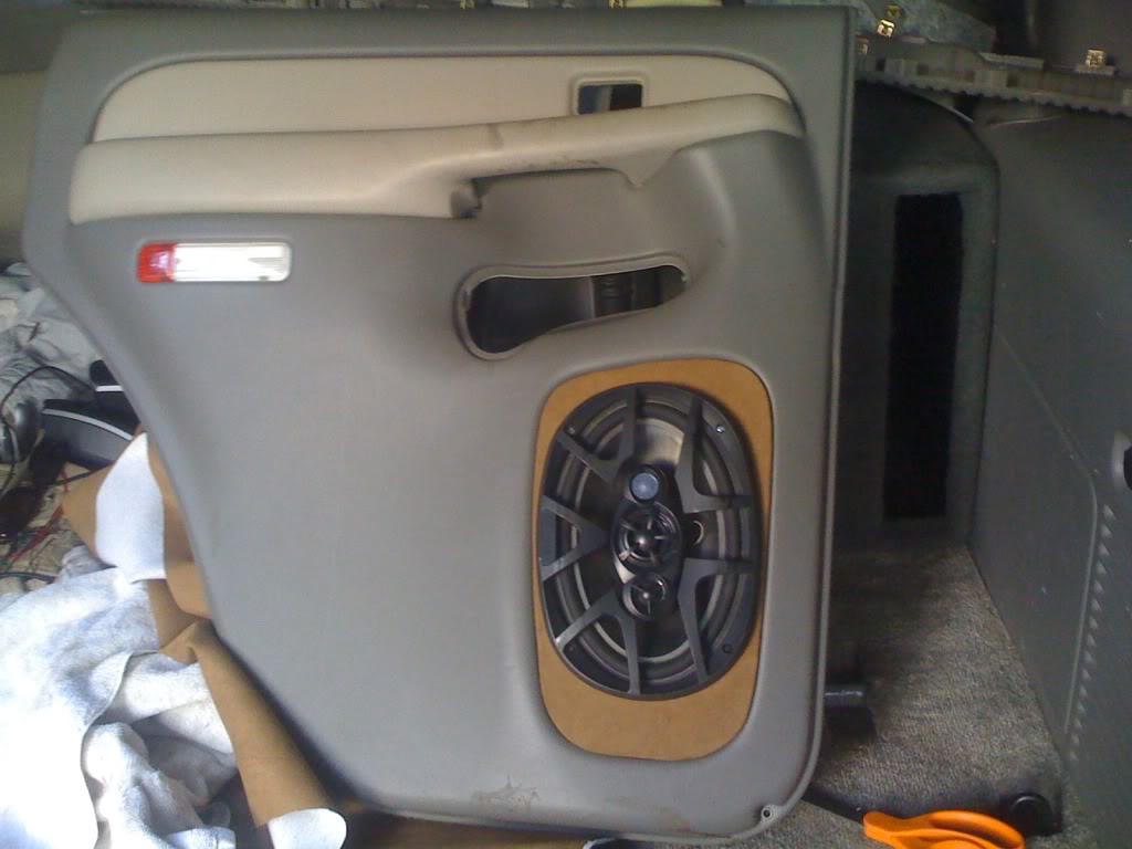

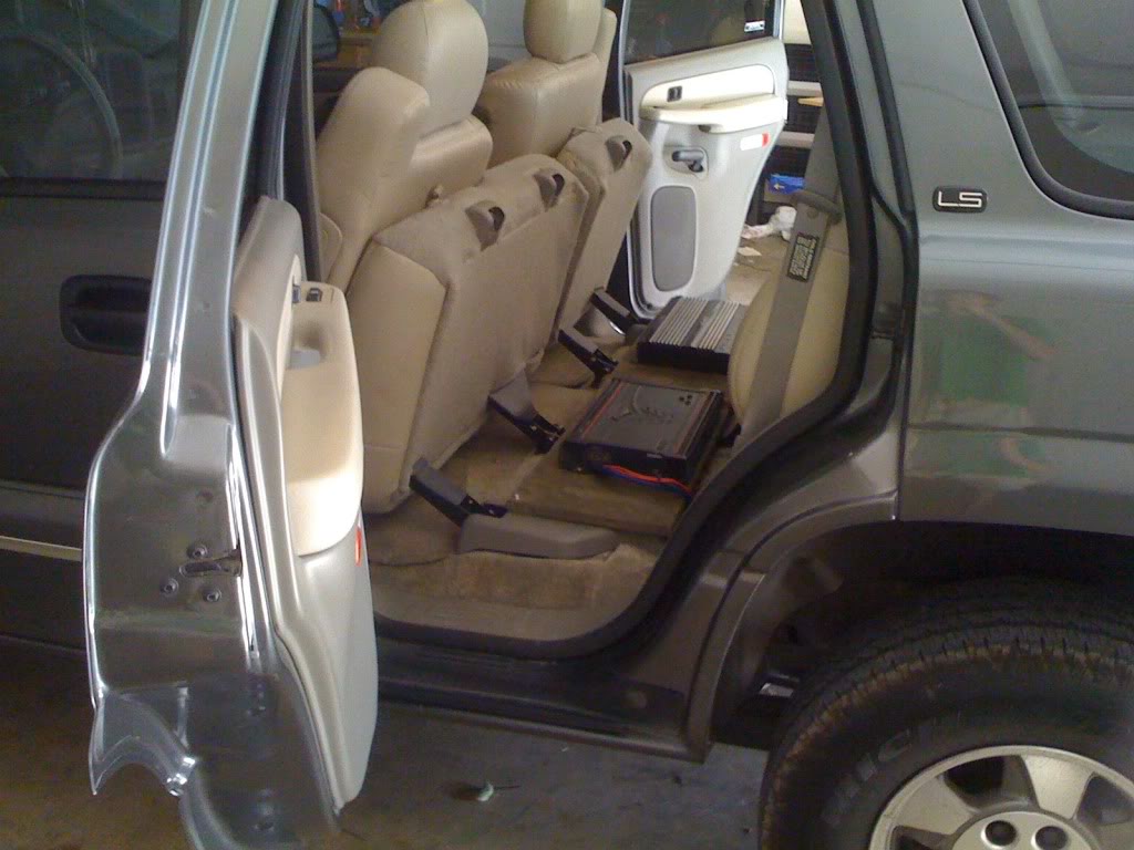

old system going in

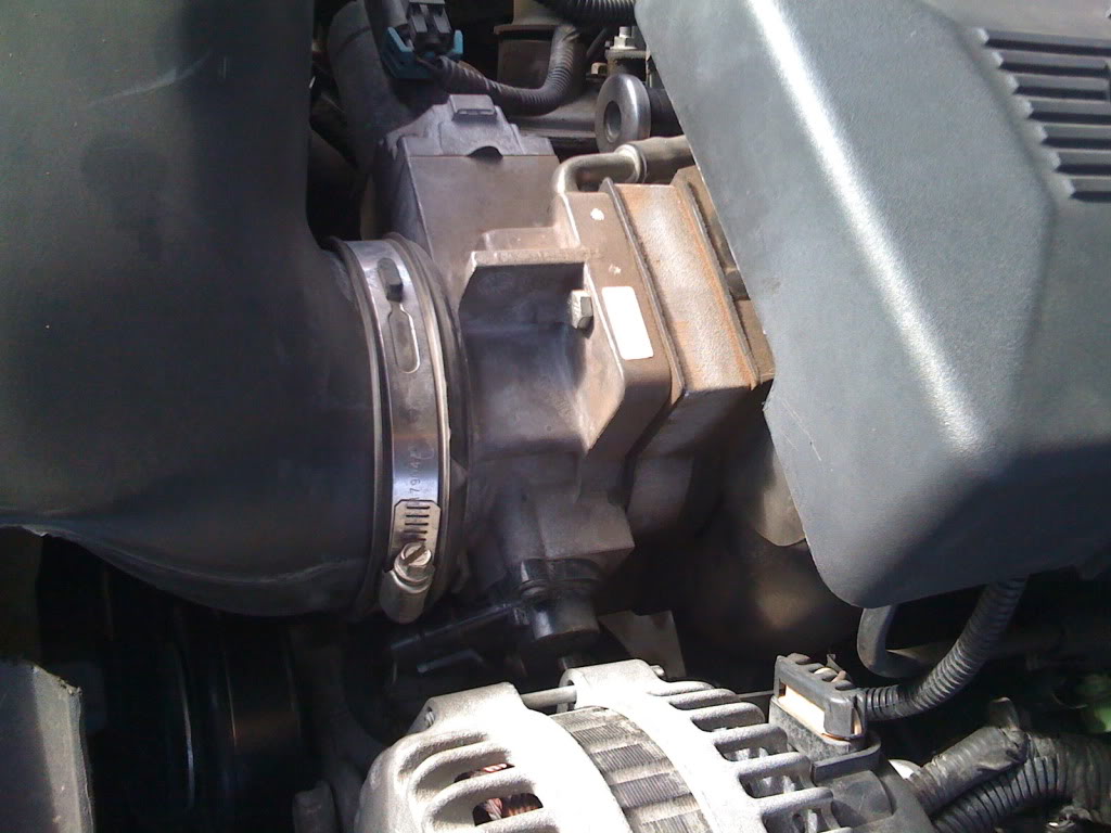

throttle body spacer LOL

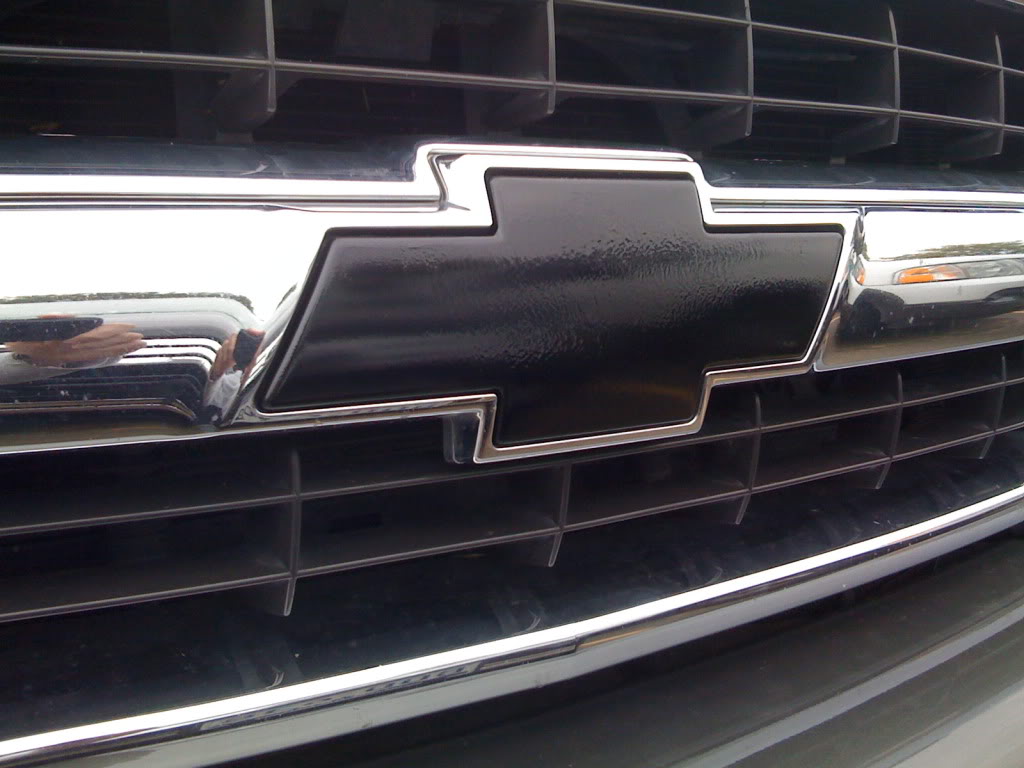

black chevy emblem

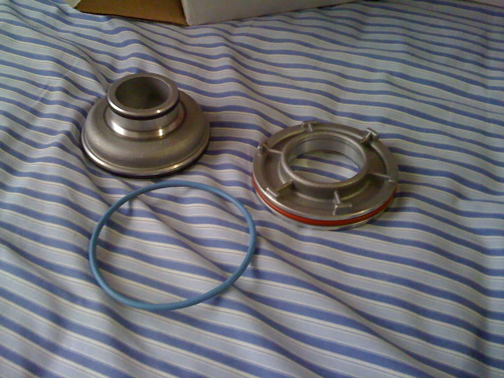

vette servo

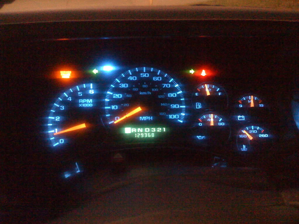

blue led gauges and green led turn signal, cruise control, and blue led brights indicator.

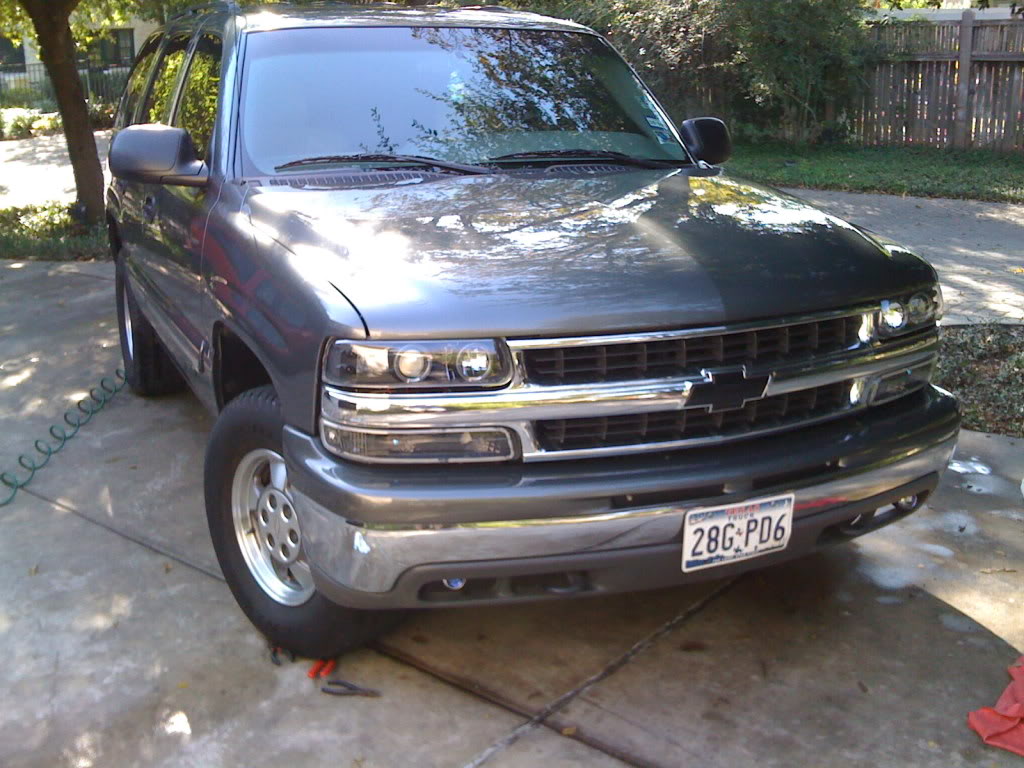

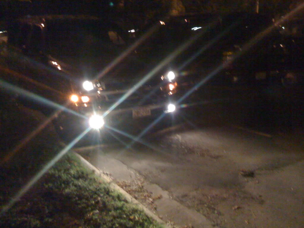

some projector headlights

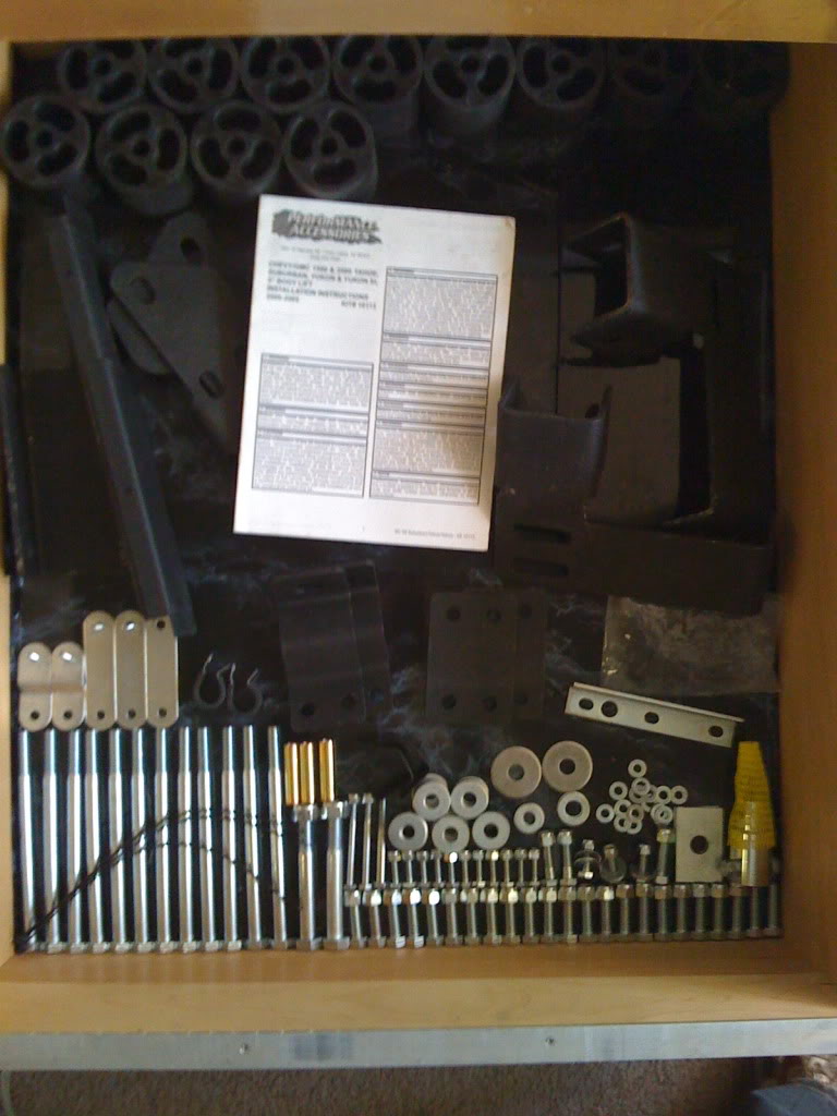

body lift awaiting install
body lift and stock tires

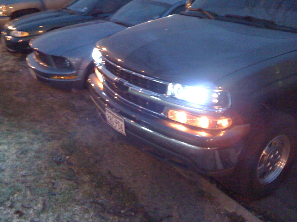

8000k hid's in the projectors

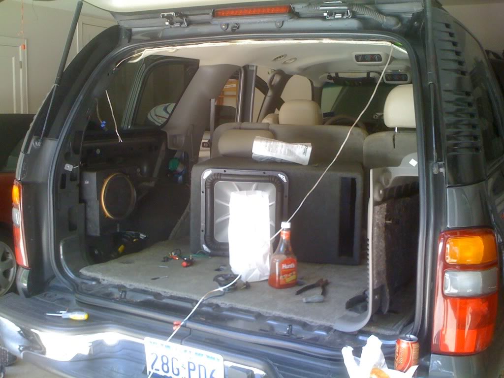

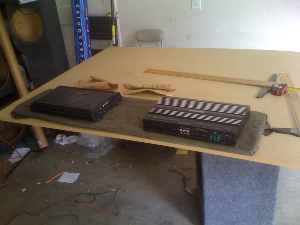

rd1750.1
18" rd alpha v3 in 6.5ft^3 @ 35Hz

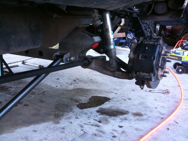

got some new moog ball joints and went to town
and eventually upgraded to some 325 60 20 terra graps and leveled the front out a bit

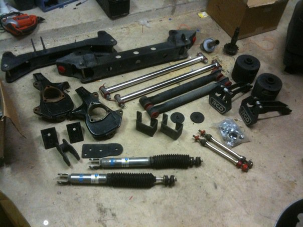

6" RCD lift
3" PA Body Lift
Ford torsion keys
bilstein 5100 up front
procomp basic shocks in rear

projector light output sucks. gonna put stocks back in with normal lights.

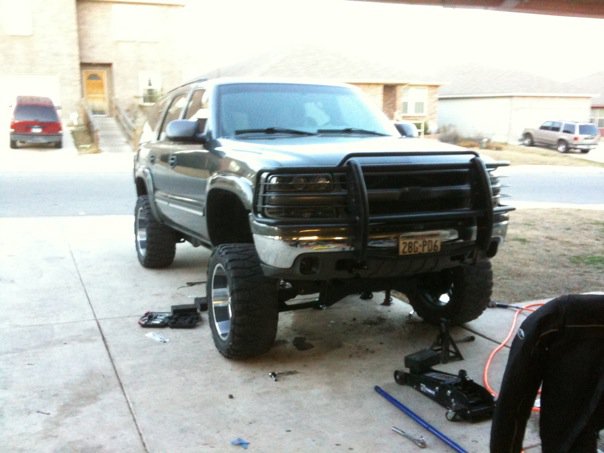

need to remove fender flares and re-install with 3m stick tape. they vibrate and are rubbing off paint under neath because i was in a hurry and ended up not even installing the 3m double side foam tape.
steering alignment is terrible. needs new pitman, idler, inner and outer tie rods and re-alignment. might look into a steering stabilizer as well to button it up if needed as well as a cognito idler brace. heim steering MAYBE as well but probably not.

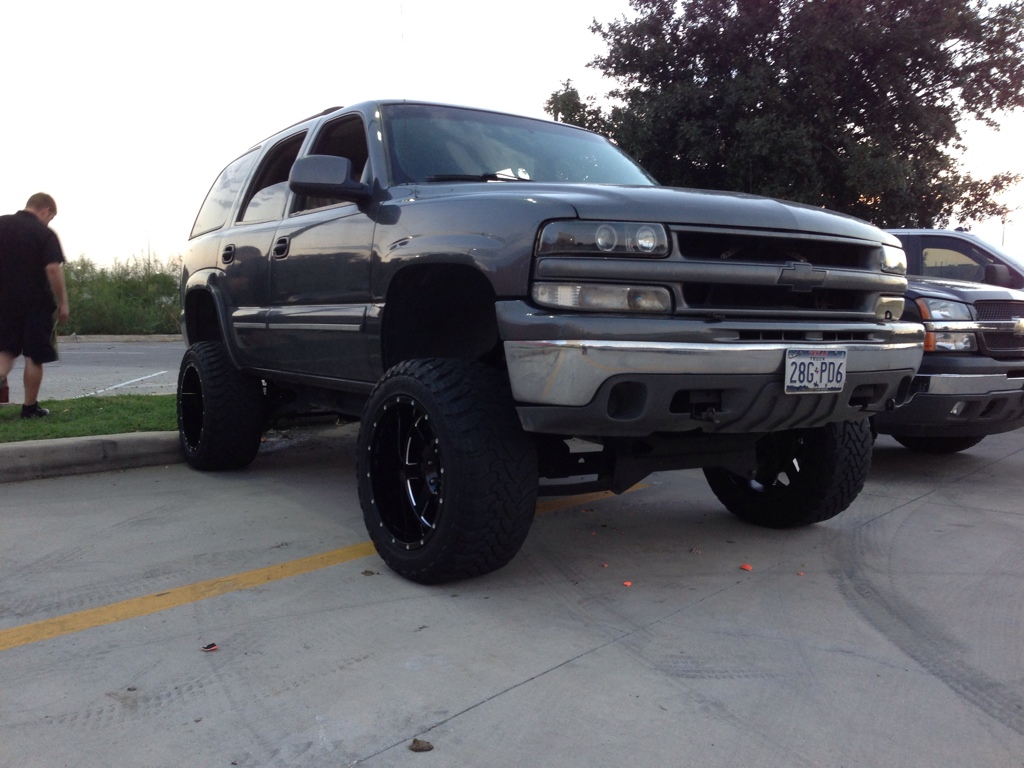

Texas
well the new wheels and tire are on. exactly as i posted before, 20x12 moto metal 962s in black and 33 12.50 20 toyo mud terrains. setup is not for everyone. but i am loving the gained power going from 36's to 33's. factory 3.73 FTL but it could be worse
near future plans include all new moog steering/suspension parts, body lift removal, new headlights/corner lights, and some black powder to replace chrome.
