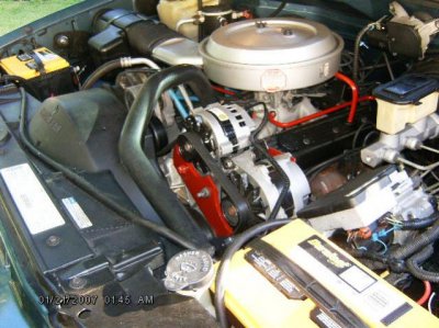

you will have to make the bracket for the dual alt like i did.
i bought a slab of steel and took it to a body shop to cut the
curves out. it wasn't hard to do

I would like to find a kit. If I make my own bracket finding a belt will be hit or miss.

all you have to do is once you get the sec alt bolted on get a
rope or string and go around all the pulleys and you will have
a good length on what belt you need take it to auto parts place
they will find the belt you need .
you will need another person to hold the tension pulley where it's
suppose to be before measuring.

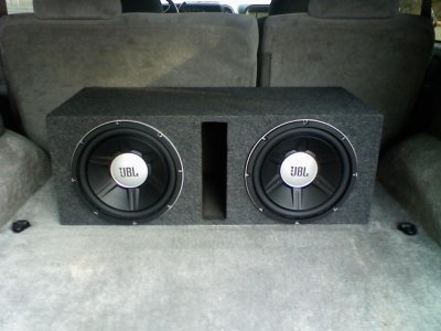

No I get what you're saying I just didn't get the post before that.. the guy with the two JBLs....

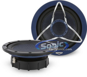

Kicker SSMB, came out in 04
I haven't heard too much good stuff about those kickers. Even though the woofer looks SIMILAR the MCC6's should destroy the kickers. The memphis components are pretty unique if you ever look at them up close. You can see light through the cone yet they're air tight. It's crazy.

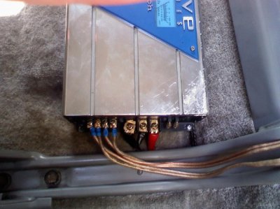

is that board for the amps just sitting on the seat bracket's. Any side pictures of how the board is on there? thanks
---------- Post added at 12:19 AM ---------- Previous post was at 12:16 AM ----------
Just comparing. I love car audio that's why.
