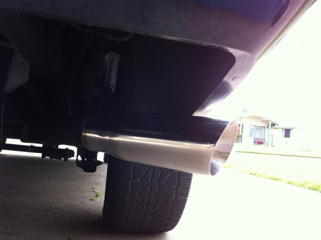

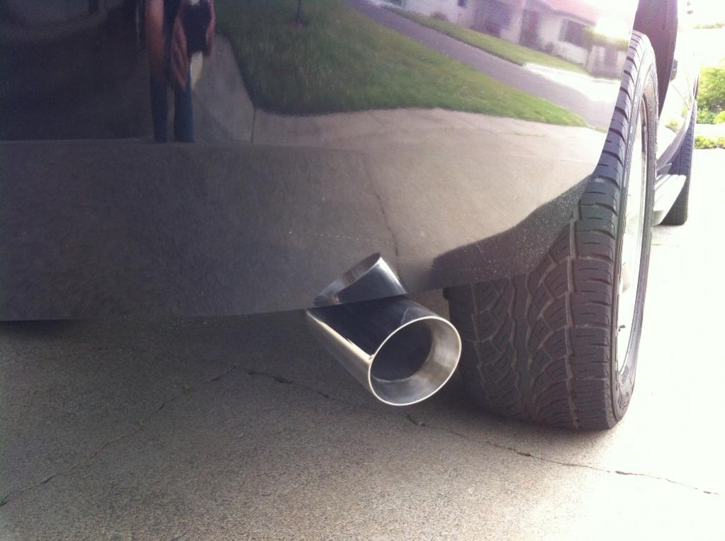

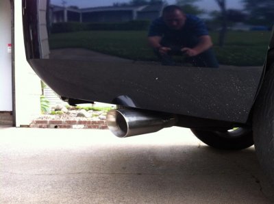

Problem solved
The Dual Chrome Tip created the whistle sound under heavy load, when the exhaust was serioulsy putting some pressure through there.
Cut the dual tip off and hit her hard, .............. SOUND GONE!
So I put the same straight chrome tip on her as I already have on my NBS Yukon, does not look bad I think?

I'm a little worried about the creepy guy taking pictures of your burb. :(
JochenWoern
JochenWoern
Sep 29, 2011
2,427
21
Sacramento, CA
Nah ...the dude in my avatar would never take pics of his truck with widerlich mud on his bumper. :)
The guy in the pics does not do that either, no taking pics of HIS truck with SCHMUTZ on it.
But since the truck is not his and belongs to the Mrs., IT'S ALL GOOD.
