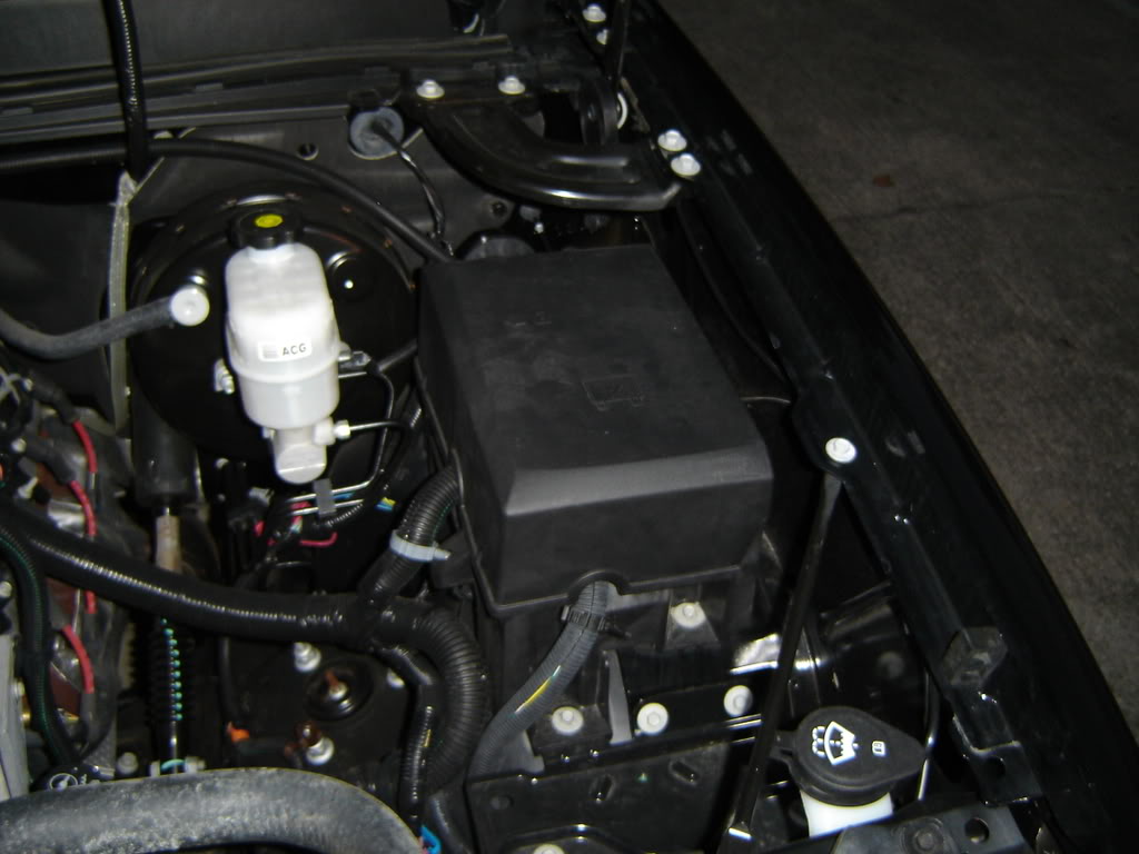

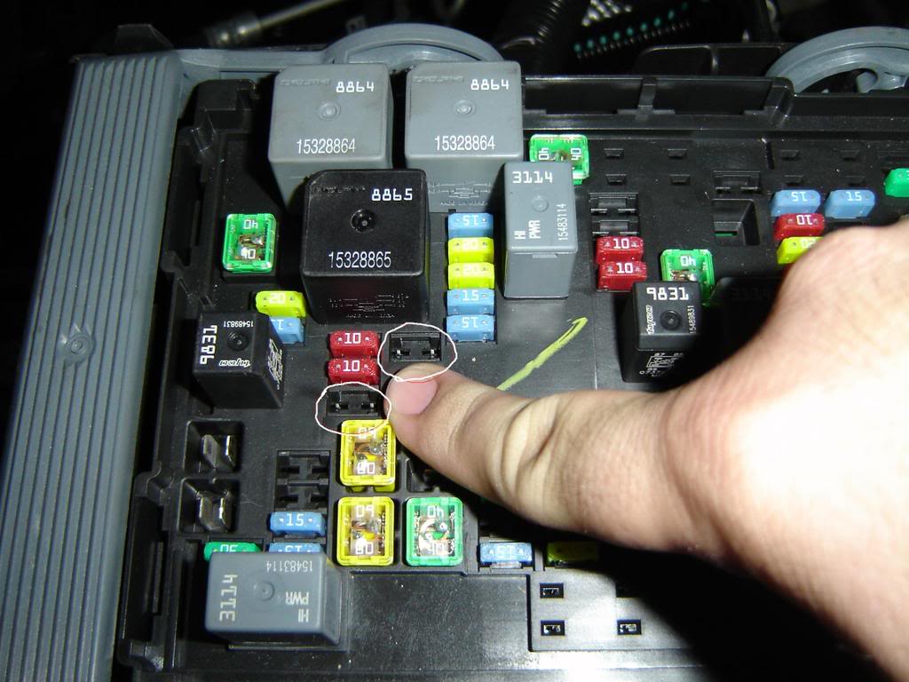

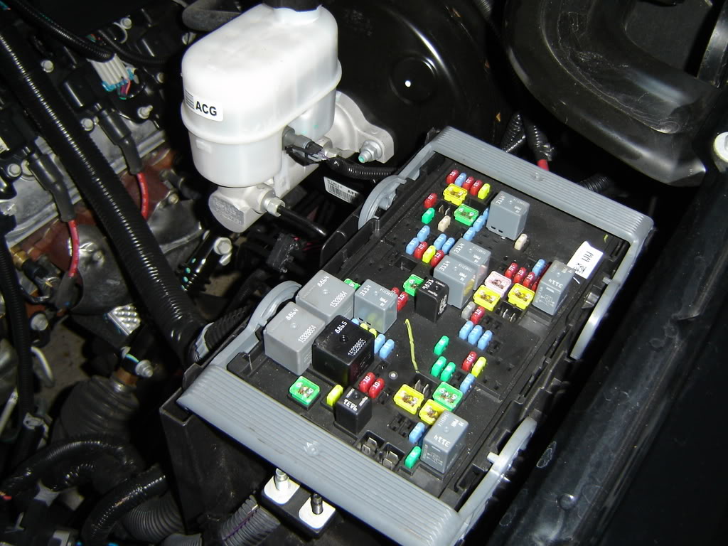

I pulled a fuse......no DRLs or discussion of them with BFC
pretty sure this is how you do it... (Correct me if I'm wrong though)
Here's how to disable the Daytime Running Lights on a NNBS 07-up
the automatic headlights will still work.
Pop the hood. (make sure the truck is off).
Go to your under the hood fuse center.
Remove the cover.
Remove these 2 fuses.
Done.
