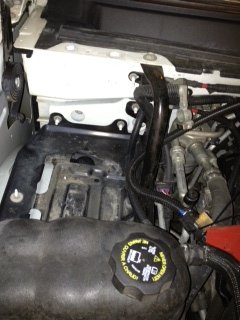

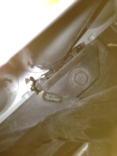

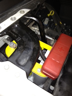

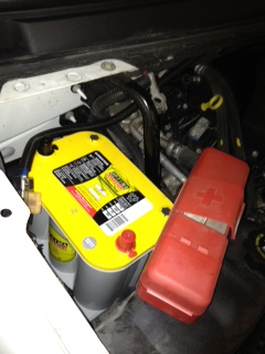

Here's how to install an Optima Yellow Top D35 Battery into a 2007 Yukon Denali. See photos, too.
1. Remove curved brace above battery.
2. Remove battery cables.
3. Remove bolted battery brace at bottom of driver's side of battery.
4. Remove battery.

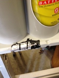

5. Place Dynamat or similar material on Optoma battery at the 3 holding points to keep it from sliding around. The Optima D35 is a little too small for the braces.
6. Place Optima in position.
7. Bolt battery brace back in place.
8. Connect battery cables.
9. Reinstall curved brace above battery.
I had searched the forums and found mixed reviews about using an Optima on these vehicles. Wasn't hard at all, so figured I should post this. Good luck.
